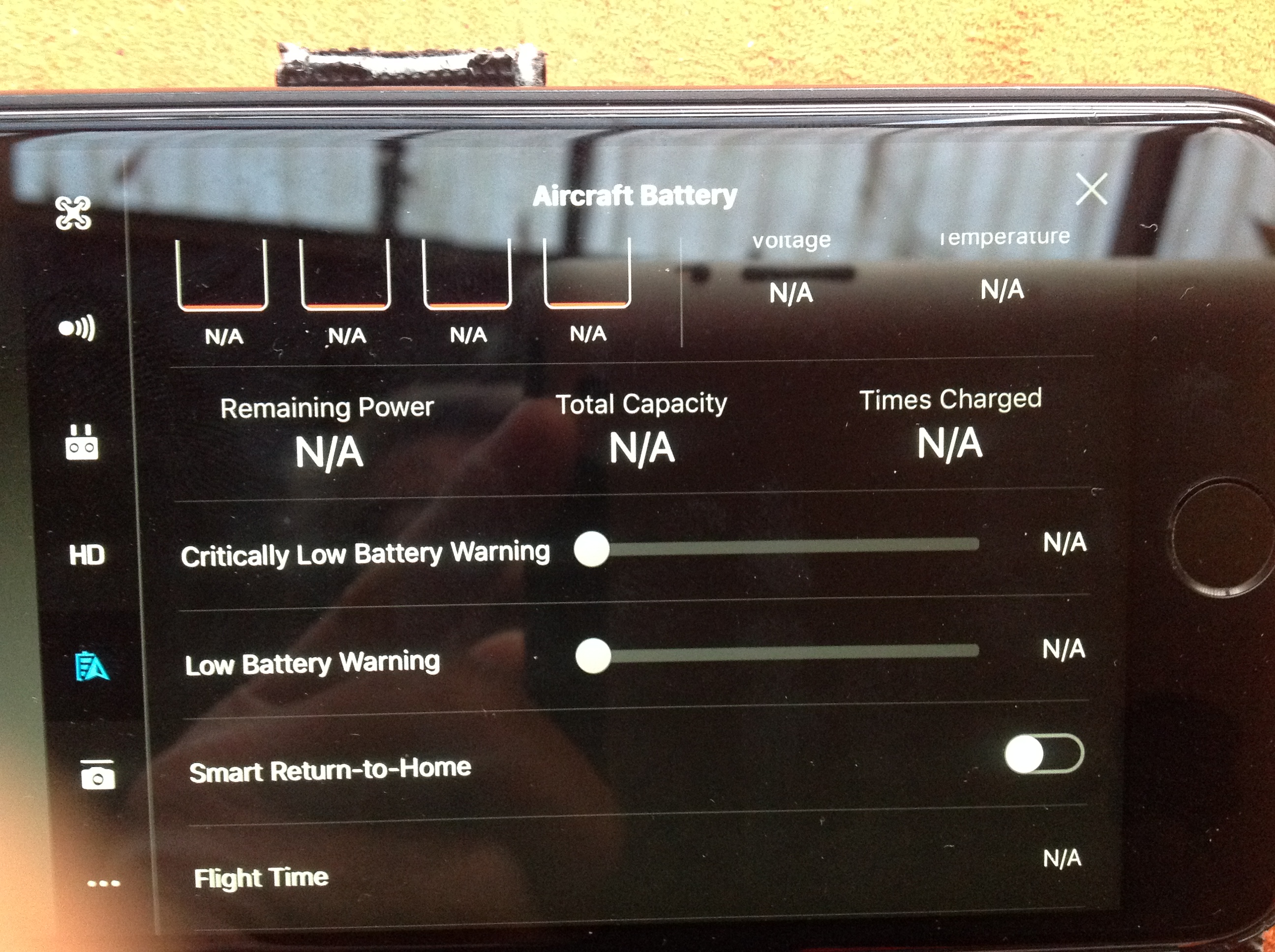

RTH Low Battery warning ?
Yup thats where it used to be but its not there no more ,they mightv have ditched it via the latest FW

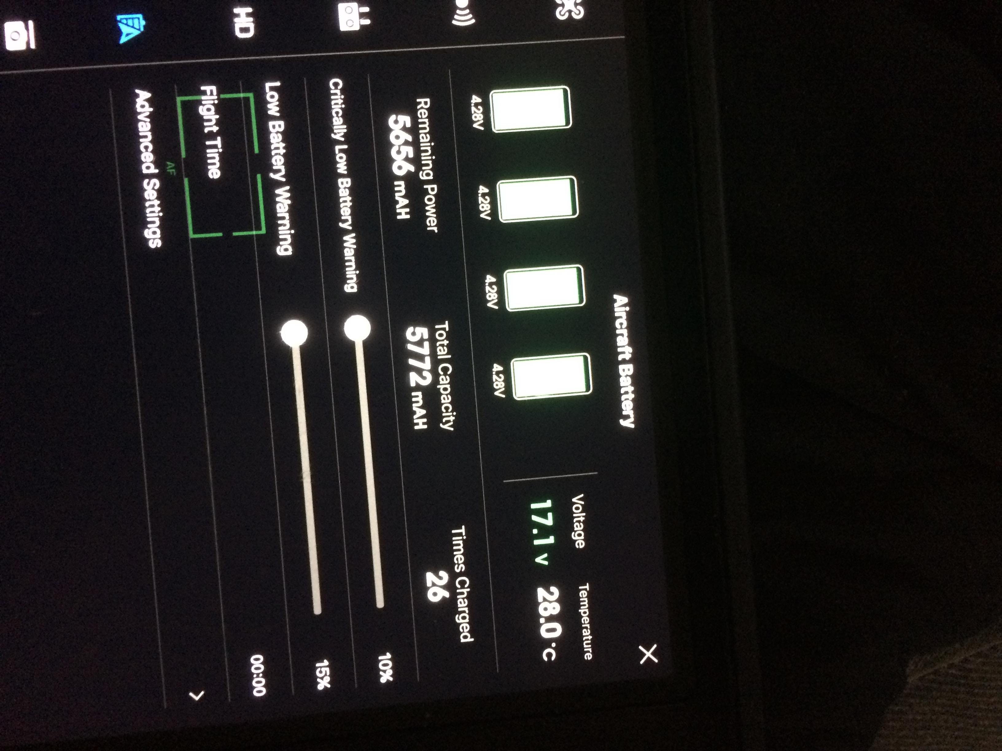

It's in the aircraft battery settings, latest iOS app update.
Im still on android v 4.1.3 and 1.8.0 ,yes looks like some have been able to keep and some are loseing it,i like to keep updated but all sorts of issues across the board seem to be going on after firmware is done,once again luck of the draw :):)

I'm using a P4p not a P4 that's why you have it and I don't I guess
I noticed that in your original post, and understand the additional features such as the sensors with the P4P, the better camera etc, but your unit having the larger capacity battery, can further than a standard P4, the option to disable the smartRTH would still be there. Obviously I'm mistaken.

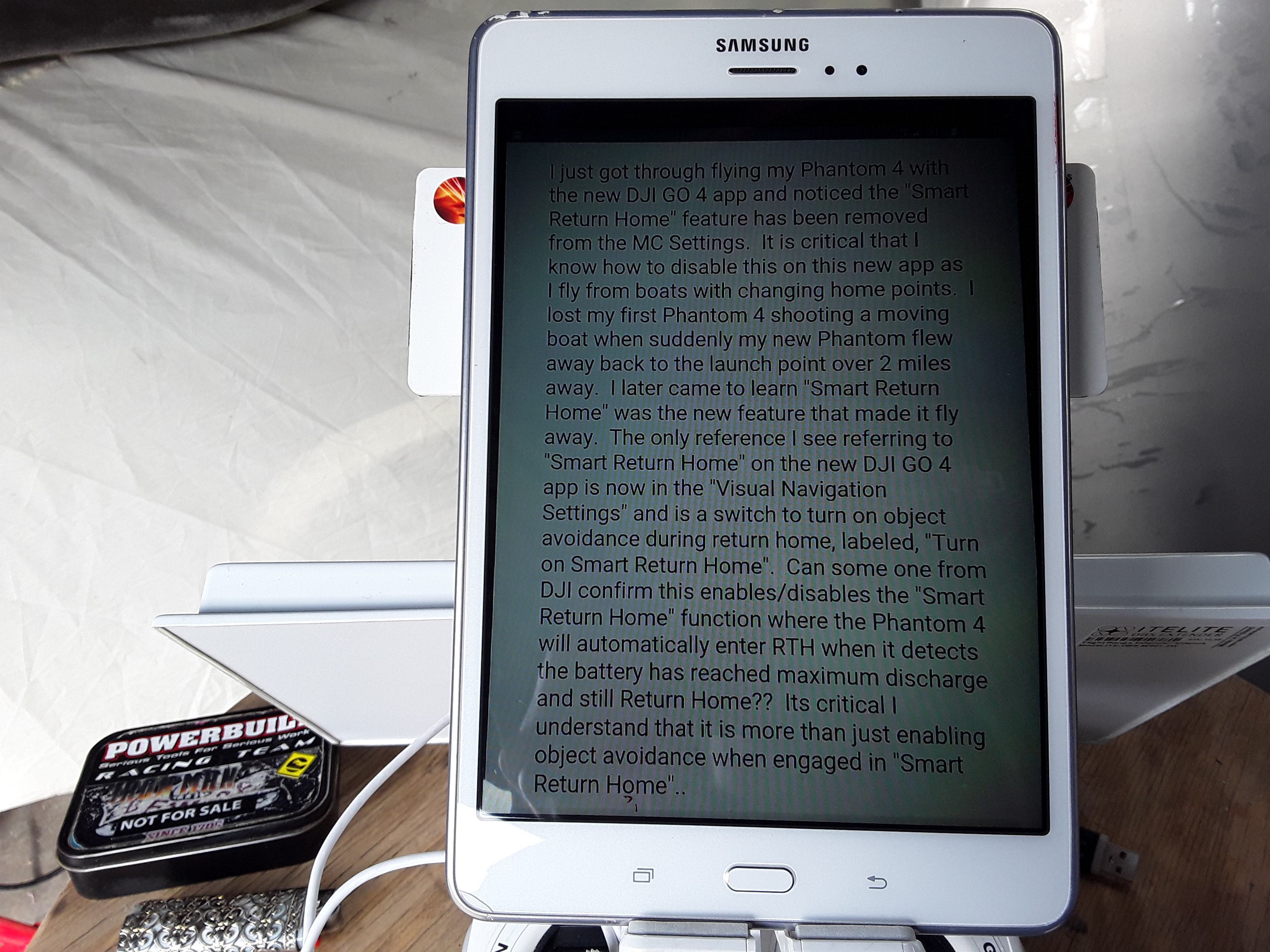

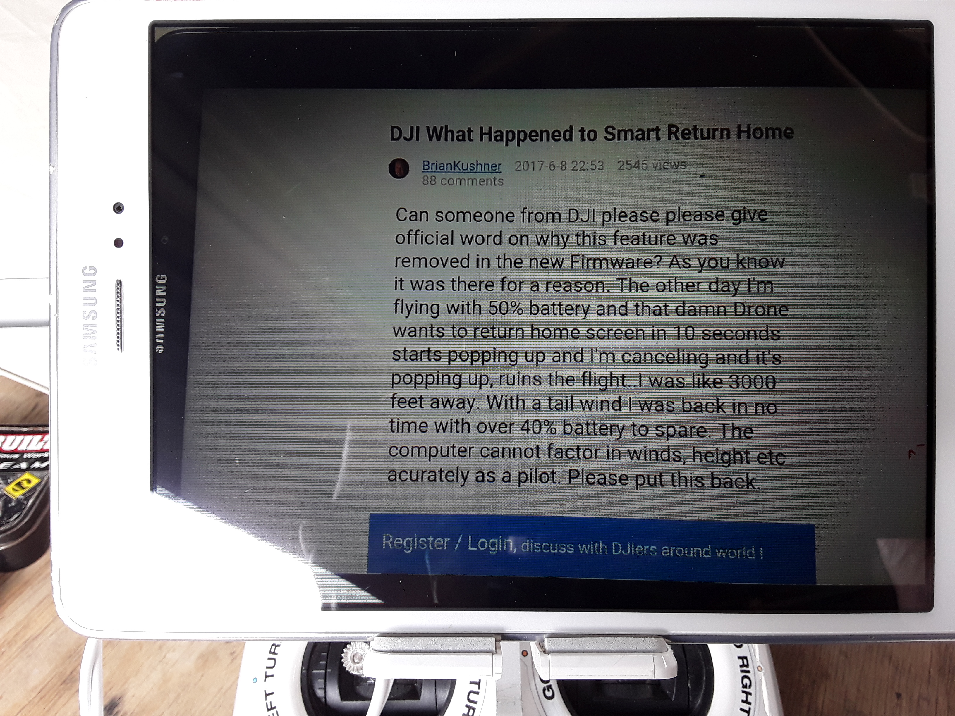

Just finished digging around on the forum and yes the smartRTH feature has been removed from the P4P a little while back. Apparently, the feature is switched on and you cannot access it to deactivate it, some folk are reporting it is affecting autonomous flights in Litchi and normal FPV flying. May stick with my P4 for a while yet, not ready to have a mission interrupted mid way and put up with the unexpected.
Yep long gone and no reason given. Causes many issues...No more missions of any distance. Having it kick in while in the middle of a shot etc etc.

I went out this morning and emptied three batteries an there seems to be no method to the pop-ups two I received while having 60-70 % remaining and one while still having 75% remaining so I don't know, but something weird happened in between battery changes I leave the controller on but shut the drone off during battery changes but on one battery change the drone behaved like it was in Beginner mode limiting my Vertical and Horizontal distance I was allowed to fly from the Home Point so I landed and shut both the controller and copter off restarted and was then allowed to fly like normal , and yes I checked inside the menu and I was not in Beginner mode.
