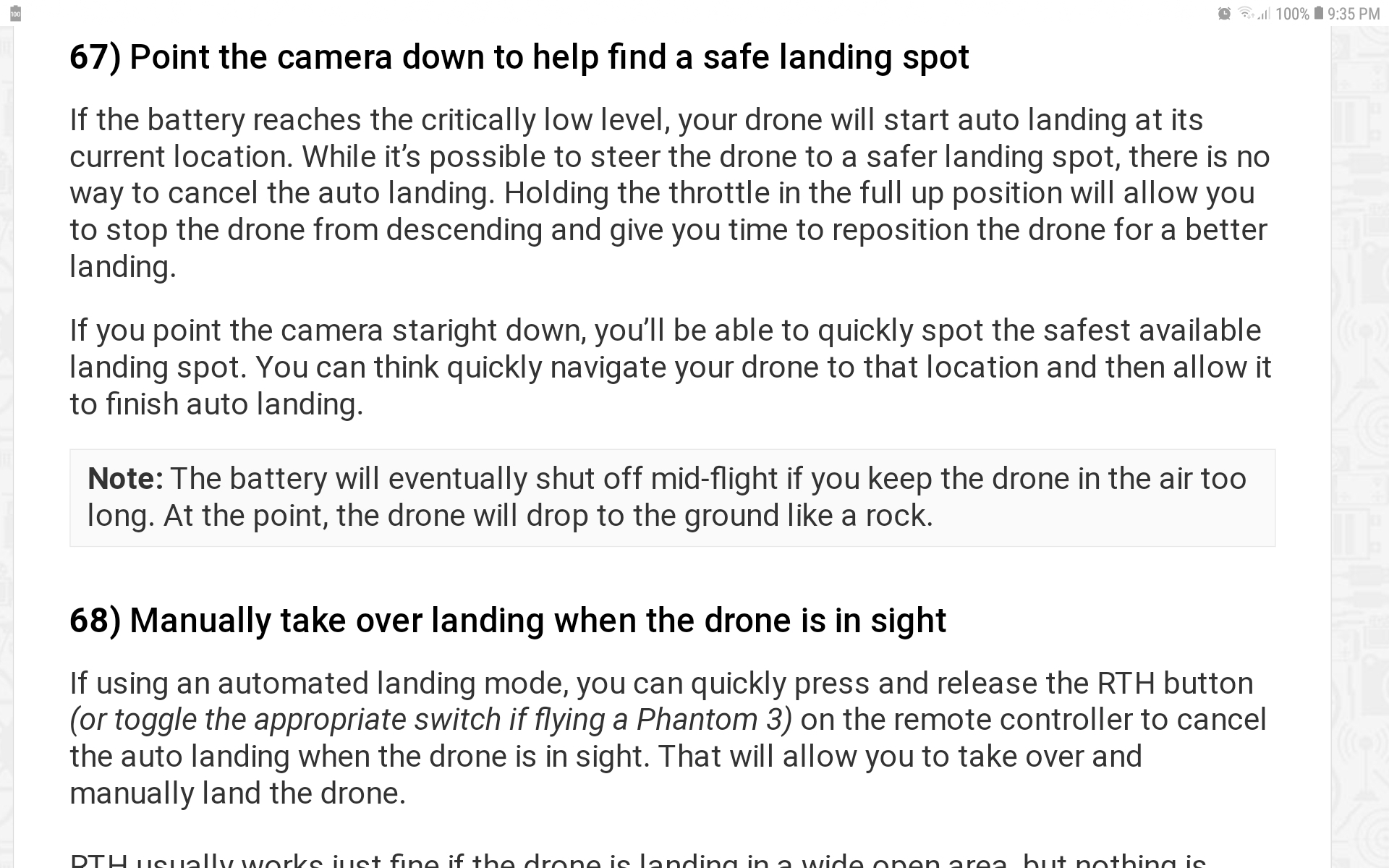

I thought auto land can be cancelled but not when its critical, it cant be cancelled

Ascending so high surely drained the batt. more than it would be at normal flight and the calculation algorythm estimated that the battery is almost enough to imediately land. Descending is much slower than elevating so it take longer time and the battery as well. If it used 31% for uplifting then for going down would be atleast 30% or more and because he didn't know where exactly the drone is and he mentioned the substantial wind, we can count at least 10-20% for finding it and so you quickly come to 10% which is the level when the landing procedure is triggered by default. So no mystery here.
