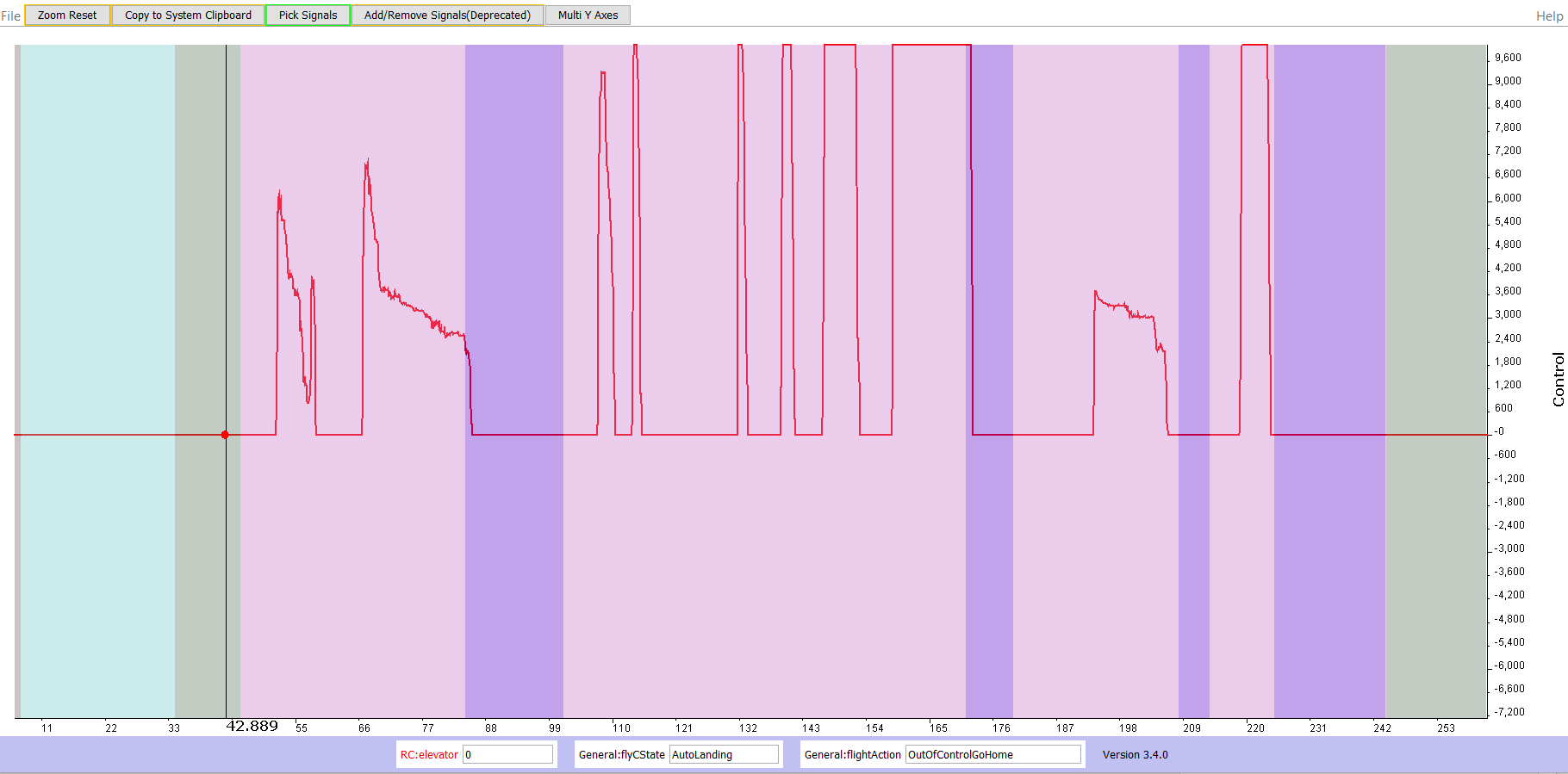

Made some interesting discoveries this afternoon. As soon as I push the stick ( to move forward ) fully down, the drone loses signal, maybe you see it in the Log.
I don't think it does make any difference but I did downgrade the drone to 1.5.7

You can see that somewhat in the logs, but the issue is the intermittency. Looking very carefully at the timeline, it looks to me like there are more than one single issue. I can't be certain, but that is my thought. First, it is apparent that you are loosing only uplink according to the timelines, because the data continues to transmit afterwards. Are you still seeing video? If not then there is an issue IMO on the aircraft side. Conversely, the signal losses are mere milliseconds in duration and judging from those, should not be long enough to initiate RTH, although it does initiate after only a few hundred milliseconds each time. It should take a full 2 seconds of uplink loss to initiate RTH. Which makes no sense to me. Not sure if your forward elevator movements are related or not. It does not happen every single time.You can see that in the chart below. I don't think there is much more to be gained from the device logs in this case.
Reactions: Kueni

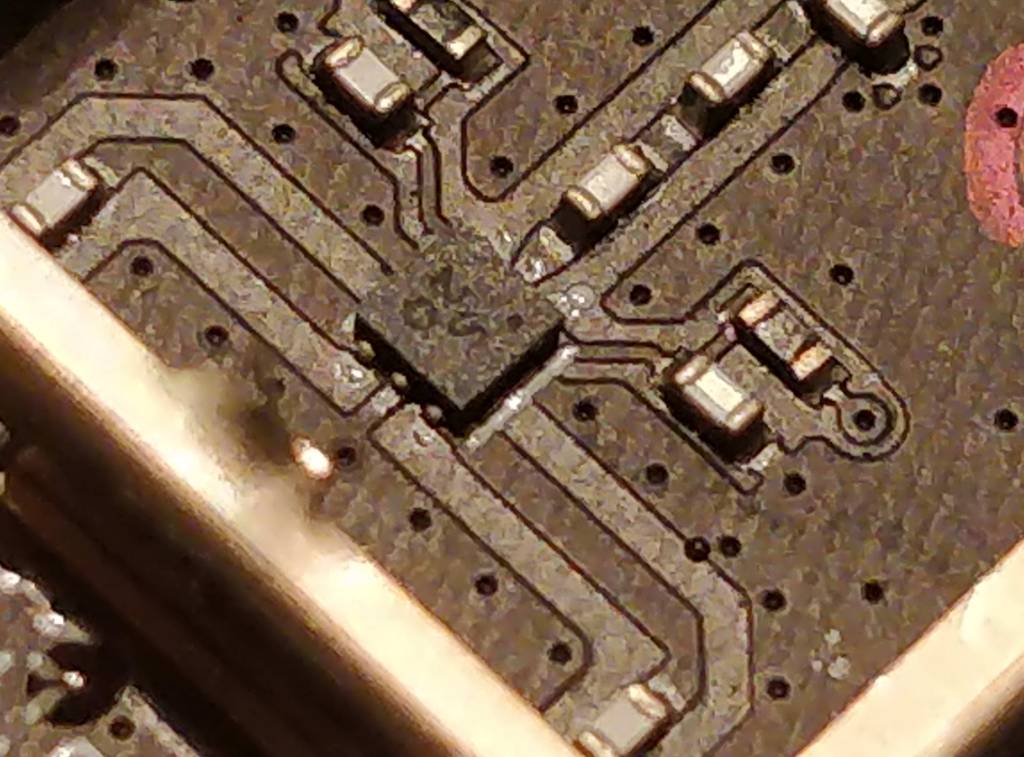

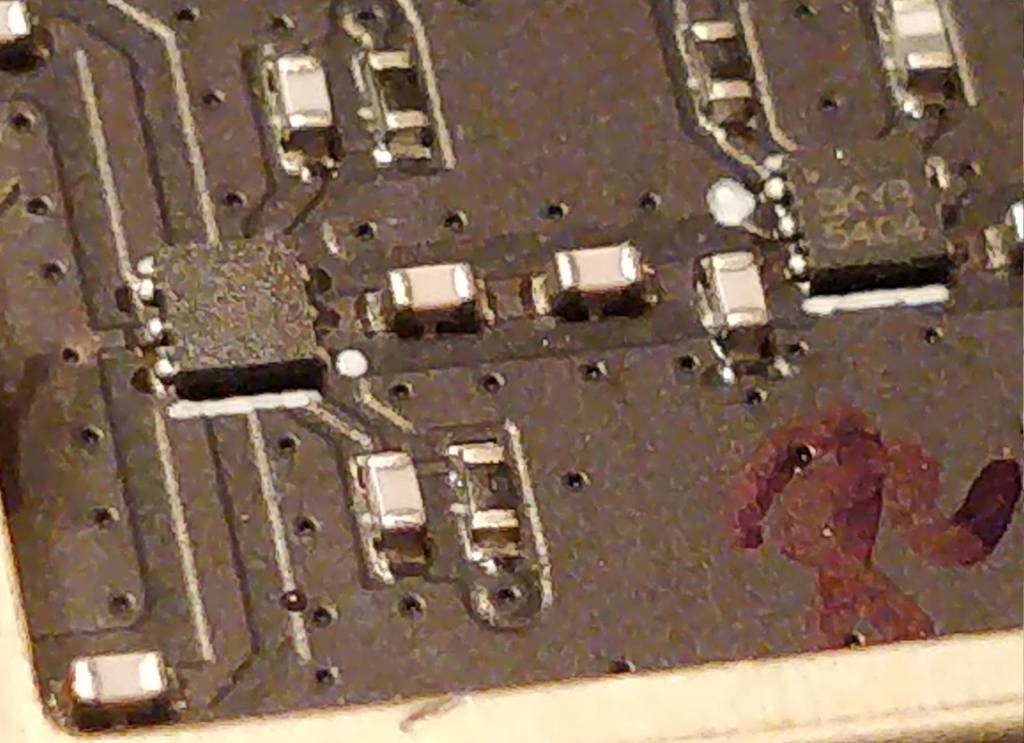

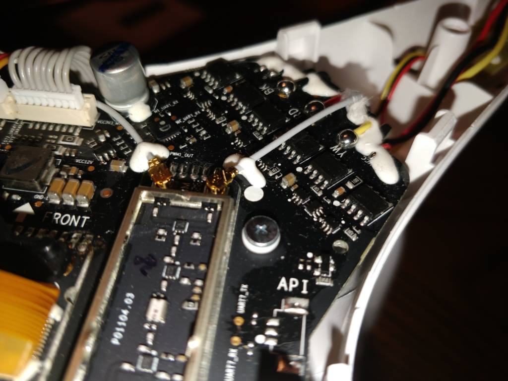

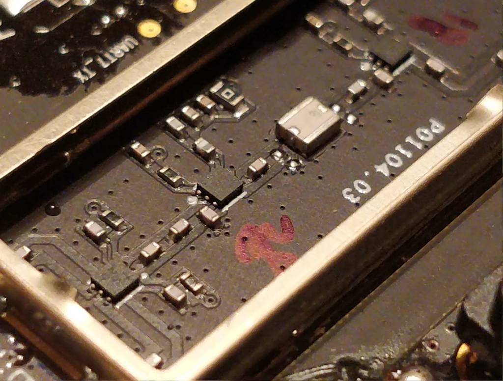

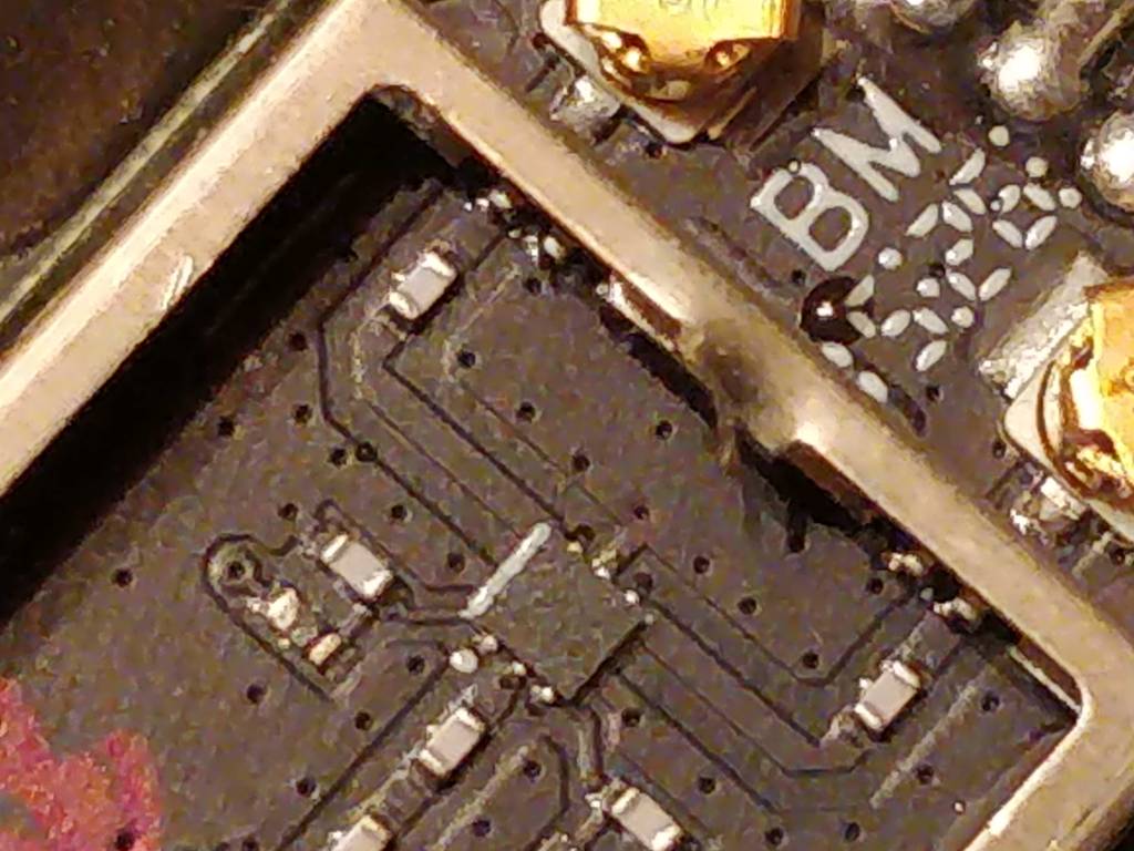

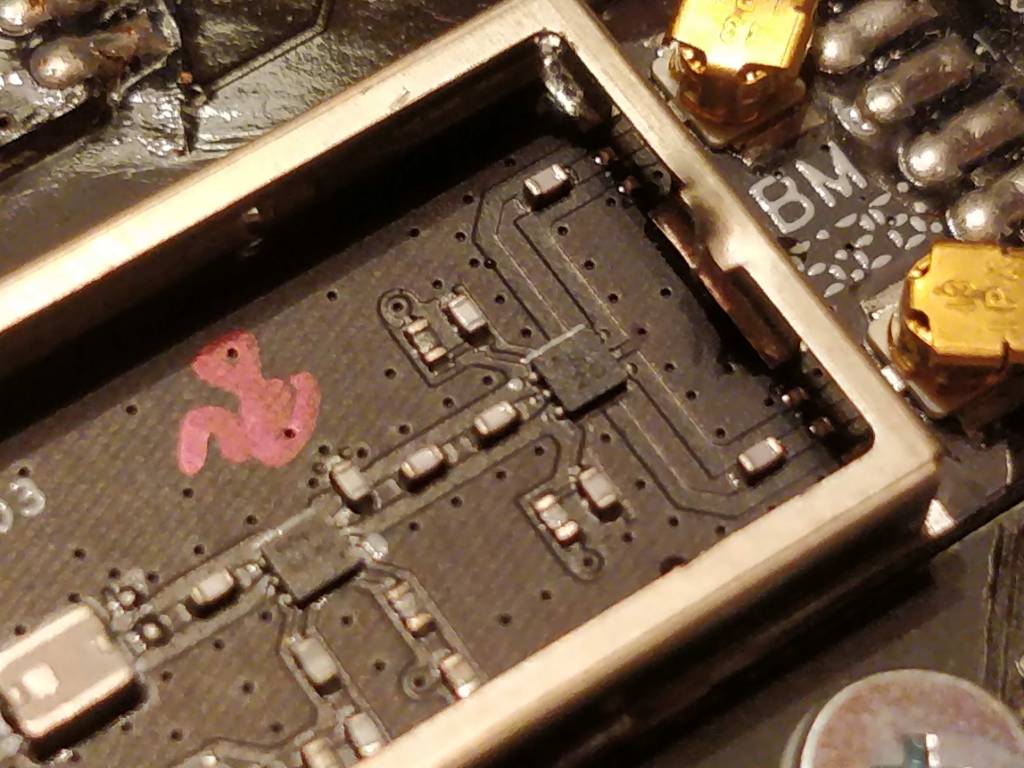

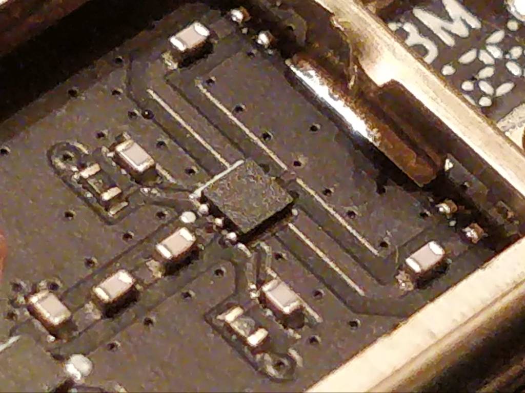

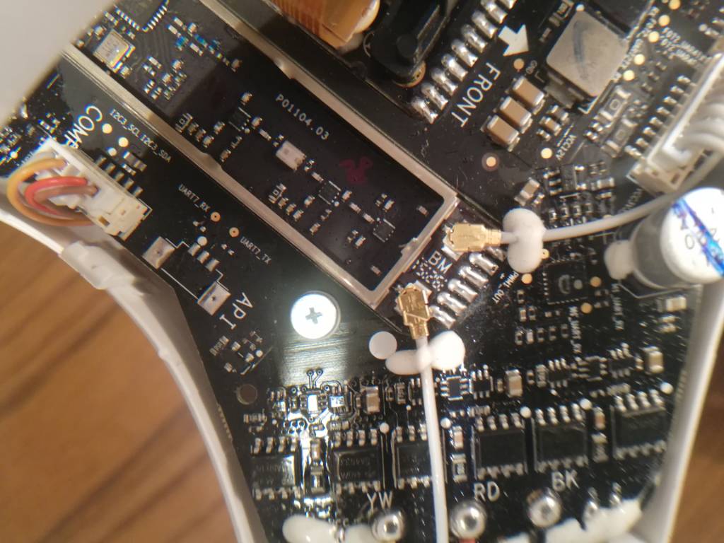

Update:
So we managed to open up the drone again and tested the chip for malfunction. As you can see in the pictures it seems to fine but apparently if you watch the video you can cleary see how the signal changes after we put a metal objact to pin 4.
At the moment we couldn't check if pin 1 or 2 is grounded as our multimeter hasn't fine enough tips.
But my friend knows someone who could check the pins and even replace the chip with one from our donor board.
