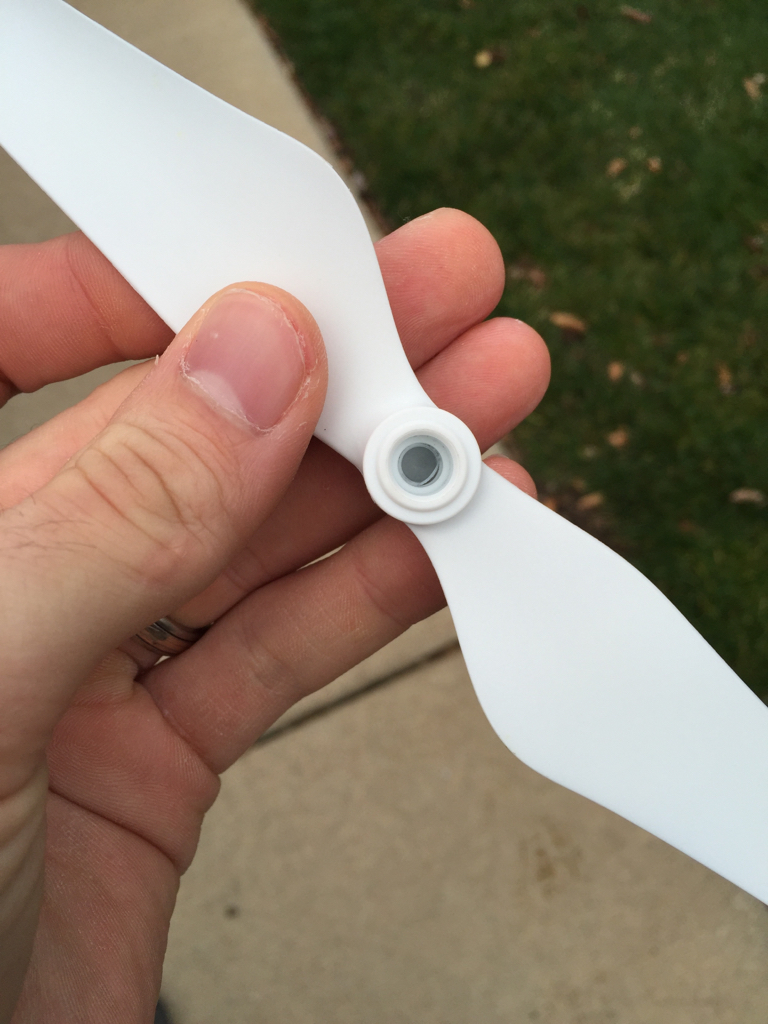

I wonder if that chipped part of the hub created a debris-like situation in the hub, that caused you to think/feel like the prop was sufficiently tightened, when it was actually only up against the debris, and with the hub not having a good "seat" the prop just came lose in flight. (???)
Other than the chip/debris in there, is there any other sign of damage to the prop?
If you simply mounted this prop as instructed, and didn't use a suspect balance rod (as I posted about earlier) to balance the prop ... and possibly making the debris yourself by forcing poorly cut threads on the balance rod into the hub, then yeah ... I would be looking for DJI to belly up and cover you on this one.
I wonder if that debris in the hub caused you to think/feel like the prop was sufficiently tightened, when it was actually only up against the debris, and with the hub not having a good "seat" the prop just came lose in flight. (???)
Other than the debris in there, is there any other sign of damage to the prop?
If you simply mounted this prop as instructed, and didn't use a suspect balance rod (as I posted about earlier) to balance the prop ... and possibly making the debris yourself by forcing poorly cut threads on the balance rod into the hub, then yeah, I would be looking for DJI to belly up and cover you on this one.
Debris? There is no debris in there. What you see is a piece of the threads chipped off
Yeah, I edited my post to clarify what I meant about the debris actually being the chip.
When I look at the image it appears to be resting on the inner rim at the lower ~6:00 position.
I'm wondering if that may have caused the prop to never be seated all the way down on the motor threads, but felt like it was when you put it on ..... if that makes sense. (???)
Did you use a balance rod to balance your props, and if so did the CCW props go on as easy as the CW props?
The Orion rod that is advertised on Amazon, has some people complaining that it's CCW threads, well .... basically suck.
Some cheap rods can damage the hub threads, especially the CCW/left hand threads, if not cut properly.
No I have not used any balancing rods
If that sliver shown in your picture is part the first thread and the rest of the threads are OK then I suspect that this is an effect of the prop coming off rather than the cause. Most likely, the motor stopped in flight and inertia kept the prop spinning in the direction it was turning which unscrews it. As it gets to the last bit of thread and with the bird now starting to tumble, the prop exits at an angle to the shaft peeling the last bit of thread loose.
Good analysis

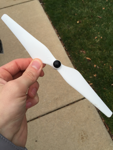

at 1 minute into the flight and 250 feet up 1 of the props flew off mid air and then fell straight to the ground. I found the prop that flew off and you can see part of the plastic inside of the prop broke off. I am about to file a claim. any idea if this should be covered? Could someone please provide me with the link?
