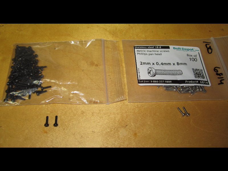

Also what size is it so I can get a replacement?
The screws retaining the tips of the Phantoms arms are 2mm x .4 mm x 8 mm standard thread.
I noticed that all of the bolts and screws were secured by a tiny dab of locktite. What do others do when replacing them, apply more lock tight or just check tightness before each flight?
Technically, once a locktited screw has been removed or requires re-torquing the old locktite should be removed from the threads and replaced with a new touch of locktite, personally I have found with shell screws I can get away without not bothering to do so but with motor screws I clean and re-locktite them each and every time they are disturbed.
On stock Phantom repaints I replace the tip screws with stainless steel screws as they are considerably less prone to stripping the heads out and on the Black Widows I use black cap screws which blend in rather nicely and being cap screws are not going to strip out ever.
