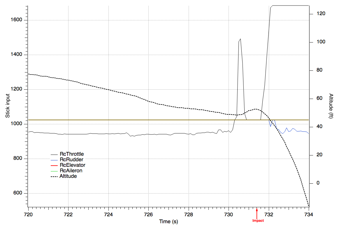

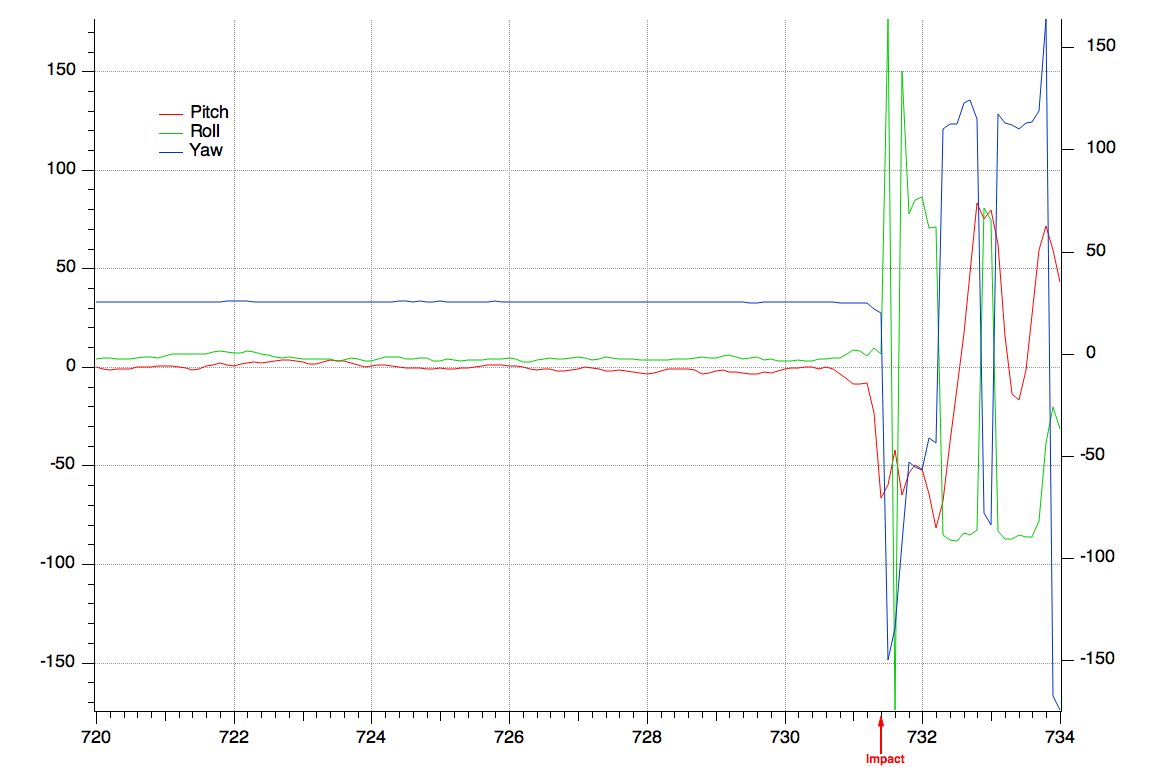

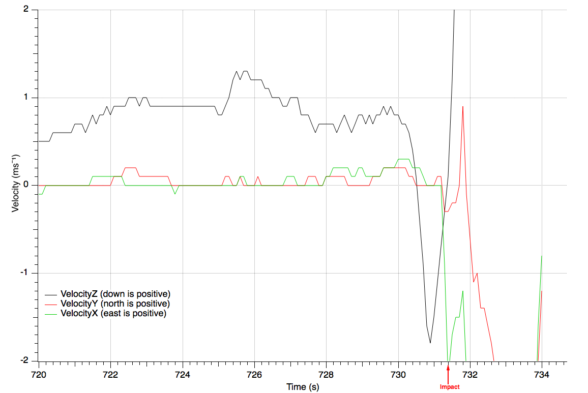

Your recollection may be incorrect, according to the flight data. It was descending slowly and moving towards the building, and attempted obstacle avoidance at 730 seconds. What does the video show? It kept moving very slowly the north east, possibly under the influence of the wind which was out of the south but probably doing strange things around the building, and then hit the building. There was only one impact, at 731.4 seconds, as seen on the pitch data.
It also appears that you did not use back elevator to attempt to avoid the building - the elevator and aileron are both centered and you had not applied either since the 700 second mark. You were applying throttle, both up and down in the last few seconds. Perhaps you were confused?
