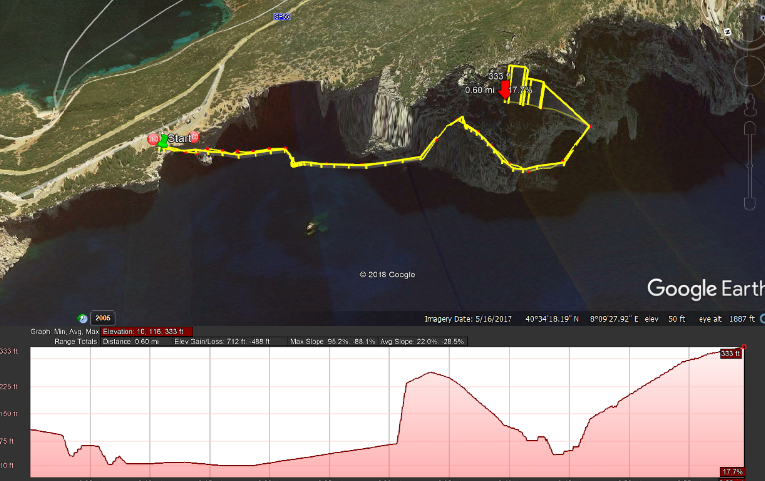

Judging by the elevation profile, your takeoff spot was much lower than the cliff sides. Your RTH setting was far too low. You would have needed at least 150m to clear the cliff.

Just a quick look before taking my son to school. I'd have to agree with you @Fly Dawg . The RTH was far too low for the significant increase in elevation from HP.
Also, he flew out in strong wind which is always bad. See how the speed dropped from about 26mph to -0- almost instantly when RTH kicked in. It could not overcome the wind which was also mentioned in a warning during flight. That could have been overcome with the correct RTH altitude I think. Just a lesson to others reading this thread to account for high winds going out.

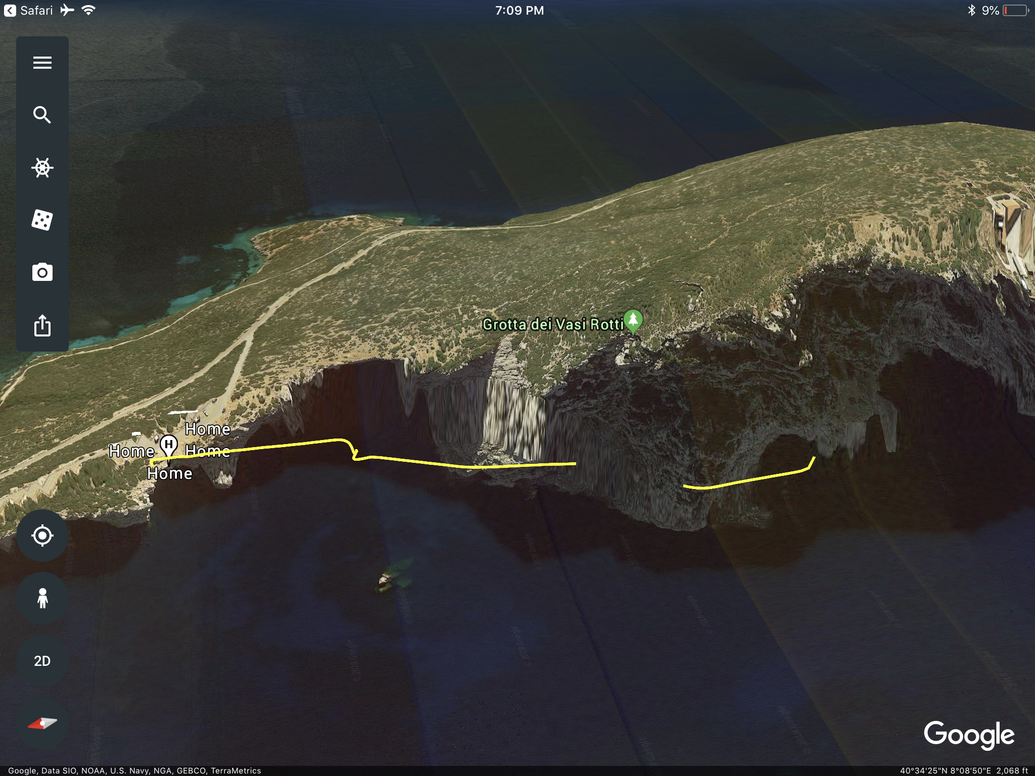

Your case is a difficult one to analyse and it has taken quite a lot to analyse and get an understanding of what happened.
The first thing I note is that you flew from a point about 30 metres above sea level and flew toward a cliff about 150 metres high, nearly 500 metres south of the home point..
You could have set the RTH height to clear any anticipated obstacles but left it at the default 30 metres.
You flew behind a part of the cliff about 350 metres away.
For much of the flight, you were close to the cliff and the VPS is indicating rocks 5-6 metres below the Phantom.
At 1:46, (380 metres from home) while flying at 10 metres/sec obstacle avoidance activated.
From this it would seem that you were flying out of visual range, fairly fast and within a few metres of the cliff edge.
I have only been flying for 4.5 years but that looks to be risky flying - too risky for me.
Tall sea cliffs can generate strong wind and updraft conditions. We don't know what the winds were like?
I sent the drone behind the edge. As expected, shortly thereafter the remote lost connection and the failsafe RTH routine was automatically launched. I was not too overly concerned as there was plenty of open space to fly back. What happened afterwards, however, left me speechless. In a situation in which the drone had a tall cliff on one side, but was completely open on all the others, the RTH, after controlling it for 53s, achieved the brilliant result of crashing it against the cliff. That made me speechless for a couple of reasons: with all obstacle avoidance tools the P4 advanced has, the RTH routine could not detect that the path was free in all directions but one, where there was a giant wall. Secondly, in the presence of good GPS signal, it could have simply adopted the dumb strategy of flying the outbound path backwards.
At 2:46, 576 metres from home and flying at full speed 12-13 metres/sec and lose signal for 12 seconds.
When signal is regained the Phantom is 10 metres further away and starting to RTH.
It is at the same altitude but is facing toward the home point and almost stopped with VPS indicating rocks 7 metres below.
One second later, you lose signal again for 23 seconds.
When you regain signal, the Phantom has ascended to 30 metres RTH height and is facing home with rocks 8-10 metres below and going slowly.
You use the left stick to climb another 10 metres to 40 metres and leave RTH to bring the Phantom home.
The speed climbs to 8 m/s at 3:32.4 but when the VPS height drops from 7 to 3 metres, the speed drops to almost zero.
My best guess here is that the Phantom is very close to the cliff and obstacle avoidance has slowed it?
Speed stays at <1 m/s until 3:46.8 when the speed increases to 7 m/s but the pitch and roll indicators suggest the Phantom has clipped the rocks and is not recovering well.
The VPS height shows that there are rocks just below the Phantom.
At 3:52.8 it spins to the left and tips up and the recorded data ends when signal is lost completely.
The whole time it was in RTH, the Phantom was pointing straight toward the home point with a cliff edge close to the east pf it.

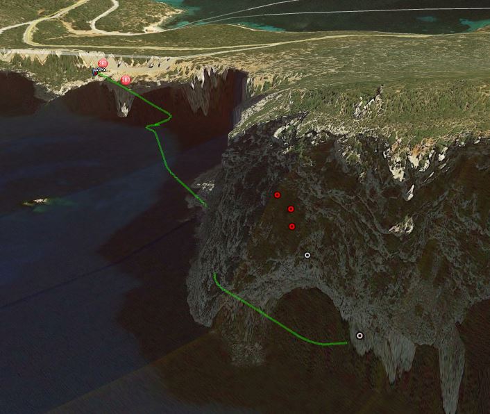

For what it is worth, just a different view, including the estimated terrain profile and flight altitudes. As you can easily see, 30m RTH is far too low. The cliff is over 100m. Although granted you were over 50m at the impact point, and RTH would have returned at 50m as opposed to descending to 30m.

Finally, Fly Dawg, thank you for posting that great 3D flight path pic. Can I ask you how you generated it? I created a kml file from my log on airdata.com and imported on Google Earth, but I only managed to get the much crappier representation below.
