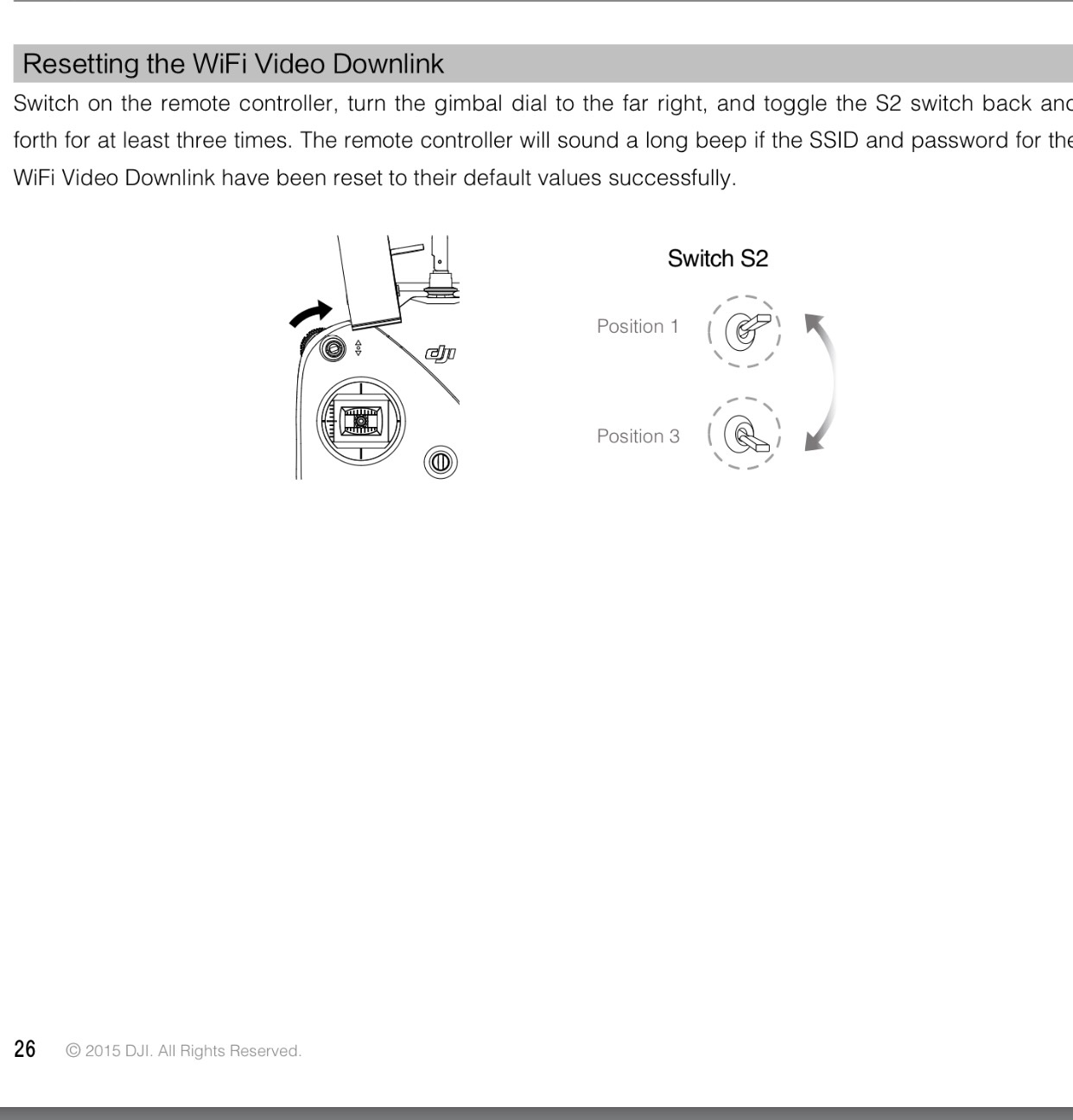

    Here are the instructions in the manual.

    Great thanks. As always reading the manual helps!!!
    I will try it tomorrow and see what happens.

    OK Today at last the weather was OK to test my Phantom 3 Standard after resetting the wifi and uninstalling and reinstalling the DJI Go app. GREAT NEWS! It worked I had a solid wifi throughout the fight and took video and stills with no problem. I flew in P/A/F modes and all worked as advertised. Thanks Mandalay for you advice. I am still not sure whether it was the resetting of the wifi or the reinstalling of the app that did the trick. My guess is the app, but anyone else with the problem should probably do both.

    does the drone need to be powered on when doing this reset my light on the controller turns red and green color not solid

    For Wifi reset, the drone does not need to be on. But you might have a different issue, possibly the controller is not connected to the drone. In this case, you need to turn on the drone and see if it's linked first.
  15. markstoys
    Mar 29, 2015
    237
    19
    thank you,my drone is connecting but has had the same issue more so after updating filmware like yours so just turn on controller flip s2 switch three times and hold wheel to the right how long will it take and when im doing this and has happened the light blinks from re to green back and forth
  16. mandalay
    Nov 28, 2015
    743
    190
    So if you did it correctly, the Wifi SSID is reset to default; password is 12341234. Check if your mobile device is connected to this Wifi network.

    I'm going to need step by step confused first do I turn on only the controller or everything including the tablet the go into WiFi on the app under WiFi which I did comes up with 1234124 then says restart drone later or now something like that

    Here are the steps:
    1. Turn on the controller
    2. Go to your mobile device and turn on Wifi
    3. Connect to the Wifi network that you reset (should be Phantom_xxx) and enter password 12341234. Make sure it's connected.
    4. Turn on the drone
    5. Launch DJI Go app on your mobile device and tap on Enter Camera View
    6. You should see a live view from the drone's camera
    7. Use the gimbal dial on the controller and see if you can tilt the camera up and down. If so, you should be good to go since the controller is linked to the drone
