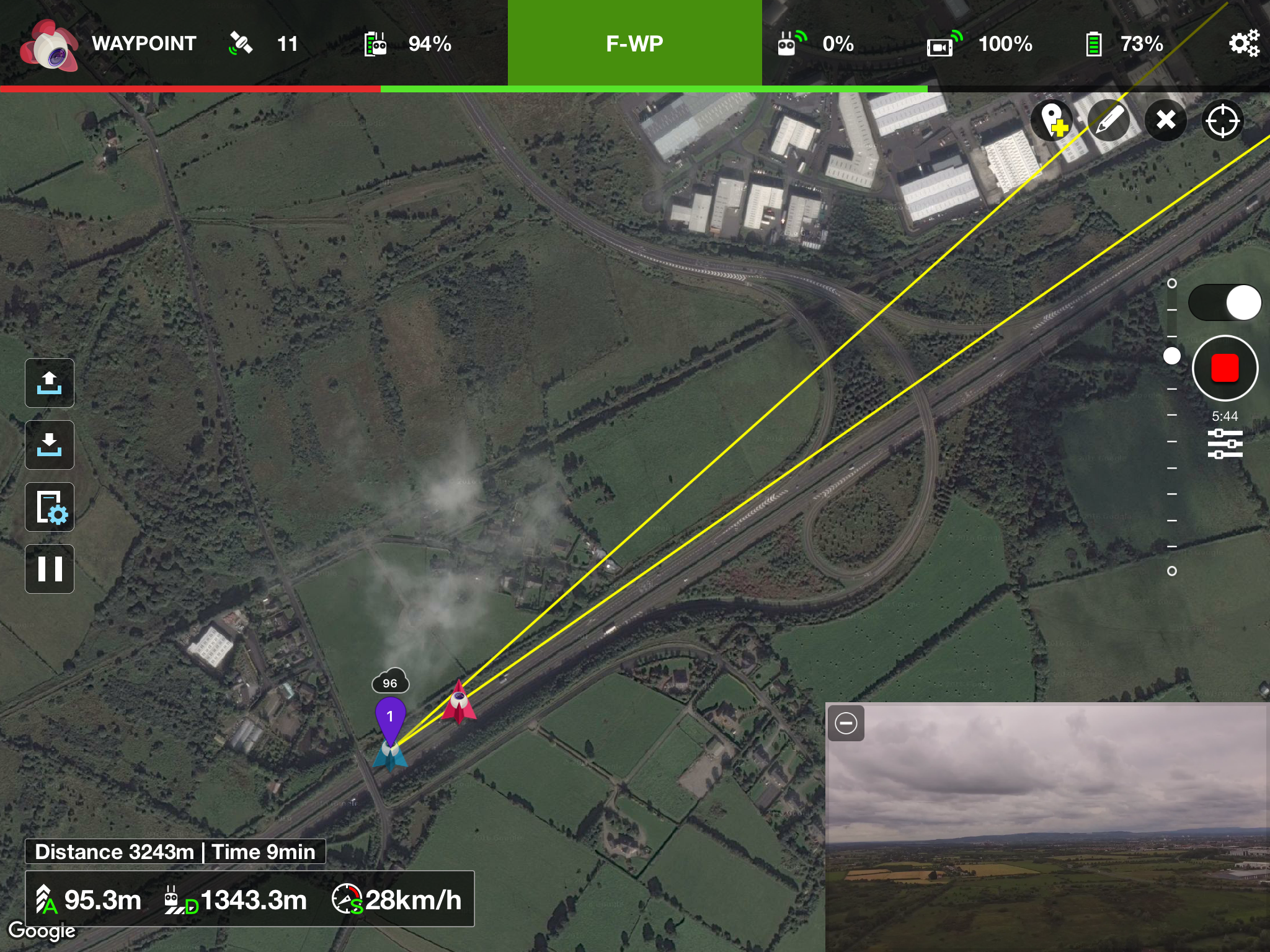

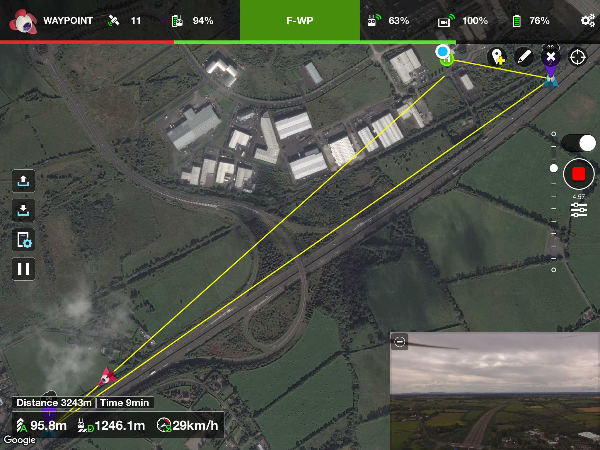

My test results today
Control signal actually cut off at around 1400 meters. 100m high.
But I was still getting nice video and current telemetrics data all along the way.
Check out the screenshots. The control signal is 8% and video still at 100%.
That's the power of 27dBm ;)
Stock antennas BTW.
I'm happy with it now. 1km range is just about what I expected from it.
1246m away 100m up - Control signal still OK, video Perfect
1390m away 100m up - Control signal low , video Perfect
1340m away 100m up - Control signal gone, video Perfect :) 100%
