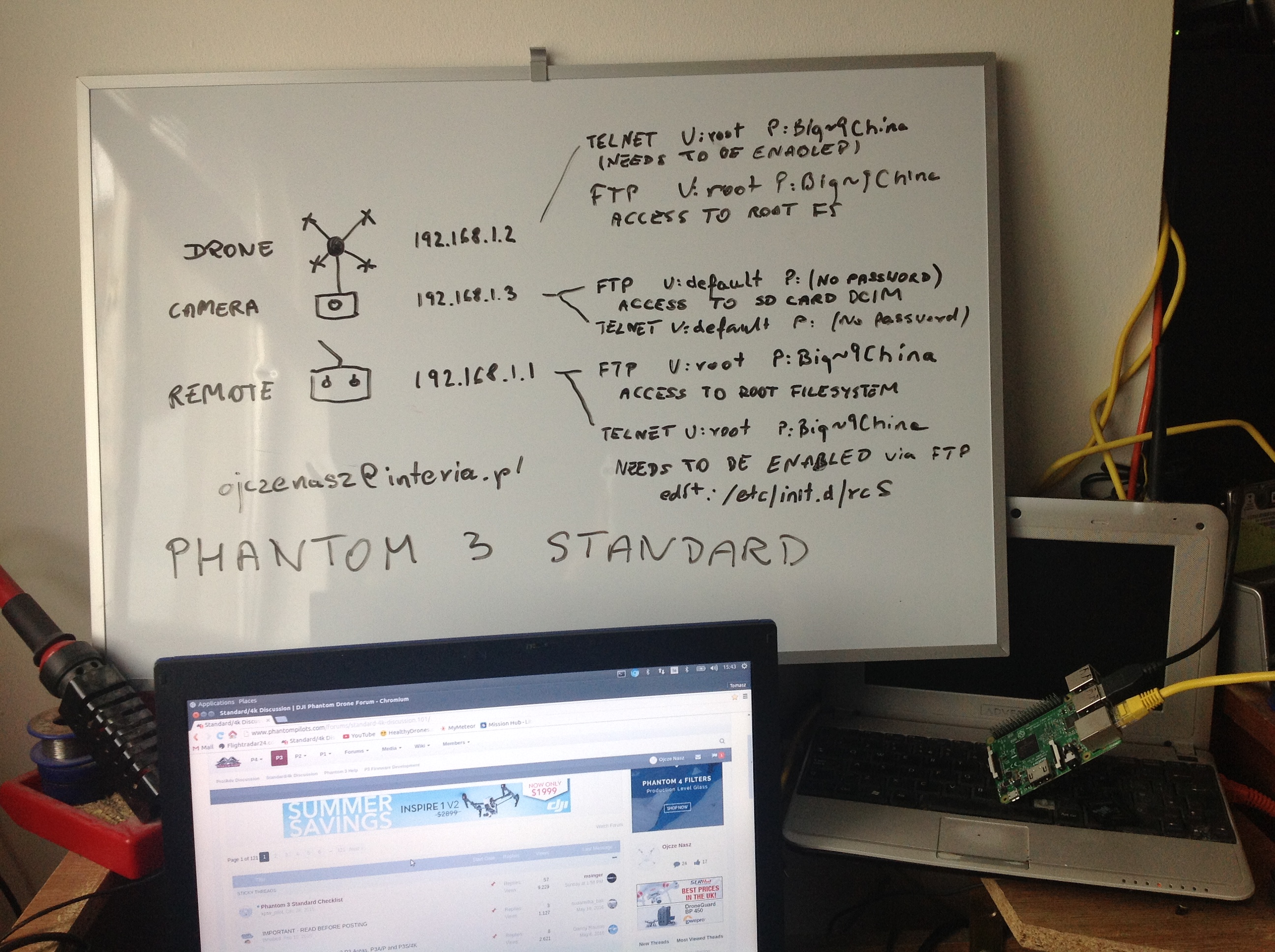

View attachment 56598 Phantom 3 hackers cheat sheet ;)
Wow man, awesome work! Thank you! I've never seen anyone get so deep into the DJI systems. I bet you DJI is scrambling right now to change all FTP passwords and load them in the next FW update.
Now the million dollar question! Actually, the $1,640.00 dollar one (or 500 Euros in European monies)..
Have you, by any chance, noticed any 'max-altitude-limit' related code? Like the 1640'/500m numbers anywhere?
Do you think its also hard-coded somewhere into the system? Or is it hidden somewhere in the Go app?
P.S.: not that i would ever fly over 400' feet (its against FAA rules and regs people!), but just, you know, for educational purposes, in the name of science! ;)...

Does anyone know what is located at 192.168.1.20 in the phantom network?
Unbelievable i only discovered this topic today. :confused:
1.20 is your device, either tablet or PC, whatever you have connected at the moment to your PHANTOM3_XXXXX network
