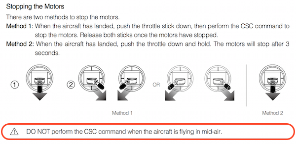

I really like the check list ad will certainly use it, thank yall. I am abit confused from reading the posts about the best way to turn of the motors, csc or what is the other way? I do not yet have my drone it is on the way!
A CSC works too, but you could tip your Phantom if it's not done cleanly. Holding the left stick down for ~3 seconds is always safer.
