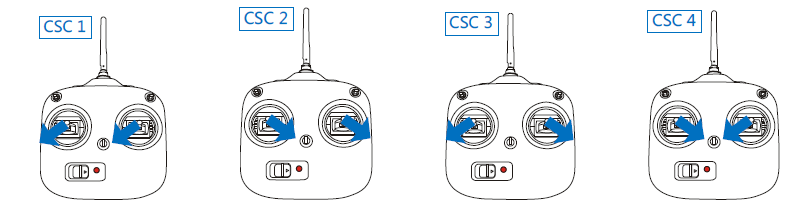

Your picture shows the sticks in a CSC event which will shut down the craft. Did you mean to do that?

I did CSC to turn off the motors after it has been flipped to the sand. I didn't execute CSC during the flight. VPS was off and I was only about to fly straight out then it flipped. I would try to get the log files later and upload flight record as a video so you will have a better idea :)

1 and 2 are not CSC for the P3.
