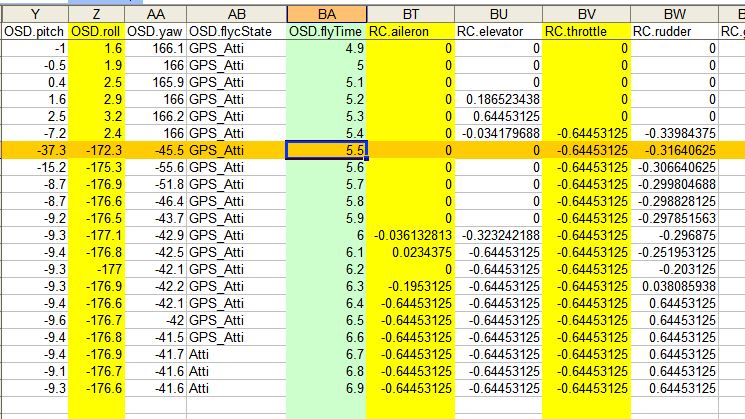

Looking at the csv file I noticed I mapped the roll values to the pitch.
When your Phantom flipped did it flip forwards or sideways as per below video? From the csv its sideways =roll.
Below a screen capture of the last two seconds from the csv file. Total recorded flight time is 6.6 seconds.
The first seconds clearly show a CSC (not shown).
Between 5.4 and 5.5 seconds the OSD.roll goes from 2.4 to -172.3 (the sideways flip).
The Rc throttle is lowered to its max between 5.3 and 5.4 secs in 1/10 second.
You further say you hovered for a minute prior the crash but the logger logged only 6.9 seconds with a proper CSC at the start.
So the first question is why did the Phantom "reset" itself 6 seconds prior the crash? Do you have any video from the camera?
