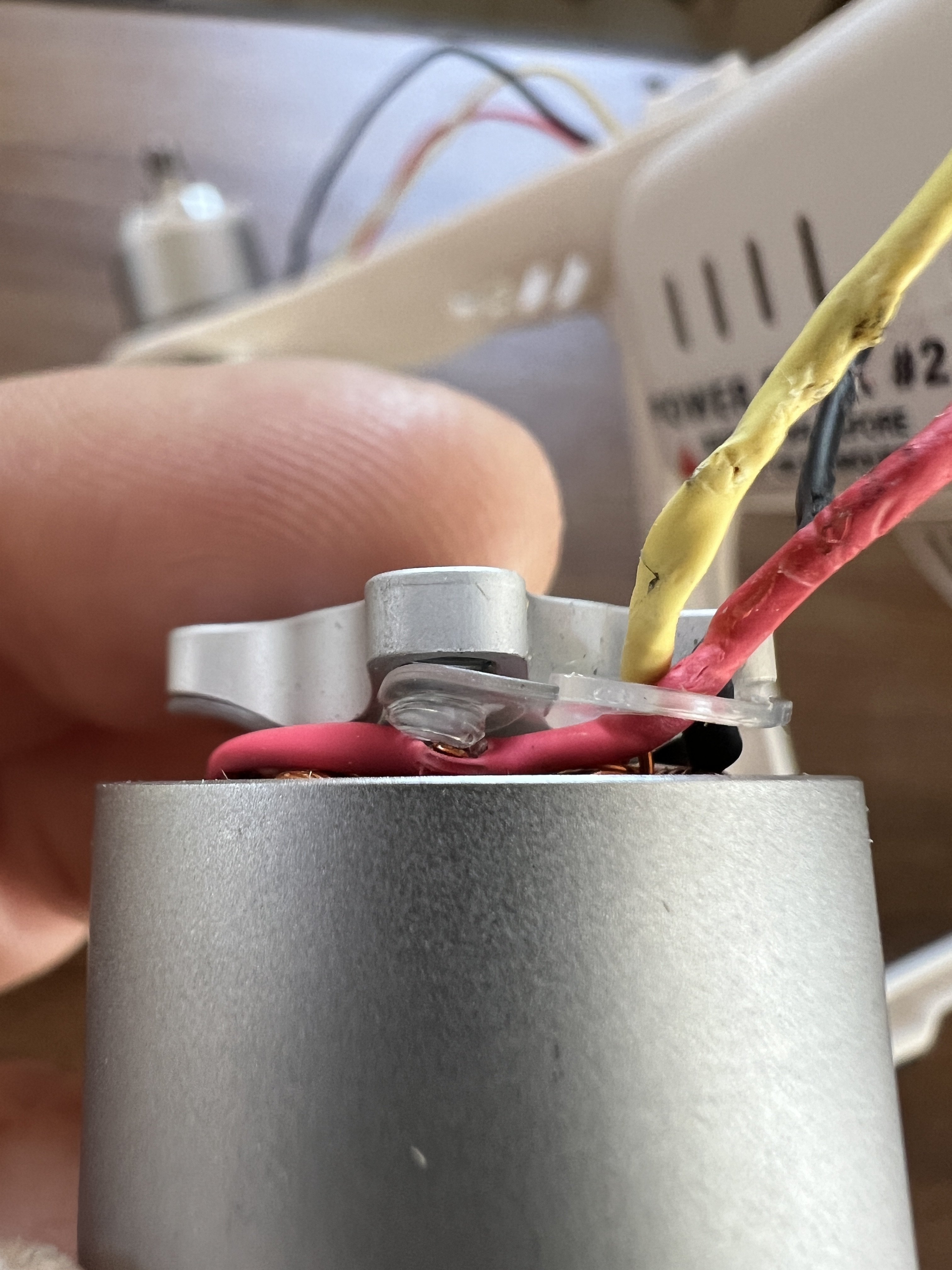

I did install one screw and see that it was bumping into the motor so I backed it out. Fortunately, I did not crank it. That’s when I forgot to put in my replacement screws because I was going to go looking for a shorter screws.
I started it up with the props on it, and it did start spinning all four, but then all hell broke loose, and the drone stopped. I don’t know if it’s one motor or all of them at this moment I can’t get it to do anything other than the ESC when I try to get motors spinning.

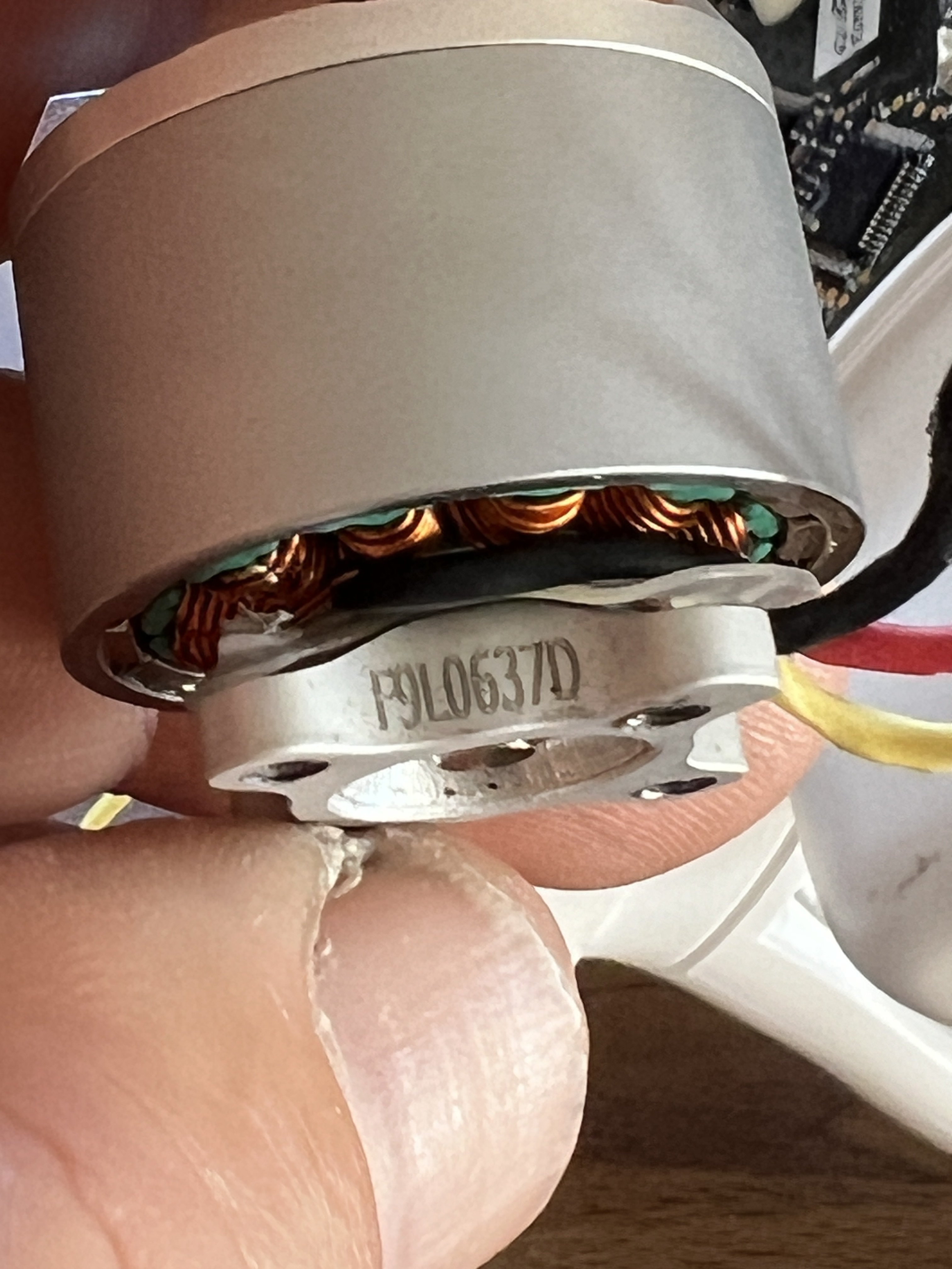

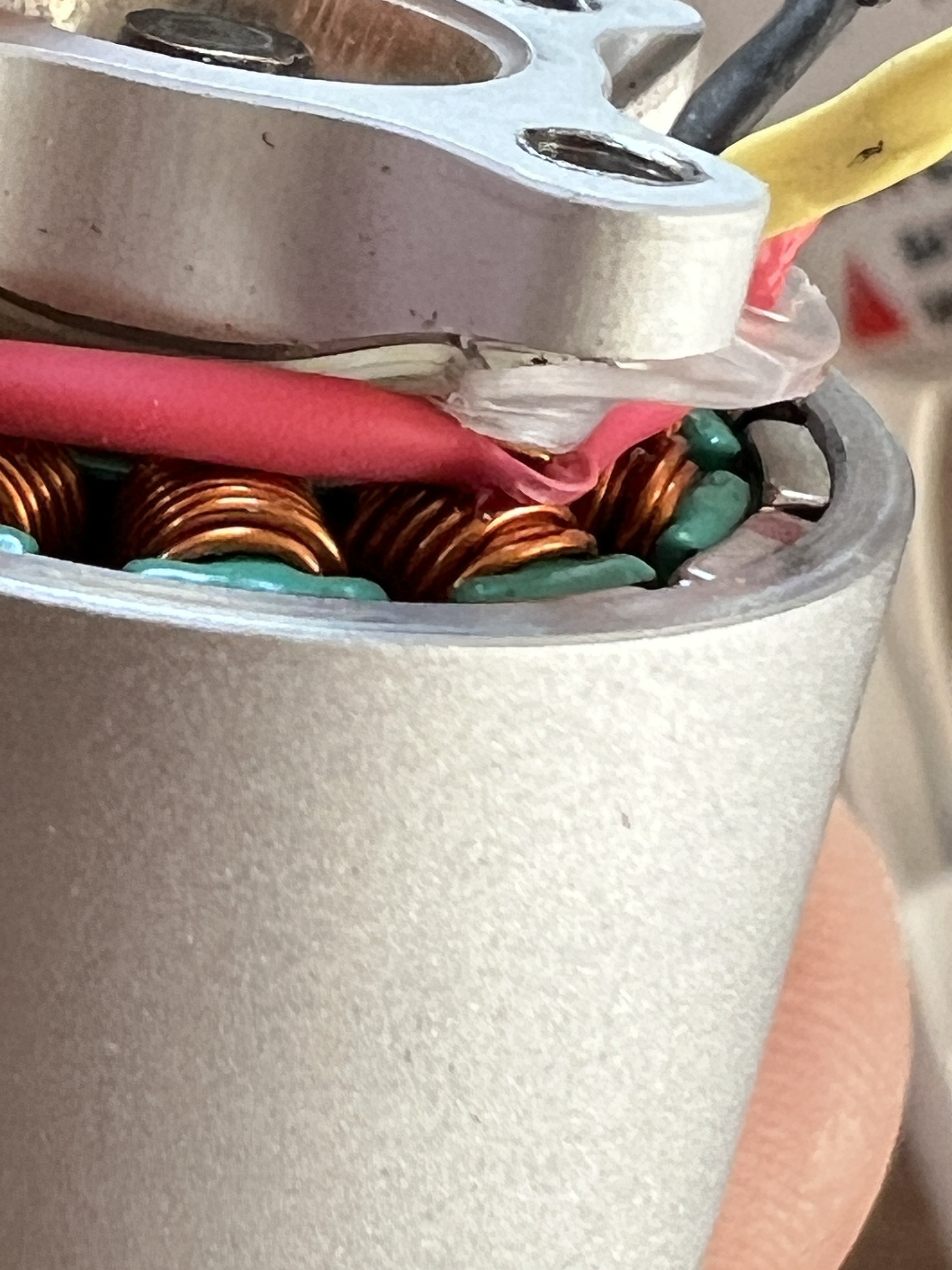

I only tried to assemble with a single long screw and recognized it was too long. I reassembled with the guard mounts again so it should be limited to a single motor. But do I need to wire a replacement motor to know for sure?

As chewed up as those wires are, if it were me, I'd change out the entire motor assembly (which includes wiring). And check the other 3 motors for screw damage, or any other defects.
The ESC error prevents the drone from starting in the event one or more motors is compromised.
