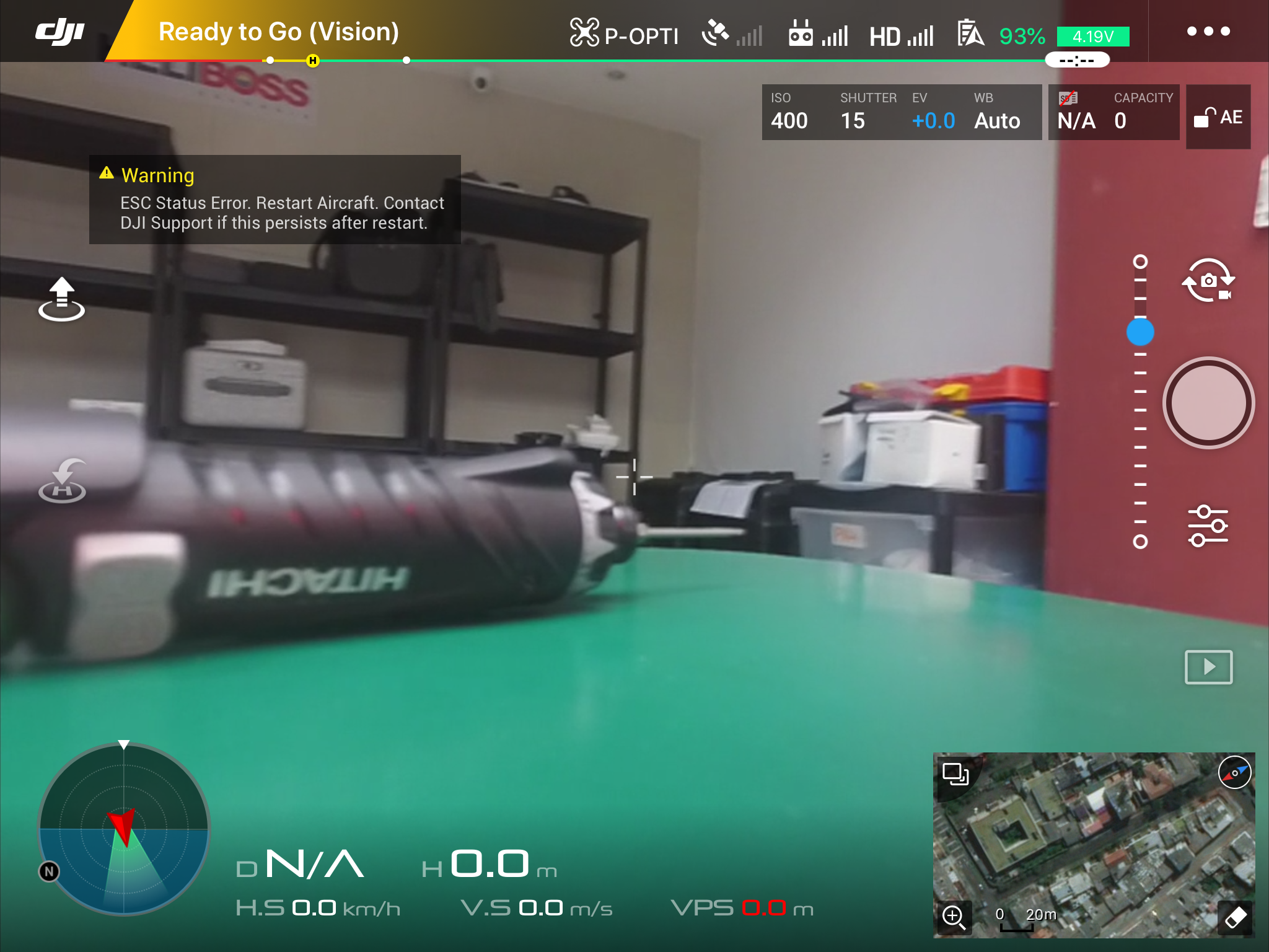

I have problems with the esc of my phantom 3 pro. I have no idea why that notification appears, I need help to solve it. who guides me?

I had same issue ESC error I checked everything motors soldering etc still had it. I downgraded the firmware and then wallah it worked the motor startedvand no more ESC error. It will ask you to update I did and now my drone is flying. Before replacing ESC I would try downgrading the firmware like I did then if it doesn't work I would replace the ESC. Let me know if you want the the downgrade file.
