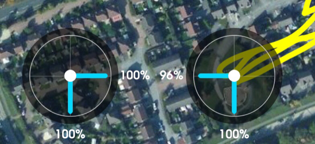

What am I looking for in the flight logs that will show if it was CSC
Like @F6Rider said above me go in the user center to view the log. If both sticks were in EITHER corner 100% that is a CSC.
This was my stock position, I guess this is a CSC then, correct ? Is it possible to turn of CSC?
With the damage I've had I think it'll be easier to get another one than the cost of repair, very expensive mistake ;-(
Yeah it sure looks like it. Sorry for the loss of your aircraft man. Does anything look salvageable? You might try and part it out in the classifieds. You should be able to get a few hundred for the remote and if you have any spare batteries you could get some cash out of them to get some cash back to purchase another. Good luck man.
