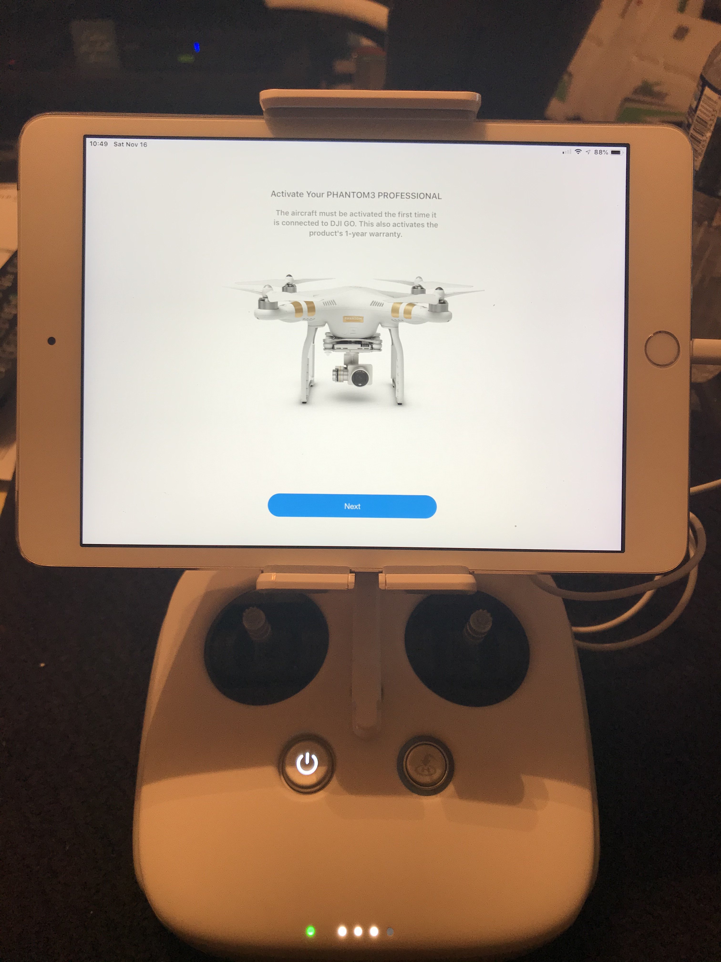

Phantom 3 Pro Connection To iPad Mini 3, Won't Launch App
Do you have any other USB to lightening cables you can try? The problem certainly appears to be the communications between the RC and the iPad. There are some USB cables that are made to charge devices only, and not carry communications. USB cable problems are often reported on this forum. I would focus on this issue, as it appears to be a hardware communications problem at this point. I don't see this as a software problem now. Changing and reloading apps is very unlikely to help if it is hardware.

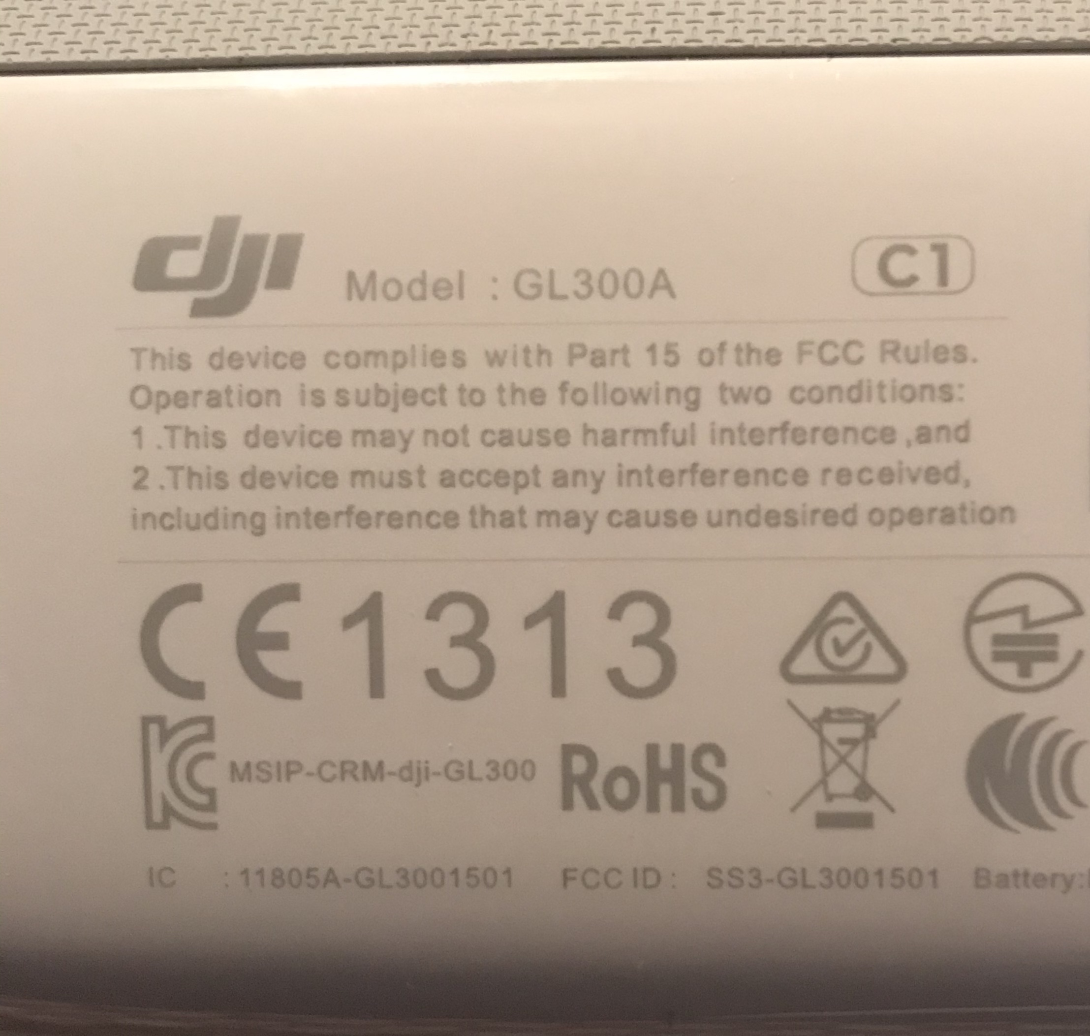

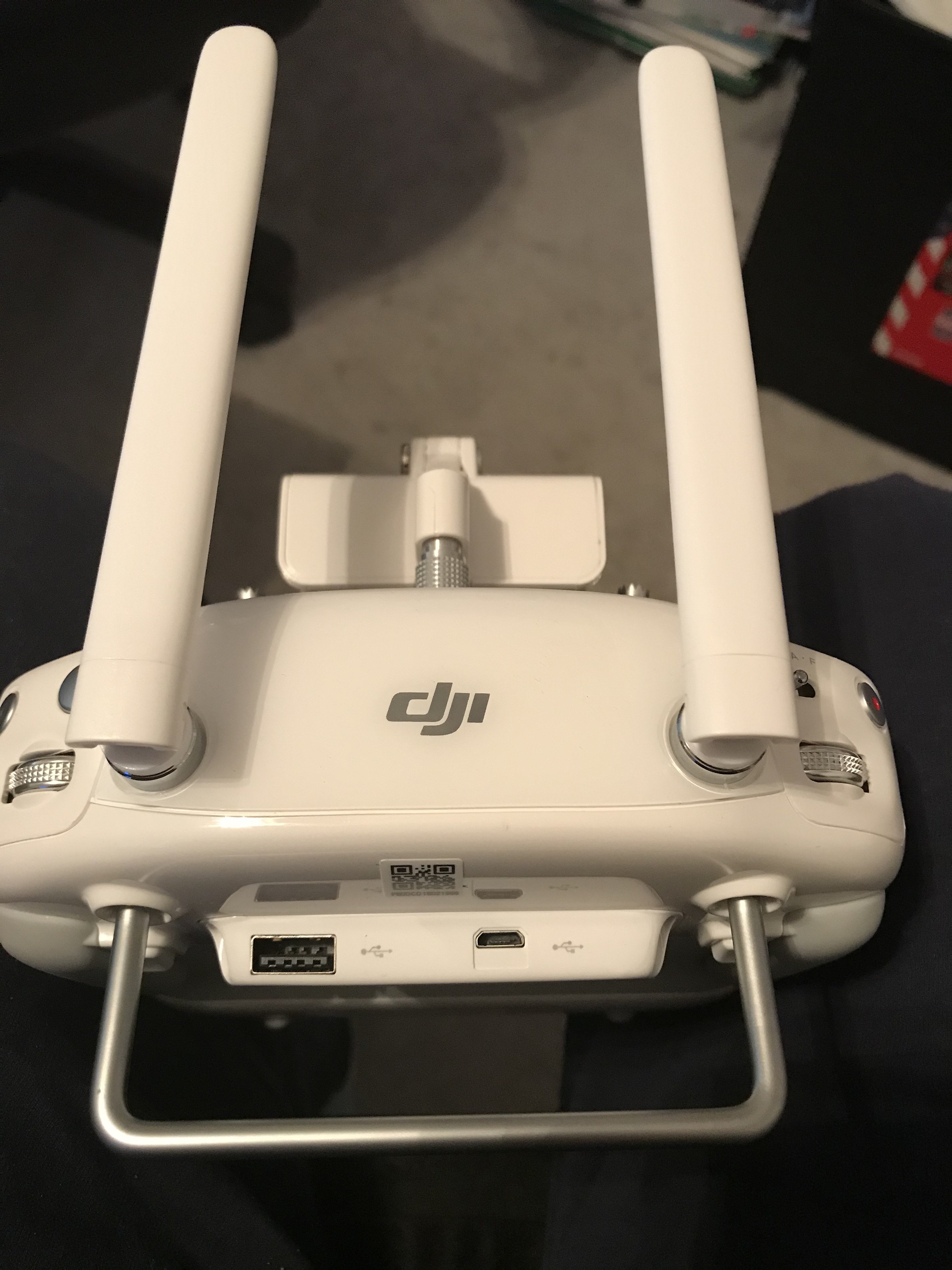

David, moving on that thought I am including a picture of the back of my Controller. You will notice I have two USB slots, the one on the left is what I have been using with a regular USB Charge Cable from the Controller to the iPad. Researching I found a cable on Amazon and it is called: Obeka Compatible 1FT 90 Degree Micro USB to iOS Phone Tablet OTG Data Cable Right Angle Connector Cord. I should receive sometime tomorrow. I will use this from the USB plug on the right which should either be in the right direction or back to square one, on why I don't have proper communications between the Controller and the iPad. Thank you again David for your help. I still plan on researching until I get the cable.
I did see something last night about changing to my original cable. Soon as I finish a chore or two I will try it out and report back.
I tried an OEM Cable for my iPad Mini 3 and I get the same results.
Seems like the cable is a common culprit, though I do see that you've tried different cables. Another common issue IIRC is the USB connector on the RC itself.

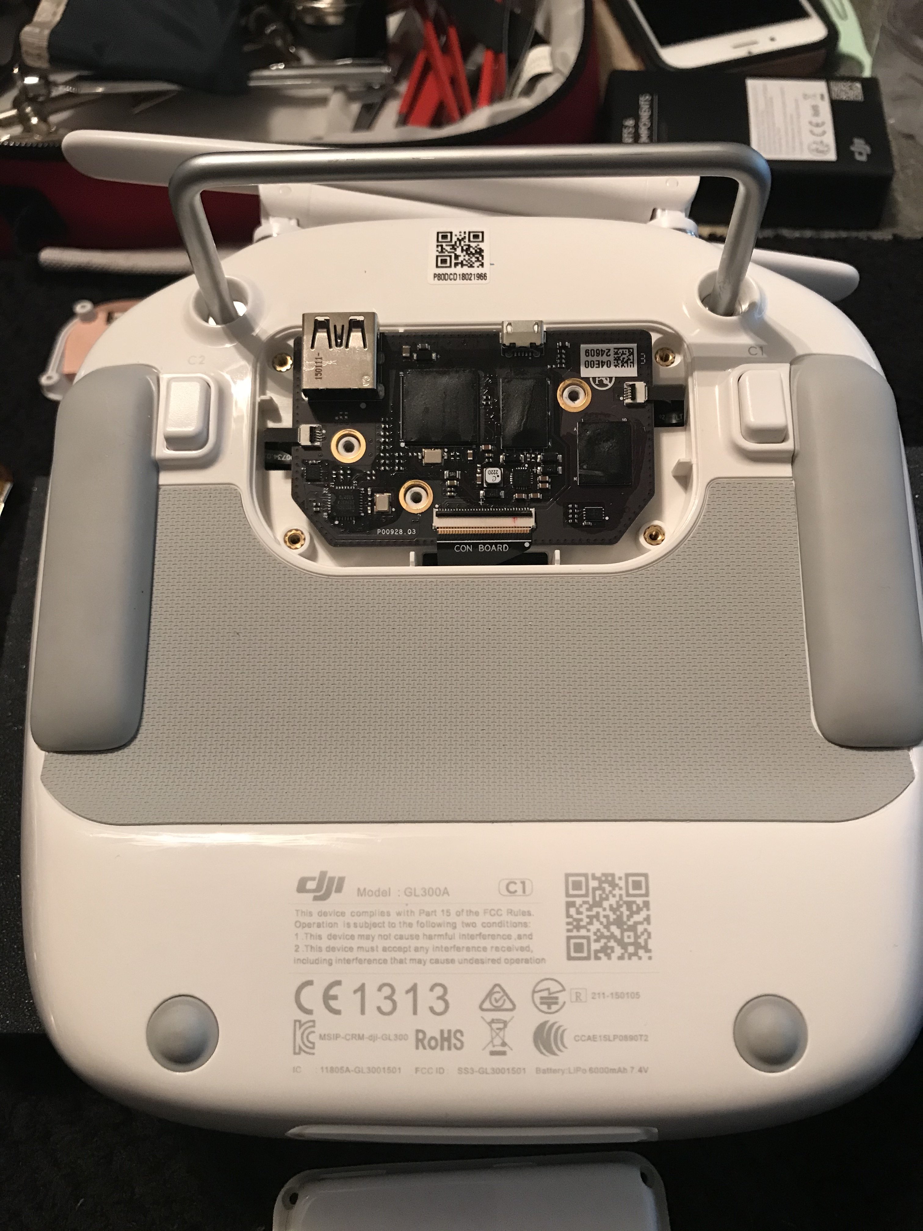

Unfortunately, the micro usb on the right is not a viable port to use when connecting to your mobile device. You’ll need to continue using the one on the left as you have been.
As I noted earlier and as you have no doubt seen many times in your research, the cable is a common issue so you can try a few more.
Also as noted, the USB port on the RC is another weak point. IIRC, especially so with the 300A remotes. Do you happen to have a 300A remote? If so, there are posts here with instructions for fixing the USB board. Of course, adding the HDMI module is something that many have done to get a working USB port but that means spending with no guarantee.
One additional thing to consider is that we have routinely seen people report that their P3s no longer work after some amount of idle time. Even just weeks or months in fact. With yours being 4 years idle, it is sadly not surprising to hear your story. If it worked perfectly, that would be much more surprising. Assuming you get the connection going, keep in mind that other issues, specifically “no image transmission” could be your next obstacle. Just giving you a heads up as a data point with deciding how much to invest. We are all still keeping our fingers crossed that you get going quickly with no additional issues. :)

The main thing I found is that my Controller Model Number is: GL300A. First thing I did was open the back, looked at all the ribbon cables, reseated them by unlocking and moving them in and out, re-locked them down. I also loosened up the board and reseated. Tried to get Controller talking to app to get Camera View to pop up. (No Joy).
I will order the DJI HDMI Output Module Part 54 for the Phantom 3 Pro soon after this post. Being an IT guy at one time before my retirement my gut says you might be on the right track Oso. Biggest thing is my Drone has been boxed for over 4 years and I am thinking once one problem is solved another may creep up, but with the process of elimination my Drone will fly. The HDMI Output Module should be here Friday.

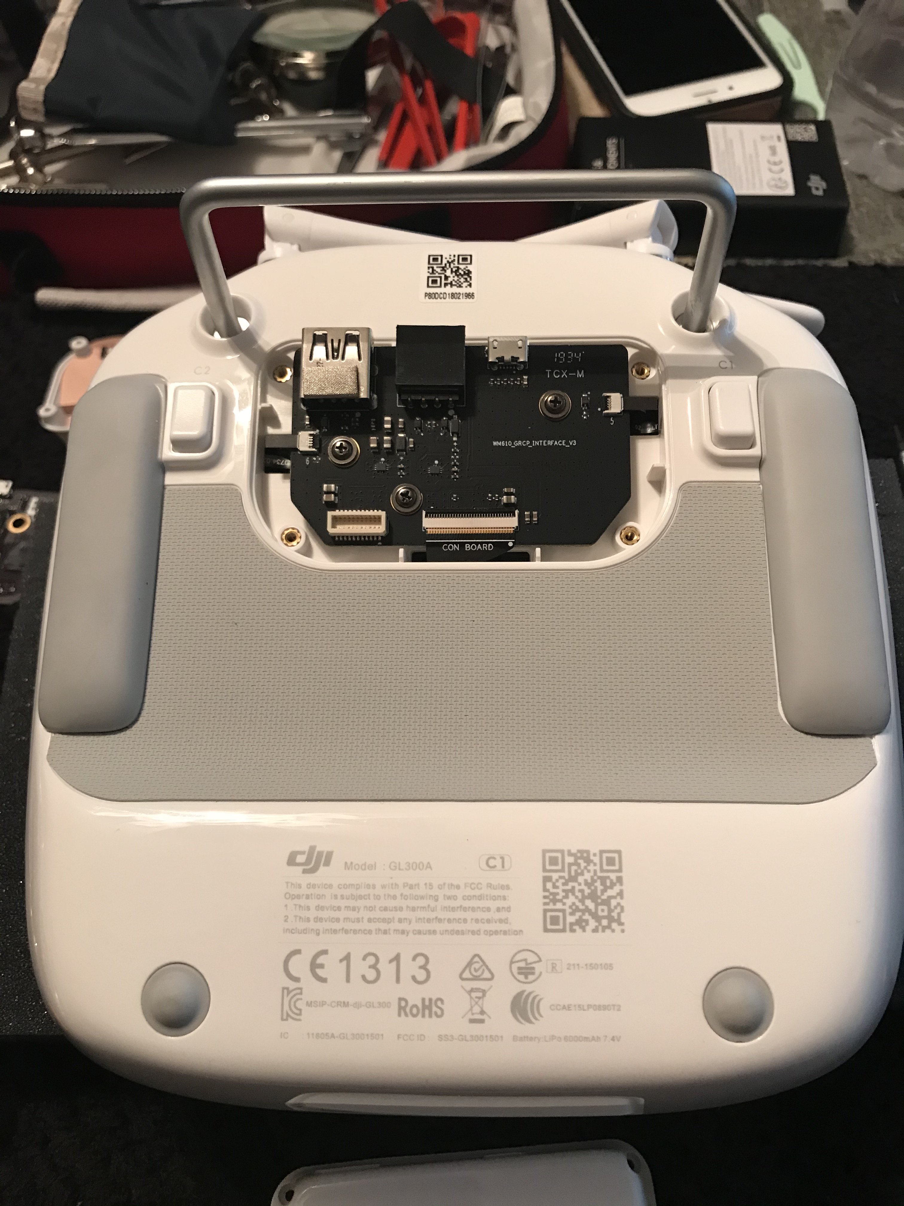

Oso, Here is my update after installation of Module with HDMI Port. I was able to remove and install new module with no difficulty. Only problem I had was my fingers are big so getting bottom ribbon to plug in took some creativity. I took a pair of small needle nose pliers, put a plastic sandwich back over the claws and slowly used those as fingers. The plastic over the pliers was so I did not damage the ribbon. Once all this was done I was able to finally get into activation mode. At the moment while I was activating, I came across the dreaded Error: 800: questionnaire was not found on top of batteries needing charging. I will have to charge batteries before I proceed on. I was able to finally get to a camera screen after skipping the error and as with all things noticed another error: No Image Transmission Signal. As the saying goes "Let The Games Begin".

Making progress. That’s good to hear.
I’m sorry to hear however that you see the exact error I mentioned in an earlier post (no image transmission) that I was afraid you’d see next. Its just so common with P3Ps which have been idle for a while or have overheated from being powered on a long time without a fan.
The next thing I usually ask people is to look at their LOG_AB file to see if modules 8 and 15 show as “device not detected.” That is one of the classic indicators of a bad gimbal top (main) board. There is this troubleshooting flow chart developed by @quaddamage in part due to how common the issue has been over the years.

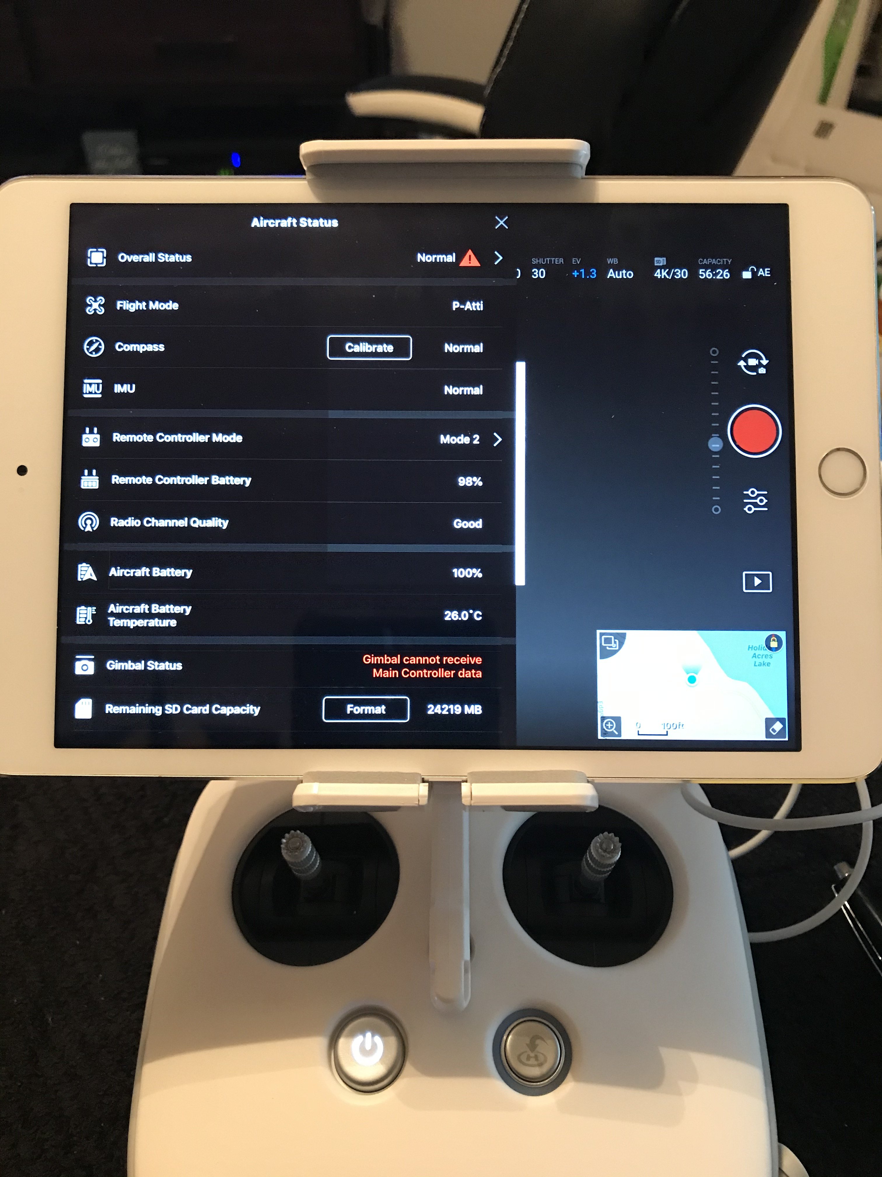

Oso, Batteries are charged. I am still getting error about taking questionnaire. I am still getting the "No Image Transmission" error on screen of the app. I have followed the directions in regards to locating the LOG_AB_file but I do not have any files written on my Micro SD Card. The file location is empty. The only file existing on the Micro SD Card is the Configuration file. I also followed directions in trying to get written again but no luck. I am able to see all hidden files and folders.
I have taken every precaution to not damage my Gimbal and keep it free moving when ever in use. Removed the foam in the back and the plastic guard in front. I noticed that any resistance or overheating could cause the gimbal to display the message. I a able to take video's and pictures while in place. Of course they are dated 1/1/2014.
This is turning into a "Head Scratcher".

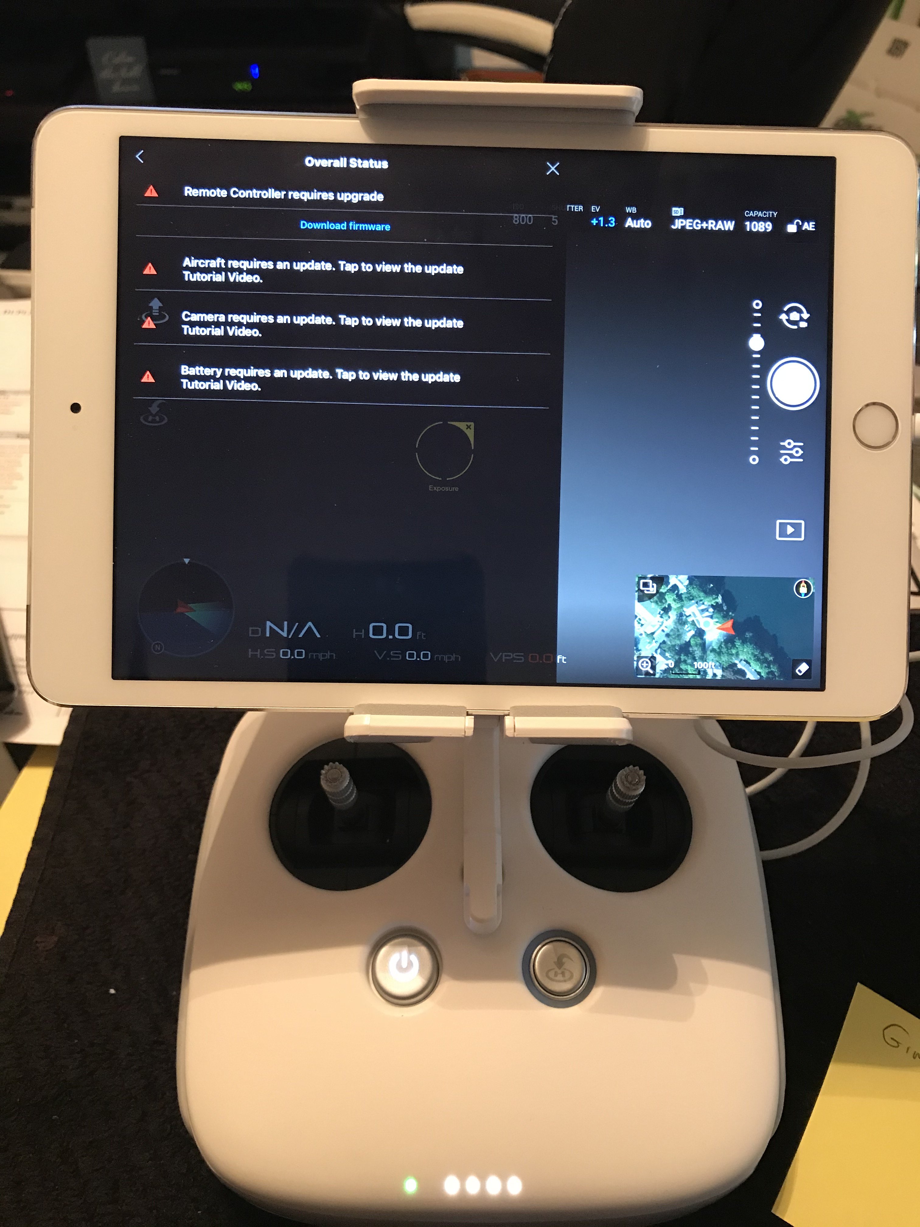

Oso, been doing my homework and decided to venture past screen errors. It seems looking at the two pictures I have something going on, sort of a mini road map of problems. Looking at the first picture it shows Overall Status: Normal with a Red Warning Triangle. Going into the menu we have: Overall Status indicating: Remote Controller requires Upgrade. Download Firmware so: Aircraft requires an update, Camera requires an update, Battery requires an update. I would imagine that once I finish these updates I am wondering if I might be lucky enough to get my camera view back and my drone all normal? My question is this, won;t the latest Firmware update correct all these problems? Thanks
I recall there being some sort of quiz that DJI was having people do with some version of the app. I never updated anything far enough to get it, but it looked like this:
View attachment 115615View attachment 115616
IMHO, I would not update anything until you sort out your current issues. You may be introducing unrelated variables that will be difficult to diagnose. I have never seen the "no image transmission error" fixed with a FW update.
