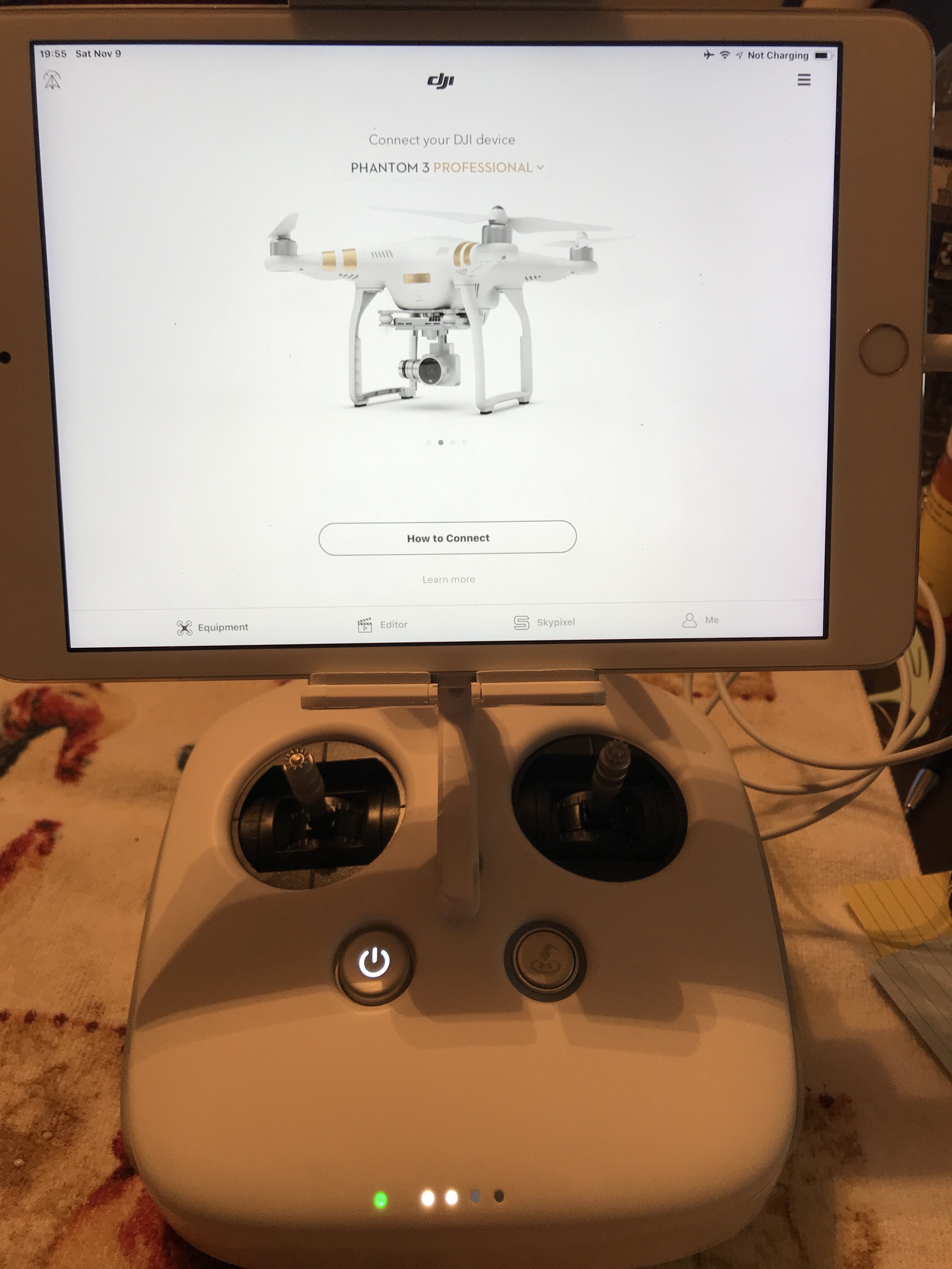

David, the DJI go app does not start on the mini. I cannot run the app by itself. When I run the app it brings me to the selection screen where I select Professional and stays on that screen where it says "How to Connect". It never changes to "Connect" or "Camera View". Far as I can tell I believe there is a link up, but with everything I have tried, might have dropped the link. The Controller does not work with the drone at all, even with the mini removed from the equation.

I tried an OEM Cable for my iPad Mini 3 and I get the same results. The Controller and Drone are reflecting linked with green on Controller and green on Drone. I have the Camera Status Indicator light flashing Red only. Front lights are solid Red, Back lights are flashing slow green. Still unable to bring the app up. I have tried on my iPhone 7 plus with same results. The Controller does not activate or give any indication of starting the motors even when I am not using the app. I will delete the app now and re-install and try and see what happens.

I was thinking it might be the USB Connector on my RC after I saw a few posts and video's, but it seems to give an audible indication when I plug in and it sounds like it wants to launch but nothing happens.

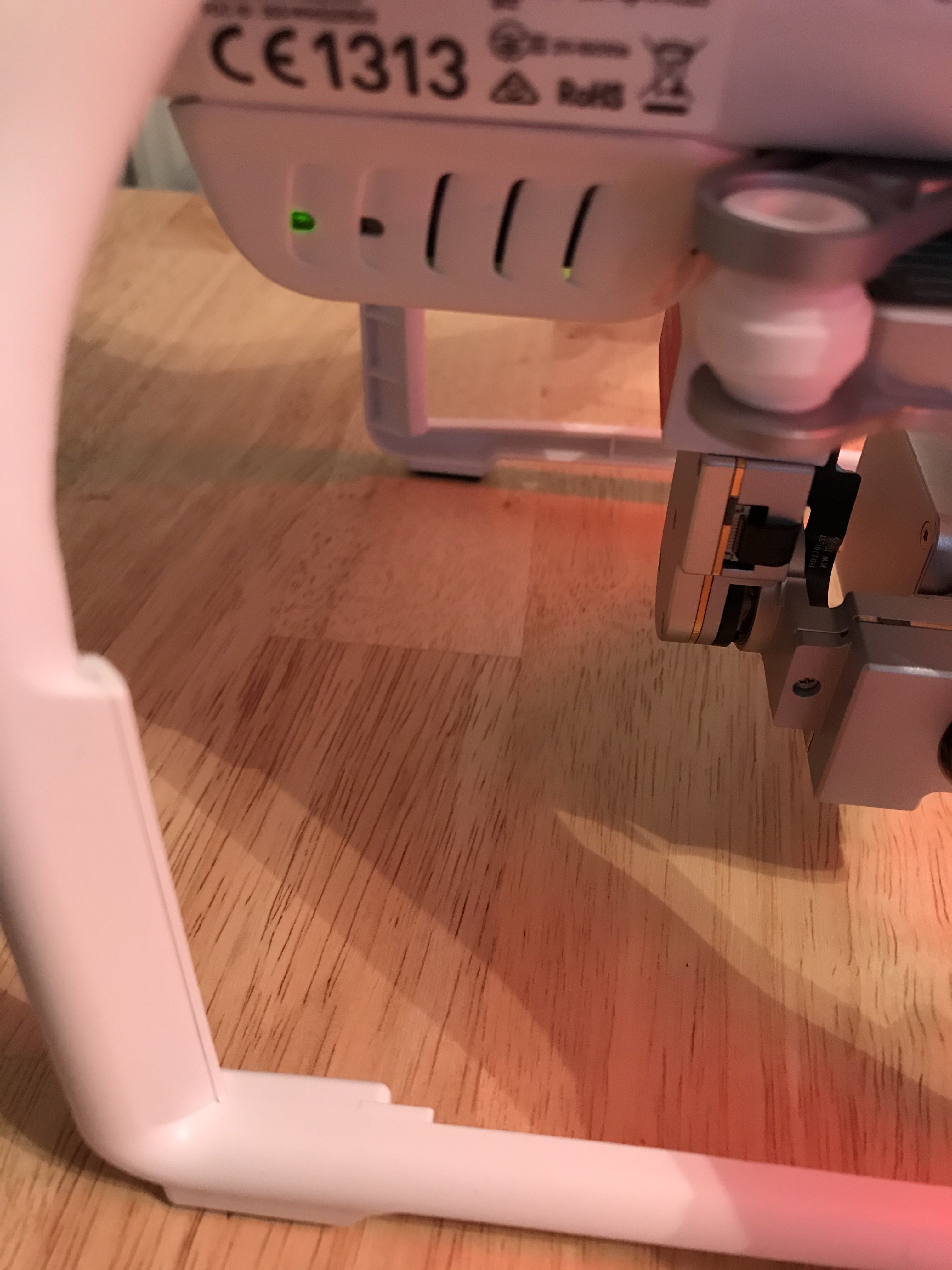

I took my drone outside on my back porch and I had a solid link, showed connection with green flashing lights on the back instead of yellow when I am inside indicating I had GPS Signal and I still only had Gimbal control.
