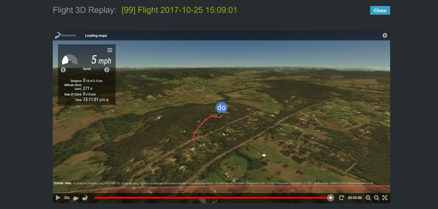

Trying to post flight log here. It opens as Satelite map and Csv file but does not show up when I upload and hit “done”. What am I not doing? Thanks for your help
I’m not sure that’s the situation. I posted that my P4P+ dropped off the sky. Meta4 asked that I post my flight log. I did on 10/25 and no one said anything. I’m not even sure I posted the correct log but no one looked at it. Quite frustrating
Do you mean that you simply uploaded it to PhantomHelp? If so then no one here is going to see it if you don't come back and post a link to that log. You didn't do that.
Yes. Just uploaded to phantomhelp.com. I am not sure how to copy the link because I don’t see one. When I tap done it goes back to this site. Can you point me in right approach please.
Is this it below?
Reactions: Squall Line UAV
As SAR says, there's nothing in the flight log to show whay it fell.
You can see that it started to tumble at 2:25.3 with no indications of a problem before that.
The flight log is good for eliminating all the usual suspects end pilot error and suggests that it is a good case to pass on to DJI for a warranty claim.
