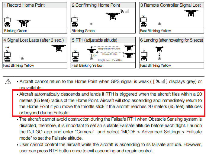

The roof where it landed is at least 25 feet away from the home point.
If you initiate RTH when your Phantom is within 20 meters of the home point, it'll auto land at its current location instead of flying back to the home point and landing.
From the Phantom manual:
I was able to retrive the drone and everything seems okay with the exception of a broken prop.

There is explanation of what happened in 3rd post by @msinger. No mystery. RTH within 20m (60ft) is basically auto land and with roof above your homepoint this is most probable outcome. There is really no need to use RTH when you are 25ft away.
