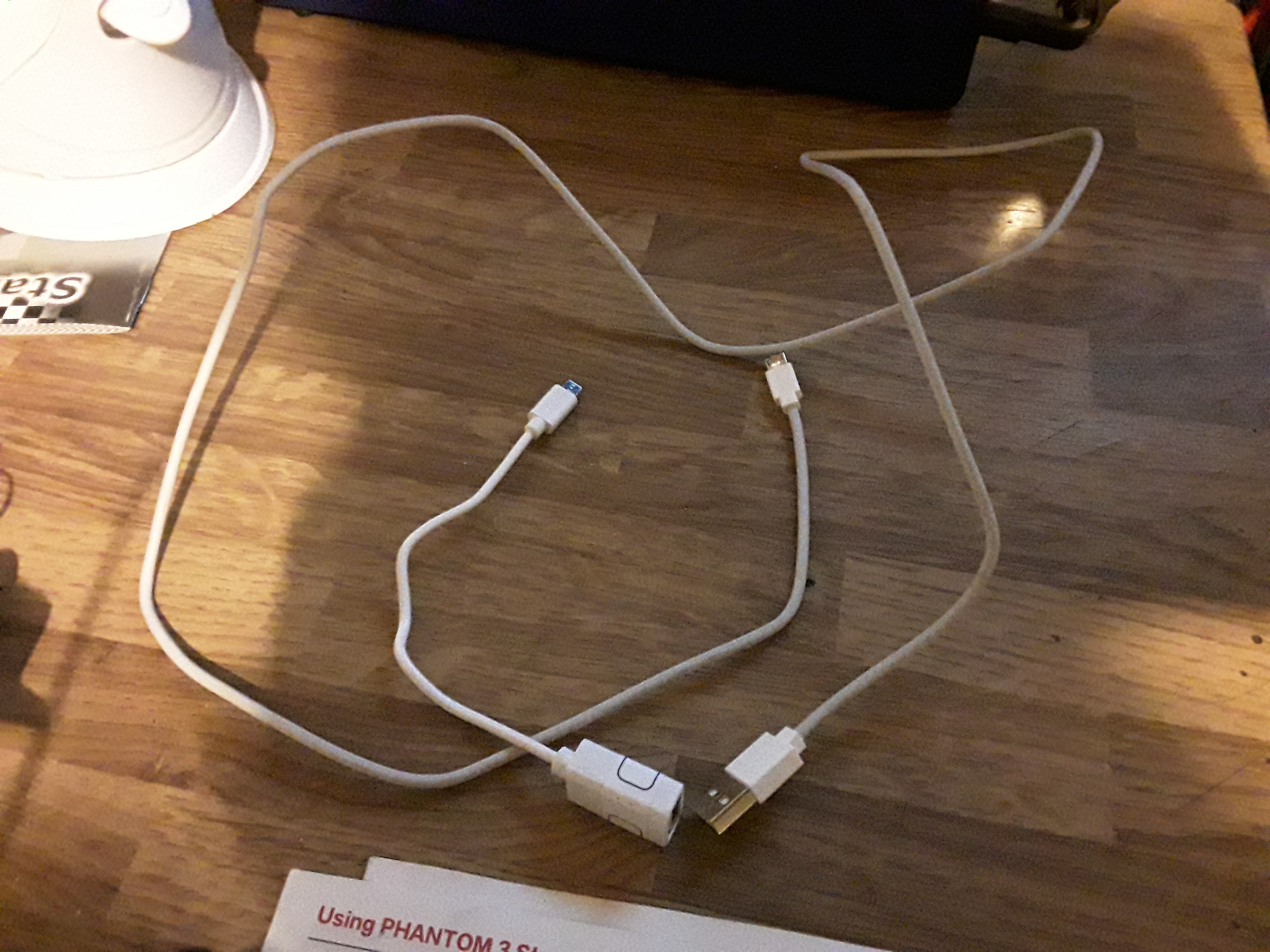

was just reading some posts,red and beeping some say relinking some say firmware,have you tried just plugging usb into drone with OTG cable which should converts mini plug on drone to mini plug on device instead of going to computer and try update remote,do you know which version of firmware installed on remote and drone,once again in general settings at bottom click on "about" and brings up which versions it got

View attachment 93085 View attachment 93084 was just reading some posts,red and beeping some say relinking some say firmware,have you tried just plugging usb into drone with OTG cable which should converts mini plug on drone to mini plug on device instead of going to computer and try update remote,do you know which version of firmware installed on remote and drone,once again in general settings at bottom click on "about" and brings up which versions it got

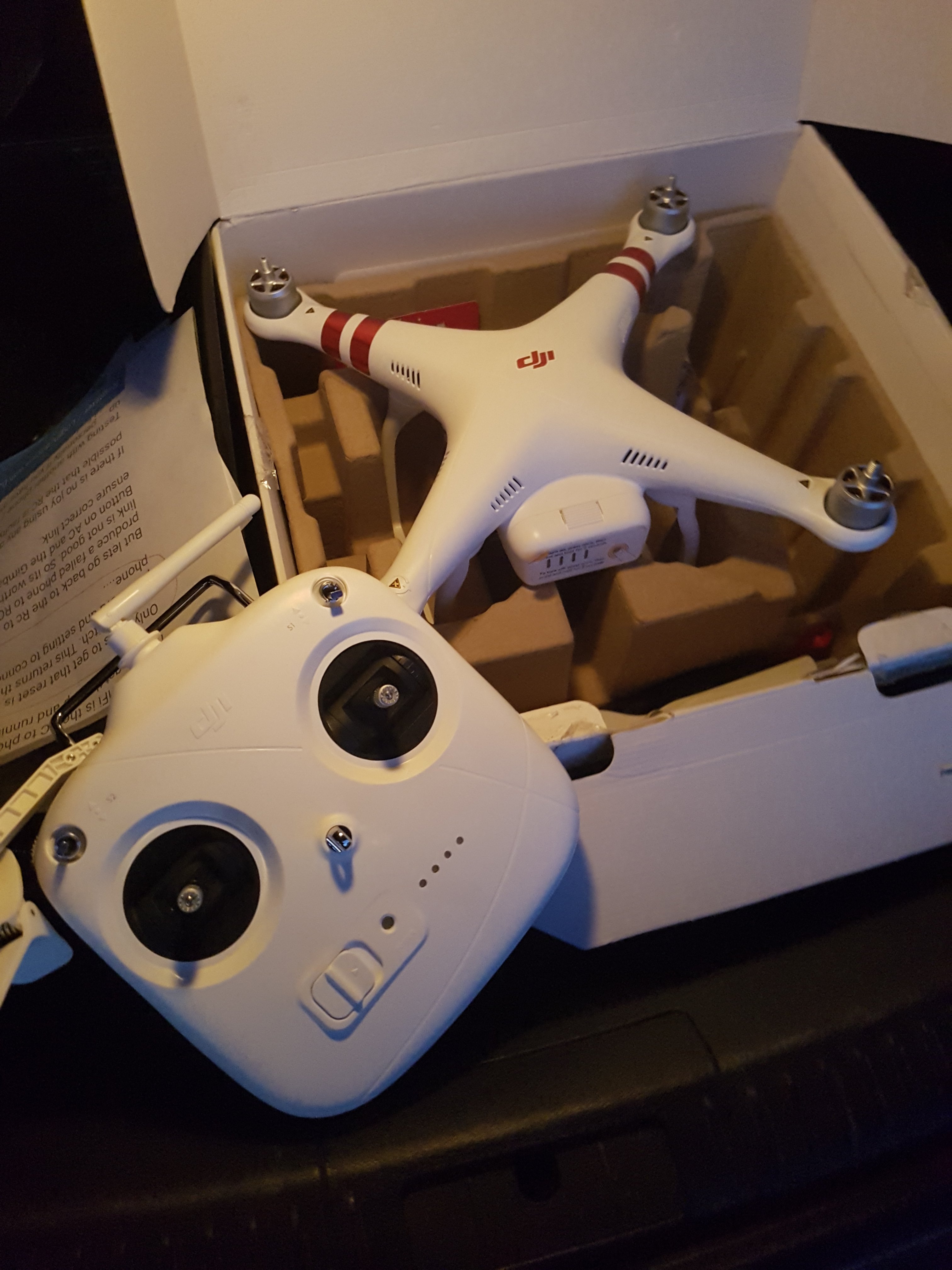

Can you upload video footage or even pics of the remote so we can see you got the right remote. Sounds silly but in a way if this was bought second hand then maybe there is a reason why it was sold in the first place. Upload a pic mate of the controller.

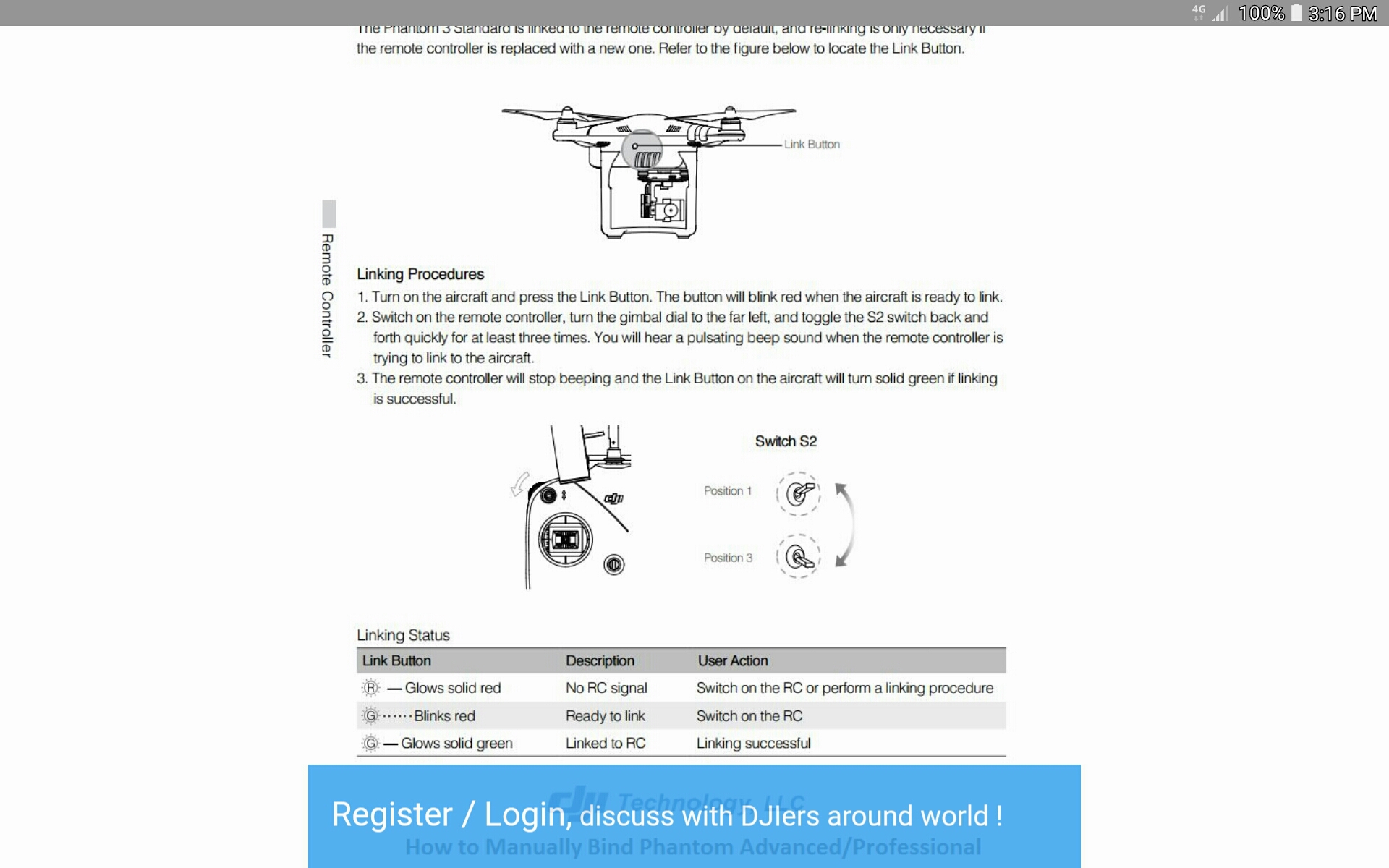

I had same issue as OP and it took me many frustrating hours before I finally tried “re-linking” and voila...it finally linked the controller and drone. Follow the procedure to link the units...no harm if it doesn’t work.

Try a different USB cord yet?
P3S, don't use a USB to the Remote / Mobile.

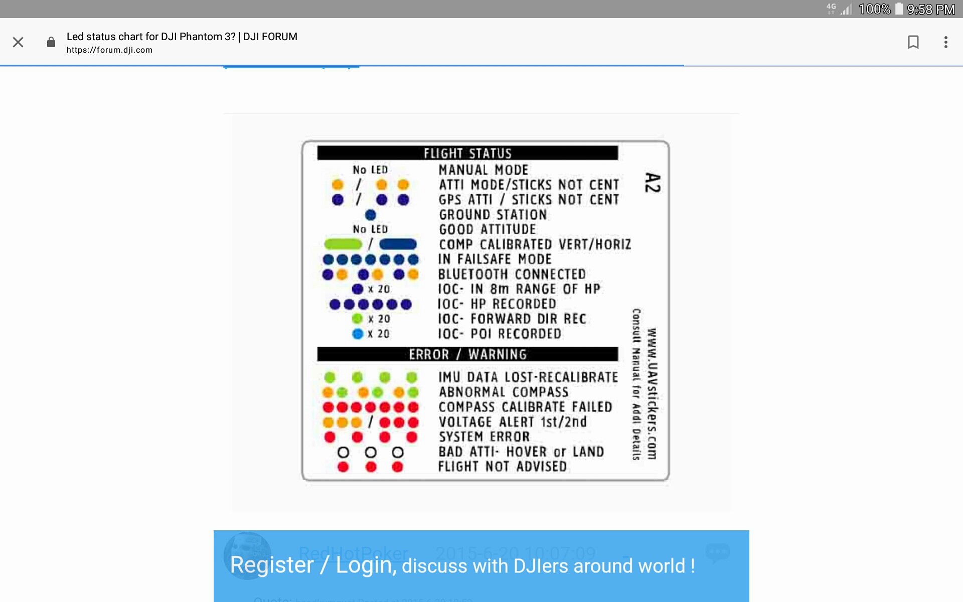

Not sure why @ianzone posted that picture.
Rod
Added: I see now he was talking about firmware to connect the remote directly to the computer, Hum, I would wait on that for now.
