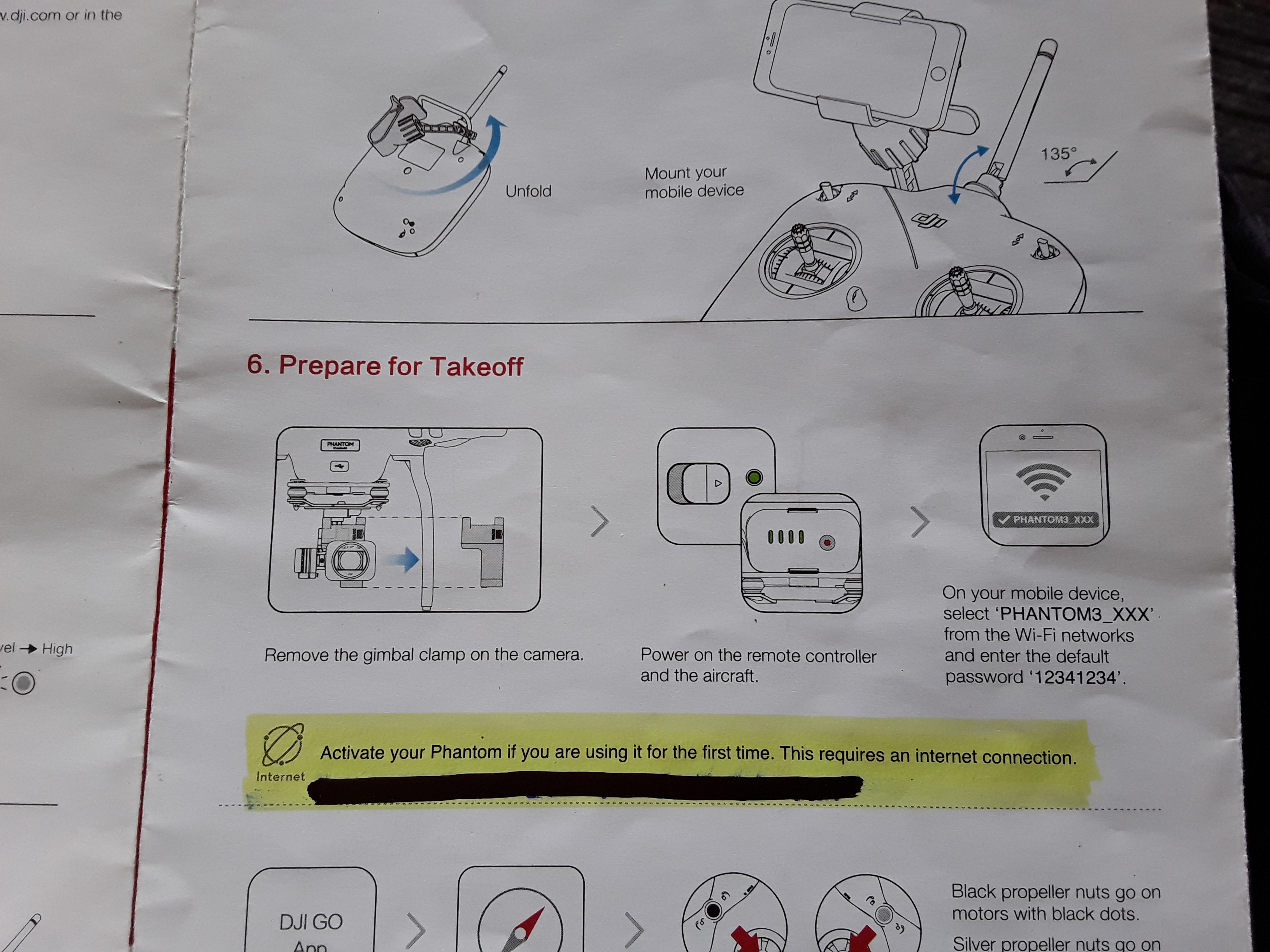

Does you have quick start guide ? Is your device wifi set up and conected with drone ? What does it say when app open at top of screen ..no transmission signal,disconected or,got the how to conect
Reactions: Mark The Droner
P3s is wifi if not set up you won't get it to display,you can fly without device but it's like flying blind,no telemitry or information so pays to set up with your device,make sure your wifi is on with drone and remote on and get wifi to search for it,you might need to enter password 12341234 to make it conect to your device,don't worrie about Internet because it already been activated,,you will also need to get djigo app from playstore
this is quick start guide and there is a free manual you can download for p3s which covers all information

Here's a linking picture,I'm sure in app there a factory restore somewhere,mayby try this linking process
