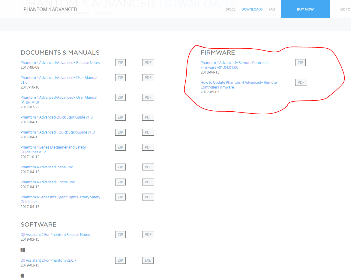

You say this is new, so I just want to make sure you have tried to update the RC correctly from the SD card. If not done from the SD card with the correct file off the DJI site, you won't have the correct Android OS on the controller. You could be correct, no picture could be sw/fw mismatch. I would suggest a redo with the SD card, since as far as I know, that is the only way to change the base Android and therefore the built in DGI Go4 app on it.

Yeah it’s just a grey screen. I’m confused about downloading the file from the DJI website and putting it in the sd card and putting it into the RC, didn’t even know that was a thing.
