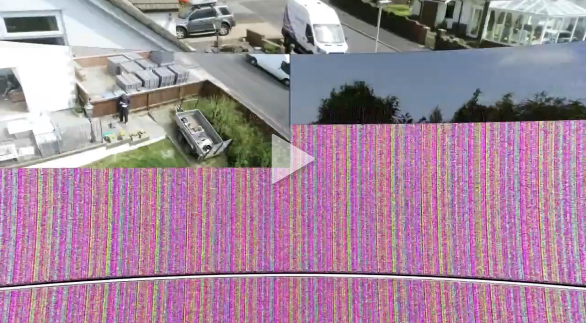

I’ve had my Phantom 4 pro for some time and never had an issue with it although I haven’t used it a huge amount, it’s been stored since I used it last in my wardrobe in its case with the gimbal and propellers covered. On getting out today the video is extremely patchy/glitchy but the camera is perfectly fine when switching to take a still image.

The drone flys fine and does everything it should except the video mode on the camera is as per the image below. Changing settings doesn’t seem to make any difference either. I did see a post on another forum where replacing the ribbon cable between the camera and drone fixed a similar issue but that’s all I’ve managed to find. Has anyone had a similar issue and managed to get it repaired?

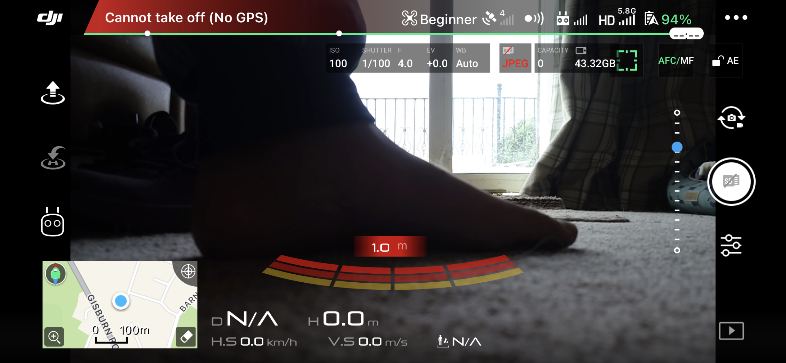

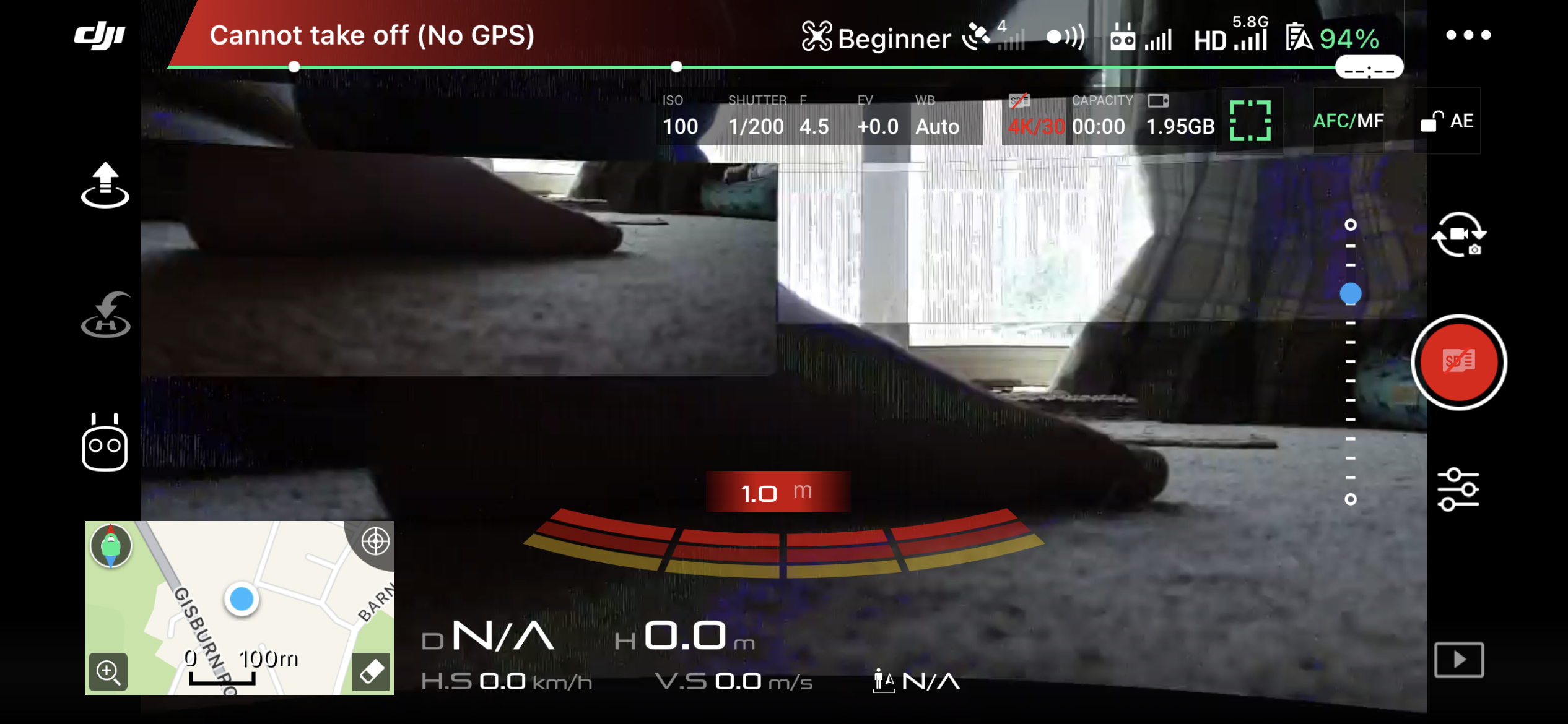

I’ve taken more images and also screen shots of my phone when using it for comparison (apologies for the photos of my foot in advance 😅)
Screenshot from my phone when taking a still:
Followed by a screenshot when on video:

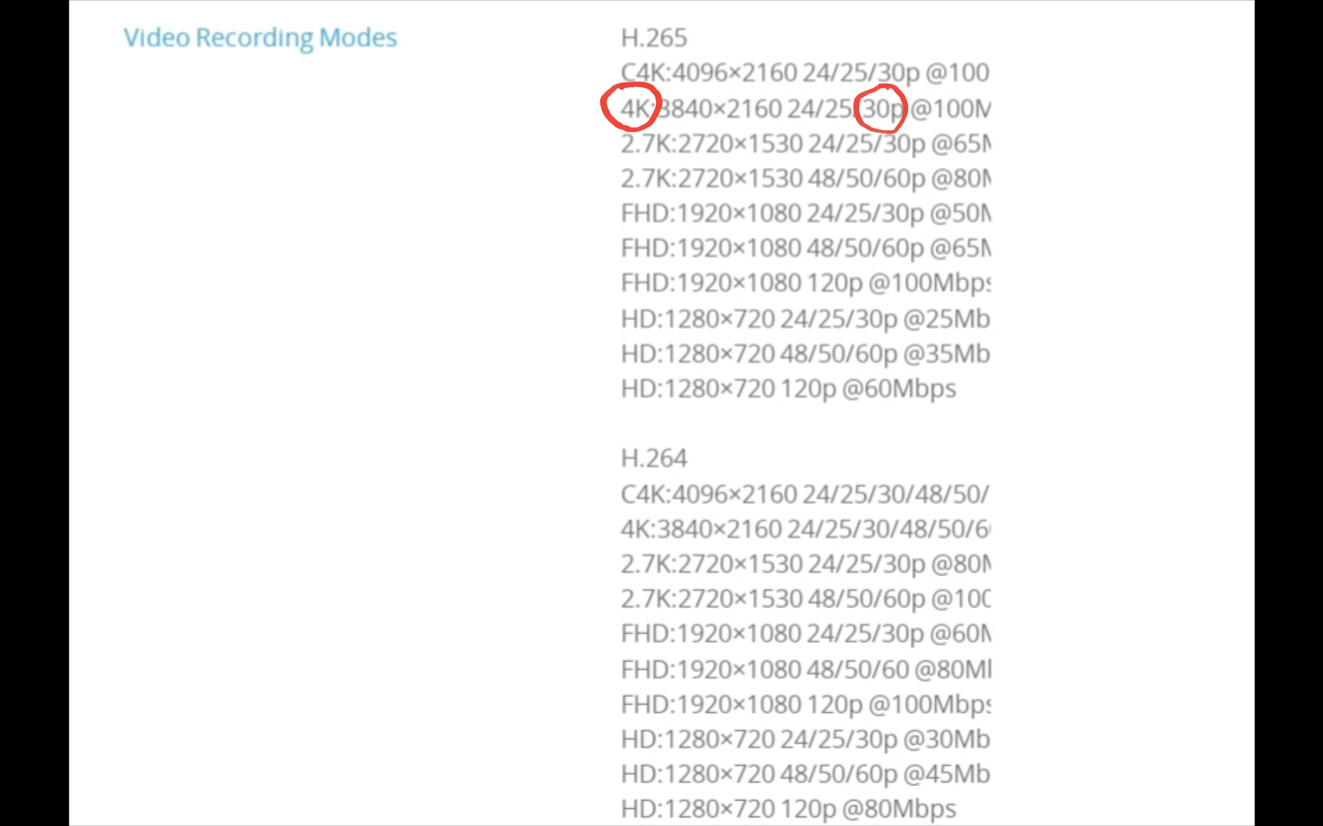

Ah ok,I see your on 4k at 30fps,have you tryed others to see if changes or is that what you refer to in first post where says changing setting,I circle what your current recording is on.

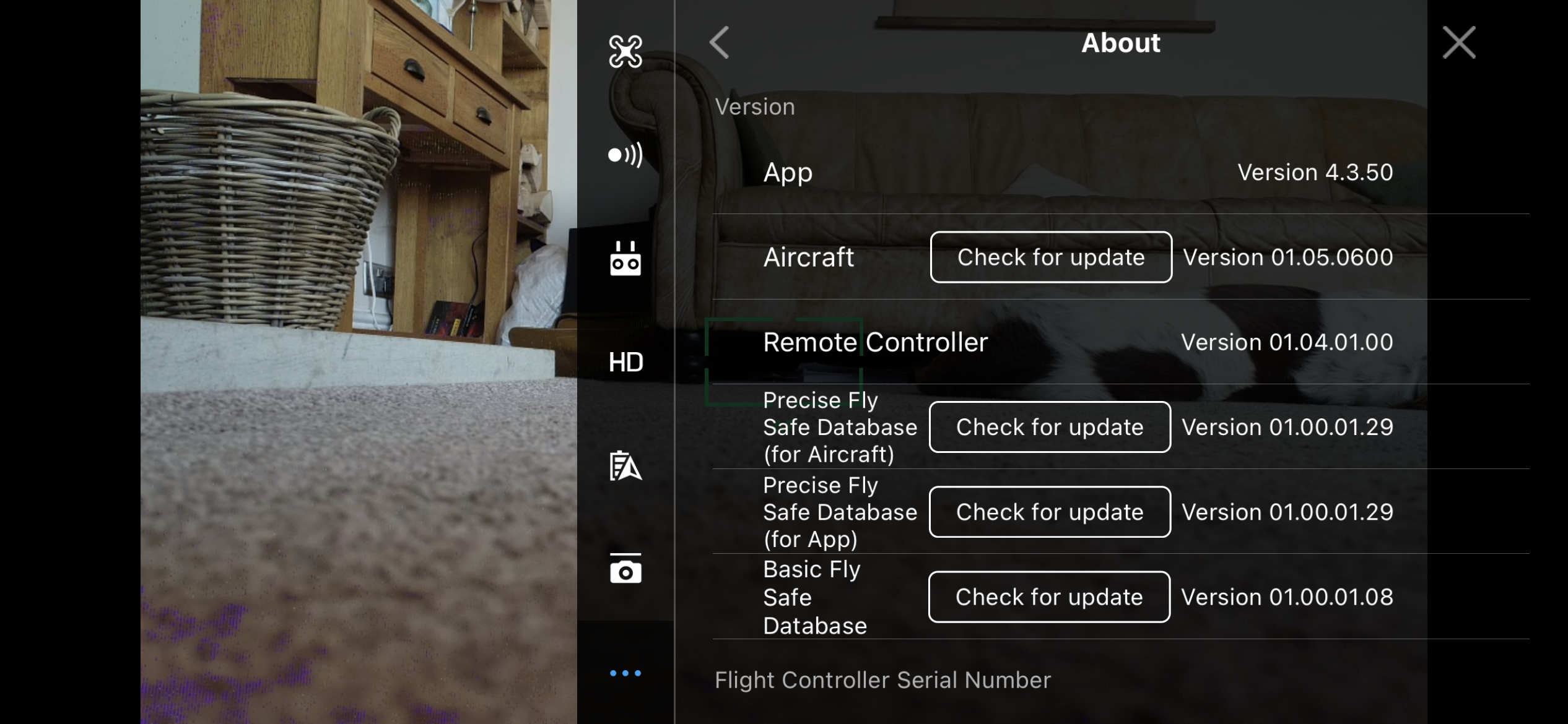

Thanks for all the replies, I’ve tried everything suggested and by altering the settings the problem has improved somewhat but there are still artefacts and glitching between frames when in video mode.
Here’s the versions of all the firmware/software and everything seems upto date.
It’s almost useable in 4k at 25fps when set to PAL.

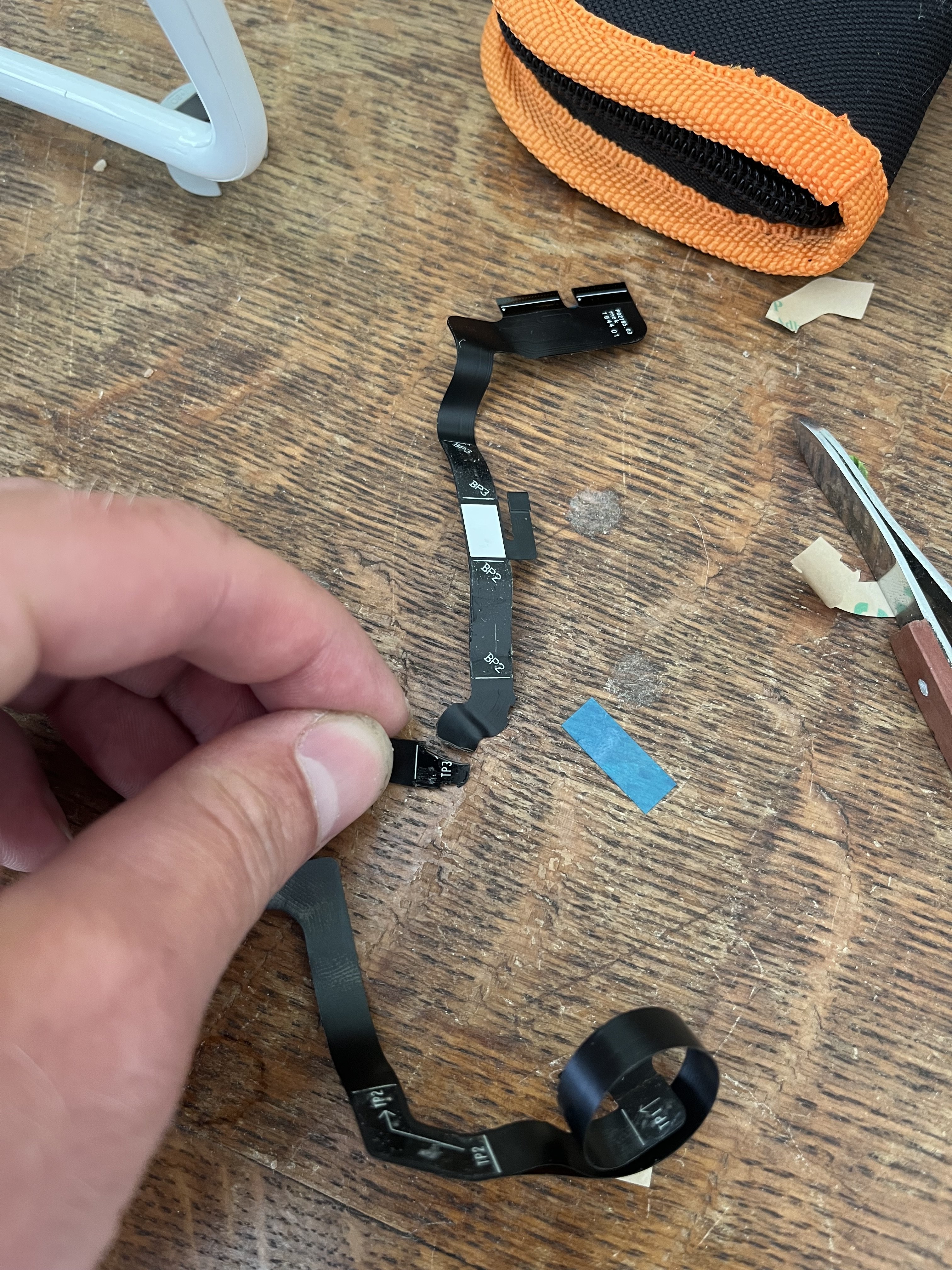

Just wanted to say thanks for all your help, I replaced the ribbon cable this morning and both still images and video appear to be working fine on initial testing.
As I was taking the old cable off the bracket which attaches the gimbal to the drone it tore in my hand where it was attached, must just be wear and tear from the camera moving that caused it to start to break down it probably wouldn’t have been long until I had issues taking photos as well.
