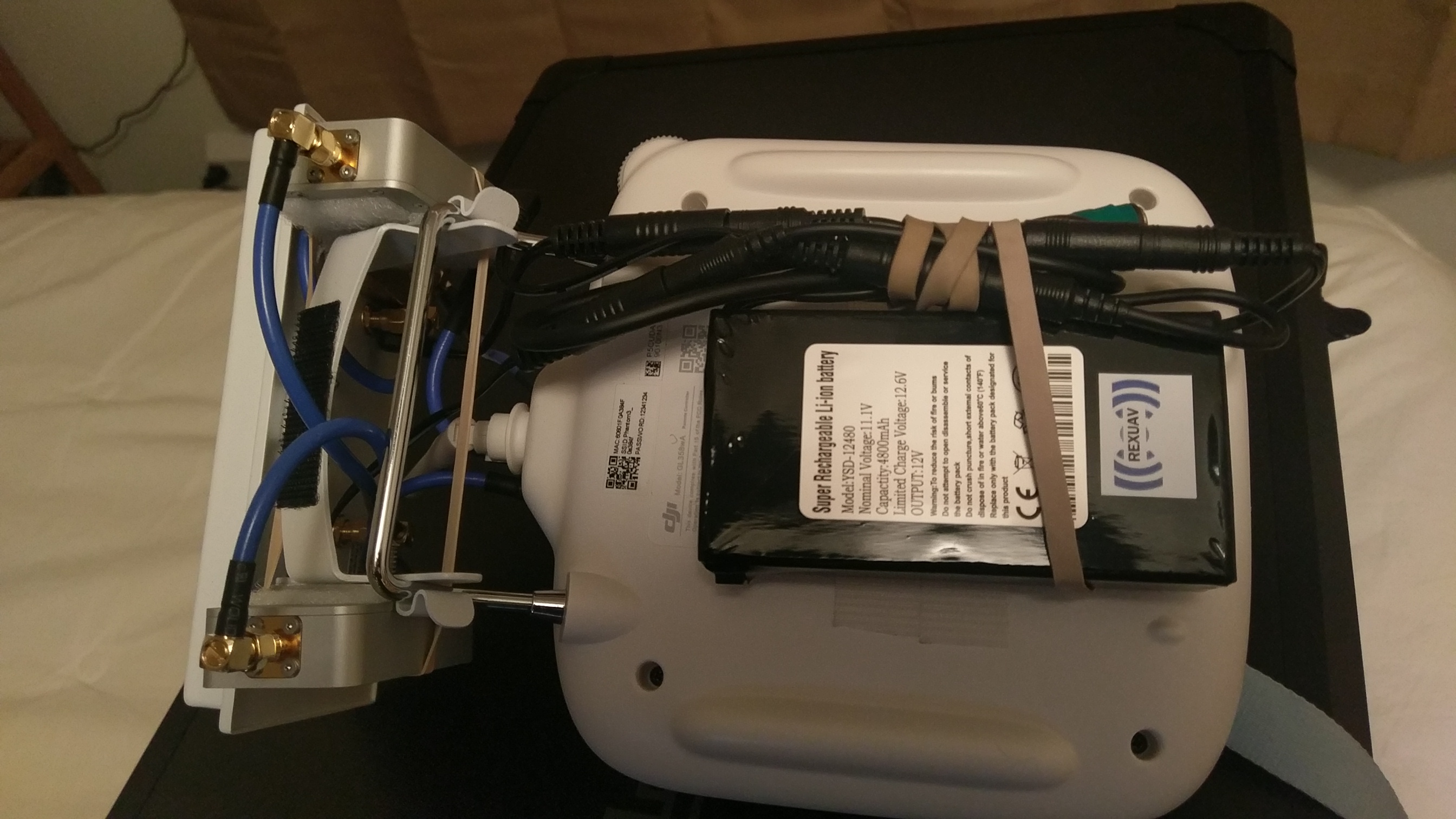

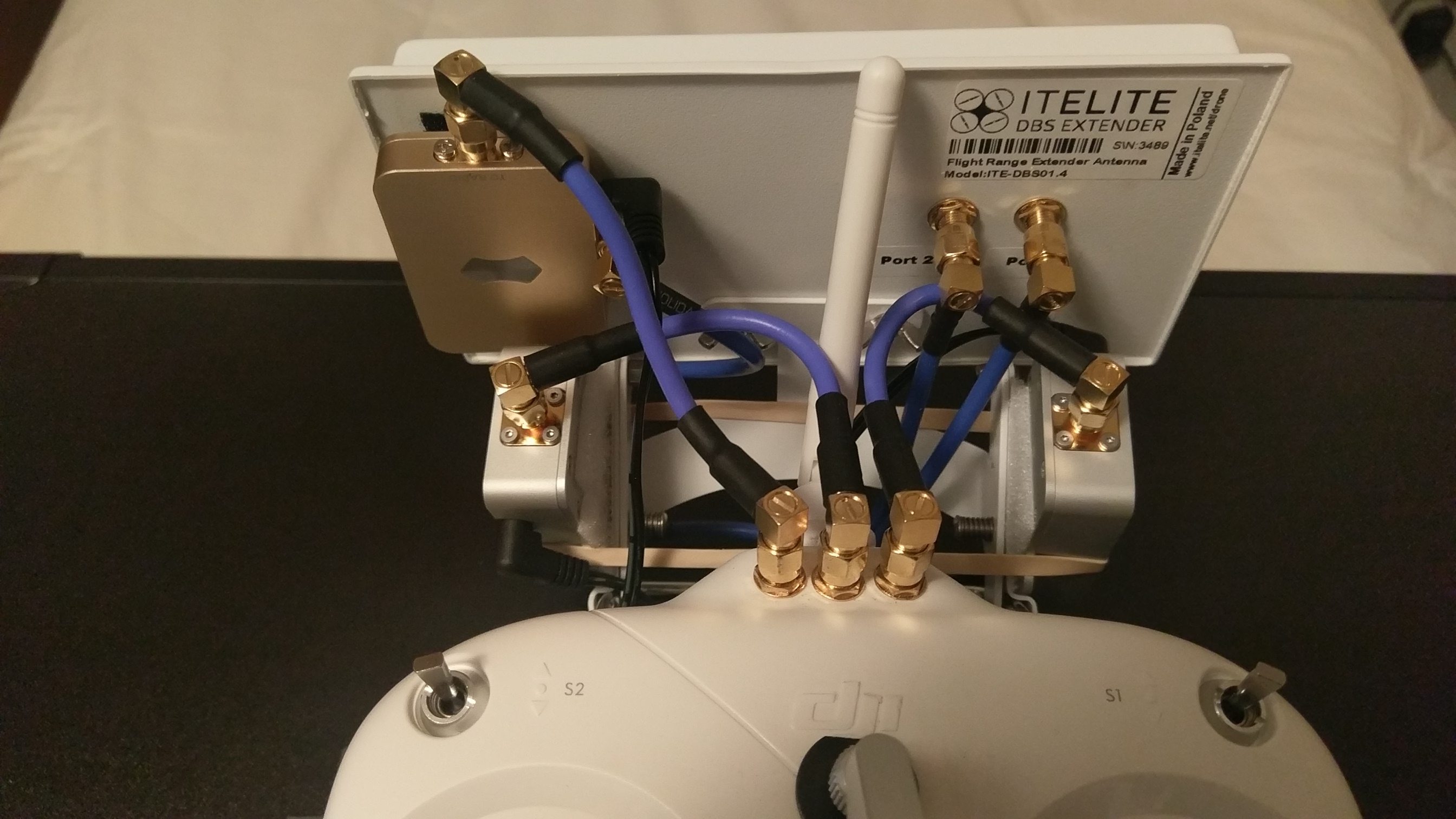

WilliamM i am interested in trying to do some power adds on my Remote could you maybe share some pics of your remote setup or tell me what i need to purchase to get my signal boosted for better signal reception.
My bird always gets compass errors now after update anytime i move it very far from the point i turn the bird on and move it anywhere close to any object . What i mean is i use the back of the truck bed to get ready to go fly or to put up my gear. Or if i am in my car i use the top of the trunk. Now i do realize there are lots of electronics in a car but my vehicles all have compasses on them also. The bird just seems a tad bit sensitive now to changes.
This is indeed very interesting, as we might be onto something here. Anyone else seeing 'more' compass errors after upgrading the firmware?
I'll post some links to the equipment and a picture of mine RC once I get back on my PC. But I would recommend that you fix any underlying issues with your current equipment before doing modifications. In other words it's best to get your setup working as it should being stock with no major issues, before making changes.
https://www.amazon.com/gp/product/B00RX5X36I/ref=oh_aui_detailpage_o08_s01?ie=UTF8&psc=1
https://www.amazon.com/dp/B00N72QWD...UTF8&colid=6X623K85H5BK&coliid=I3U6JI7GYPIDJT
https://www.amazon.com/gp/product/B00Y3ZMREU/ref=oh_aui_detailpage_o07_s00?ie=UTF8&psc=1
https://www.amazon.com/gp/product/B010OSYUXA/ref=oh_aui_detailpage_o01_s00?ie=UTF8&psc=1
If doing three amps. https://www.amazon.com/gp/product/B01JAM6HGO/ref=oh_aui_detailpage_o08_s00?ie=UTF8&psc=1
OR https://www.amazon.com/dp/B017LEHC5...UTF8&colid=6X623K85H5BK&coliid=I33TU5QBG1712J
https://www.amazon.com/dp/B017LHZMA...UTF8&colid=6X623K85H5BK&coliid=I1OHPXXBRNTVM2
If you go with all Gold amps you can use a USB battery pack 5 volt, instead of the 12 volt supply.
