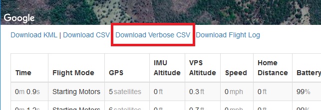

I just made a change that will also make the TXTlogToCSV CSV file available (only for flight logs uploaded in the future). Click the "Download Verbose CSV" link to download that CSV file.

Thanks Mike - an online version of that converter is going to be very useful.

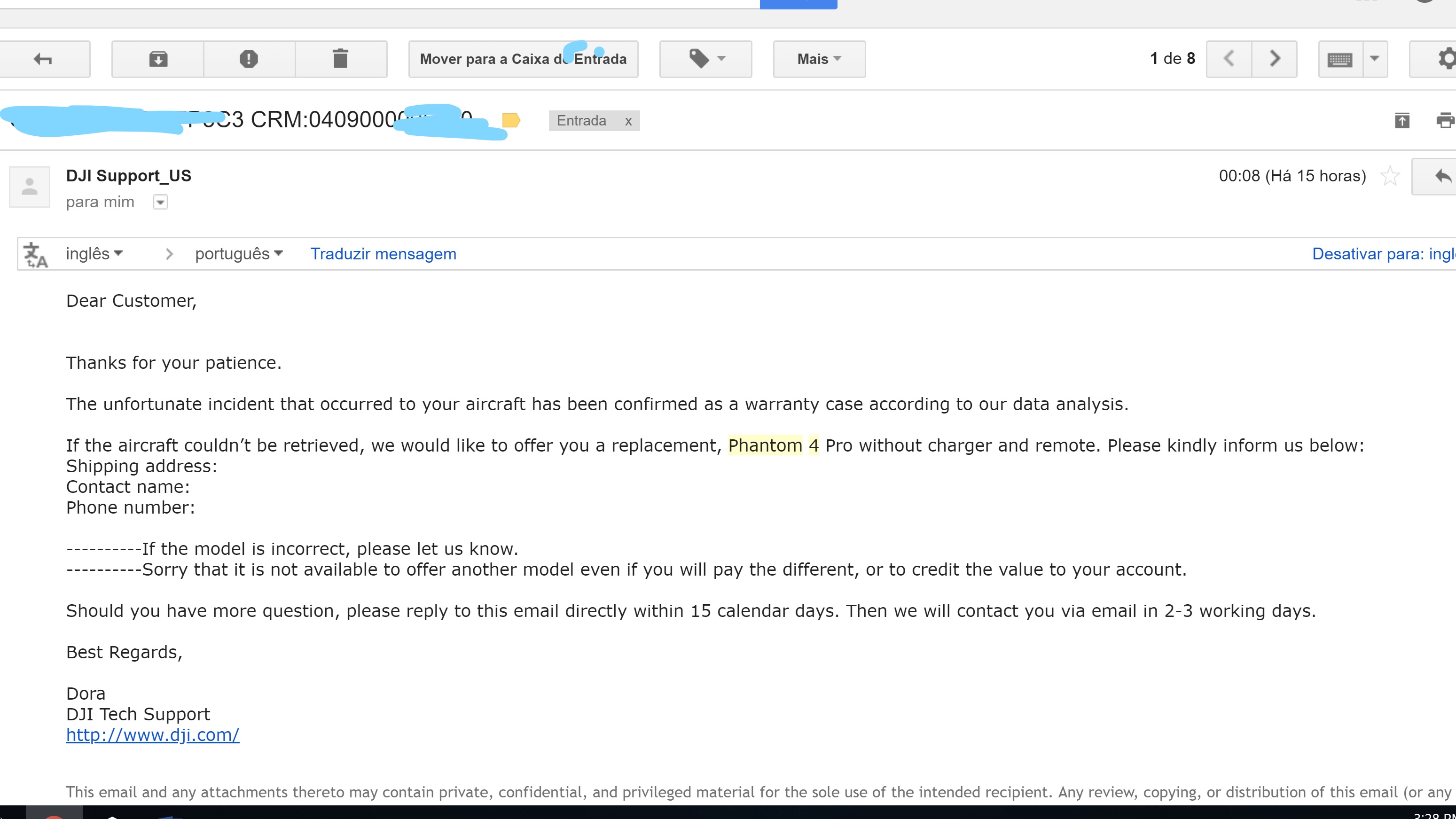

Hello everyone.
Thanks all for the responses.
As I said in my first post in this thread, it was not my mistake. The drone just showed some weird compass error and flew away.
It seems DJI agreed with me since after reviewing the data, they decided to give me a new one.
If I had listen to some and not opened a case as "it was clearly a pilot's mistake" I would have lost 1500 bucks.
So, the tip of the day is: Do respect the more experienced pilots on the threads, but dont give up on something you know you are not wrong.

Good outcome. That's very nice of them, especially since the cause of the incident was clearly the inability to pilot it in ATTI mode. Also unusual for them to provide a free replacement without the original returned to them. 30% discount generally seems to be the best they offer in those situations. No explanation of what they think happened, unfortunately.

It's certainly a win for the OP, but you are completely clueless, as usual.
That is just ridiculous.
Of course the incident wasnt the pilot's fault. If that was the case, DJI would clearly not replace it as it will.
I have no idea why you insist on the theory it was the pilot's inability to fly ATTI mode even after I (the pilot) have stated that the right stick was not responding to my commands after the drone turned to ATTI.
Believe me, DJI is as far from a charitable institution as it gets. THEY WOULD NEVER REPLACE MY DRONE IF THEY WERE NOT SURE IT WAS NOT the PILOT'S MISTAKE.

There were no right stick inputs recorded. I've combed through more than enough logs in these kind of events to have discovered that they end up almost universally correct. Yes - it's possible that this was a failure mode that hasn't been posted here before, but I doubt that. And that is the data that DJI will have looked at too.
There have been a number of occasional cases reported where DJI apparently randomly replaces aircraft when normally they would not - just like there have been numerous cases where they have initially refused when clearly they should have replaced, until the pilot pursued them to look closer at the data. They are not perfectly consistent at all. But I guess it's kind of inevitable that DJI suddenly rise to the level of infallibility when it agrees with your position, while they are regularly lambasted as incompetent and unfair when they take the opposite position.
