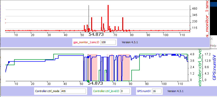

OK...I got the txt file and looked through it and can see where it switches to ATTI mode but I don't understand why or better said is I don't understand the error that makes it switch. Google is my friend ...but for now I will show a pic of the data....

The error message says there's a GPS data error.
The flight controller is rejecting the GPS data.
It might be that there's a problem with the hardware?
If you post a link to the Phantomhelp report it will allow digging a little deeper into the data than a picture of a tiny part does.

There is a field, SMC, in the GPS monitor record. Usually it's value is close to 80.0. But, in this .DAT the value exceeds 180 which then coincides with the switch to ATTI.
When SMC (top red curve) departs from 80 the satellite count (bottom blue curve) drops to 0 and the FC's confidence in the location solution (bottom green curve) drops to 0. Shortly thereafter the switch to ATTI occurs (bottom pink background). Don't know what SMC is but almost certainly a HW error is occurring as suggested by @Meta4

Thank you for your analyses and comments. I hope someone else can elaborate more. I need to understand which part of the hardware has malfunctioned and if I can replace it. I may just have to put it on ebay as a parts drone.
You might want to open it up and check the connections to the GPS receiver. After that try replacing the GPS receiver. Here is a YouTube
