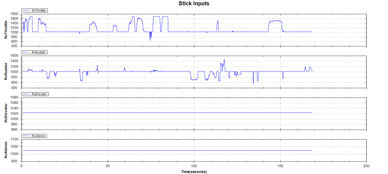

As @Meta4 pointed out above, there were no pitch and roll commands ( Right Stick ) issued by you according to the log file for the entire flight. Also as was mentioned, the RTH button is useless once switched to ATTI.
So in taking your word at the fact that you "issued" right stick commands, this would be one of two issues ( Of which I have never personally seen ) Either two receiver channels on the aircraft failed, or the same applies to the RC. Below is is a full graph of the RC inputs to the aircraft for the duration of the log. Notice the last two remain at zero movement. This is really here nor there in relation to the incident, but to throw out one thing, you took off well before the home point was set. You were already at ~12 meters when it updated.

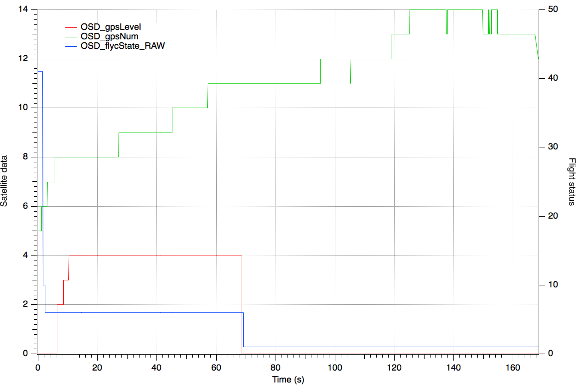

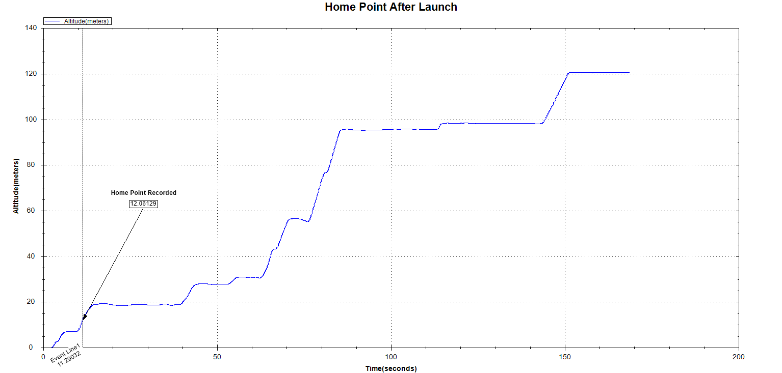

launching with anything other than a fix from a dozen satellites on the GPS is risky.
This is not necessarily a problem and in some locations it is the only way you can fly.
If the launch point skyview is blocked by trees, terrain or buildings, it might be necessary to launch in atti mode and climb to clear the obstructions and get a good GPS signal.
The Phantom will record a homepoint when it gets GPS.
That appears to have been the situation in this case.

Reading with interest, out of curiosity those two ‘flat line’ stick input graphs appear remarkably ‘flat’. I’ve no experience in reading these to be clear, I’m just asking, is that normal? Looking at the two graphs above these there appears to be what I’m guessing is ‘normal’ human movement of the sticks. I realise they may just not have been moved, but is that typical?

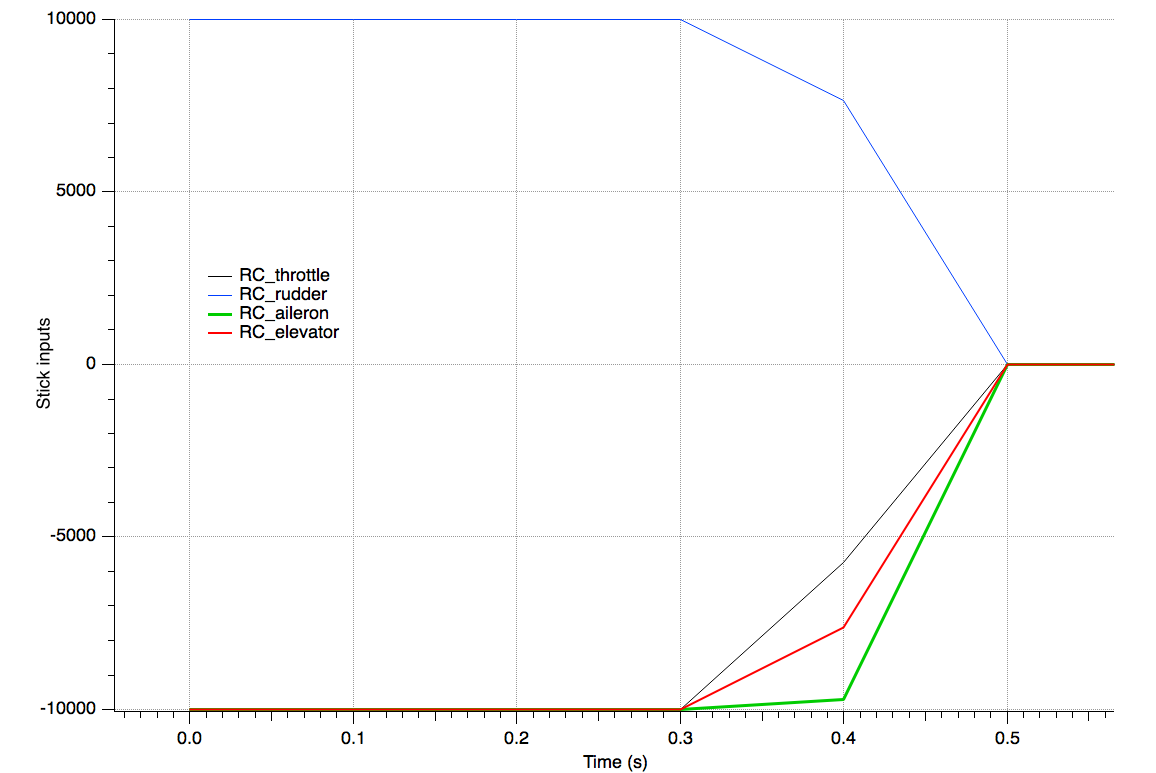

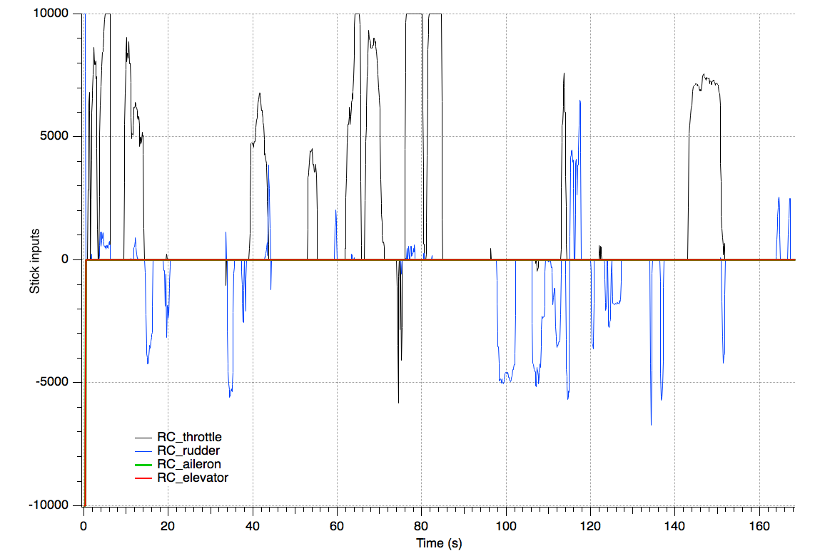

Unfortunately the observations above are correct. The aircraft switched to ATTI mode due to a yaw error. The winds were not excessive (10 - 15 mph above tree level) but will have caused the aircraft to drift.
But your recollection appears to be incorrect - you made no inputs to the elevator or aileron sticks after takeoff:
The suggestion that the RC may have been faulty is not the explanation for that, since you used the CSC to start the motors, as is visible at the start of the record:
Both elevator and aileron were registering full scale at startup, indicating that they were working properly.
Good point. My question is @sar104 is why you do not see this in the .csv from Phantom Pilots? Quite honestly, I didn't see this until I used the offline converter. All of the right stick inputs in the Phantom Pilots conversion are at Zero from start to finish. Is this a sample rate thing in the conversion?
