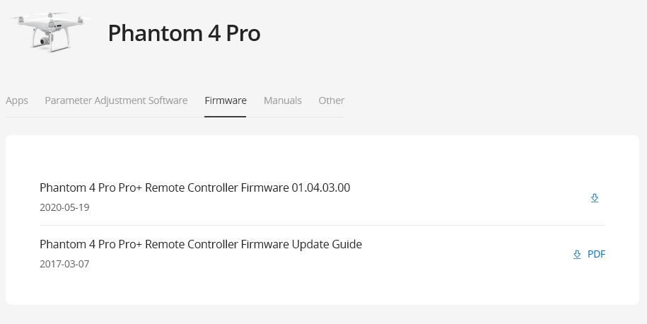

Link to Firmware 1.04.03 update - GL300E_v1430_20200519 Click "Firmware" at the top of the screen
Download the file. Then extract the firmware package, and copy the extracted file (GL300E_RC_xxx.bin) to a freshly formatted Micro SD card.
Link to "Update.zip" file - Phantom 4 Pro Plus (GL300E) Update.zip file
Download the file. Then DO NOT, repeat DO NOT extract files. Copy the Update.zip file directly to the same Micro SD card.

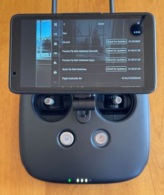

With fingers crossed. You may now have the latest DJI Go 4 software for V1 4.3.54, latest 1.04.03 firmware, and maps.

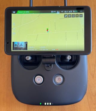

OpenStreetMap (opposed to MapBox) is what I'm seeing onscreen for DJI's new maps provider.
Very happy to have this controller up and running. I forgot how bright and crisp the screen is.

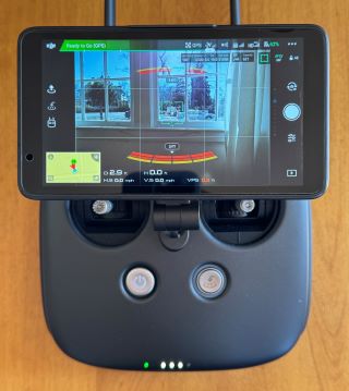

View attachment 126321 View attachment 126322 View attachment 126323
