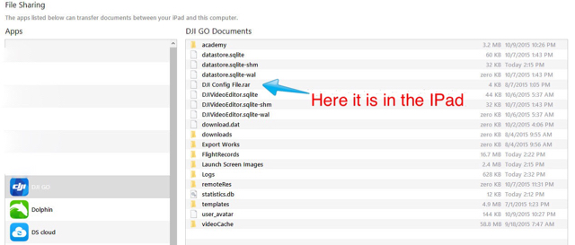

I appreciate your help. I'm pretty sure I followed the directions to the letter. Pretty easy instructions . I've taken a screen shot of the dji directory within my iPad. I see the file there yet still no channels

its a rar file has to be unzipped

You didn't unzip the file. You need to extract, and then add the single file with the leading "."

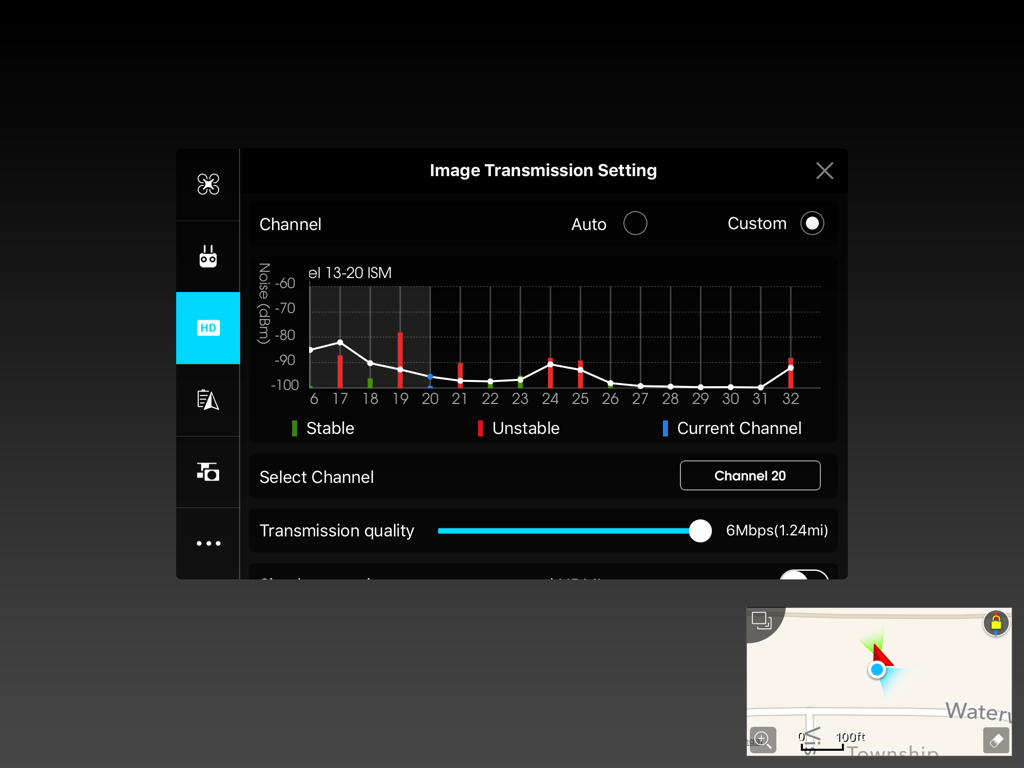

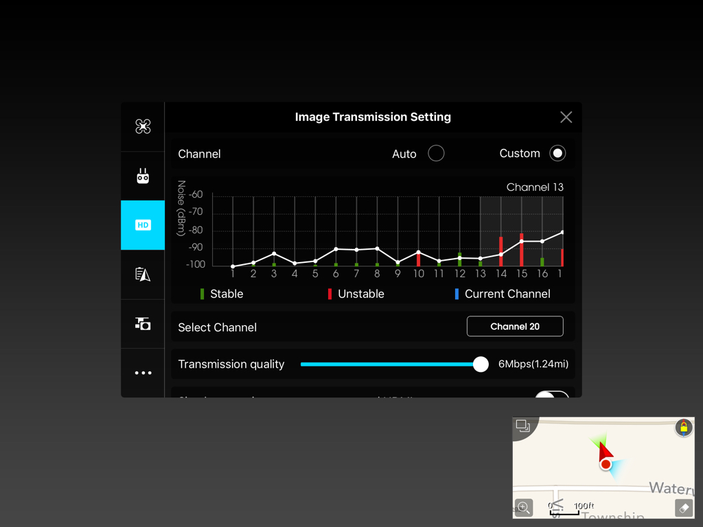

Feeling pretty stupid guys. Sorry and thanks for your help. I can see the channels now. Will have to test it tomorrow. I was surprised to see activity on channel 32 in my area.
Happy to help sir.
I'm also surprised to see activity on 32. Everything from around 28 and higher has always been flatlined in my area, so when I see your picture showing activity it looks odd to me.
