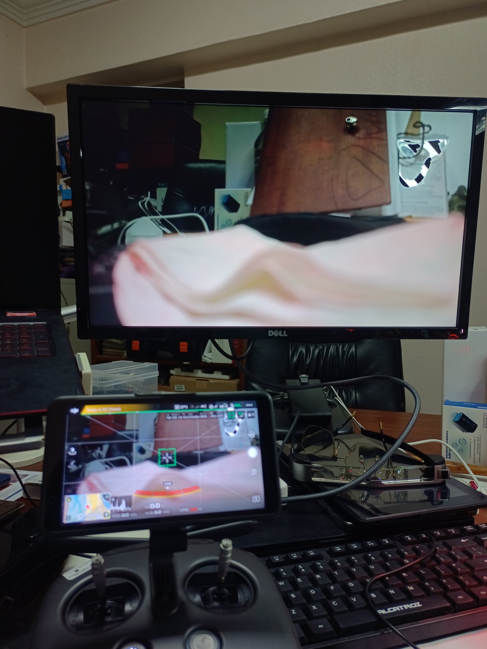

I recently got my Moverio BT-30E/35E and connected it to my Phantom 4 Pro +(built in screen; V1) with a high resolution HDMI cable (1.8K@60Hz, 2.4K @120Hz,3.10K @60Hz). I find the P4P+ controller ( GL300E) does not mirror the output from the HDMI port to the BT-30E/ 35E glasses. The telemetry and other details are missing in the Movario glasses. I later connected the controller to an external HDMI monitor and notice the same problem. See picture attached. I also find the HDMI output also do no show the DJI GO4 welcome screen and connects direct to the camera output without the telemetry. Any settings to be done on the RC/ Movario?
I shall check if the BT 30E can be powered from the USB port of the RC. Thanks for the information.

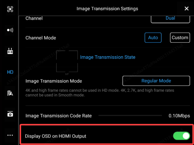

I think there is a setting somewhere in the DJI software - my BT35E with HDMI connection shows an exact duplicate (including telemetry) of the screen, but I think I remember the first time I used it I had to change setting. I'll check it out on my setup soon (I'm away from my drone for a few days)
Reactions: OzoneTech
Yes. you can enable the OSD on HDMI Output.
