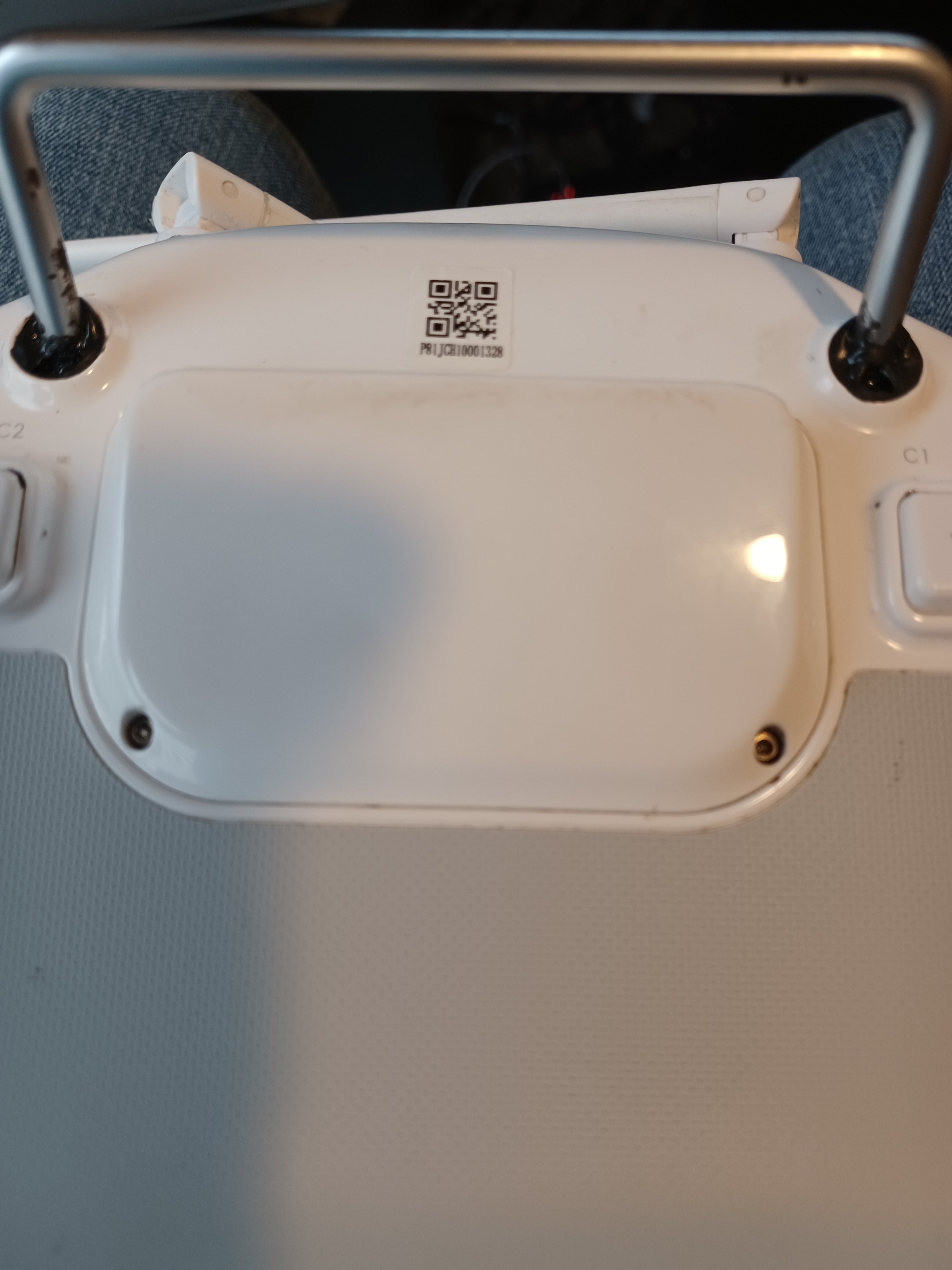

Sorry I have been away from a while. I hope you found the board and got your problem solved. If not it is the USB board inside this panel.
