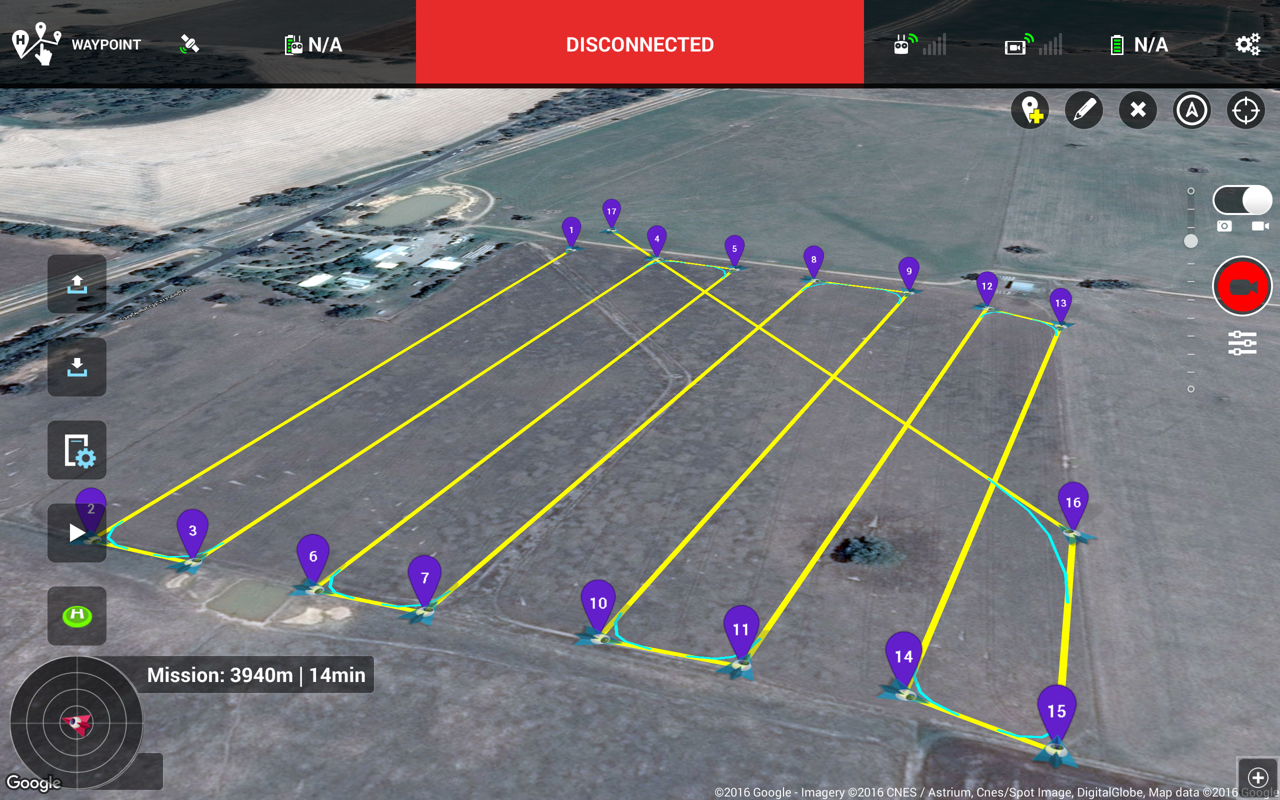

I started off doing an aerial survey and 3D model of a piece of land I own (using Agisoft), which led me to doing missons of around 30 waypoints. This worked well using Go, but when I tried it in Litchi, the app would simply hang without starting the mission. I could do a couple of waypoints but not more. My phone which is midrange performs a little better but also hangs when I add too many way points.

I have plans to use Litchi for crop inspections I was wondering how many runs I could do ie way points. I think I read it was 30. I have a Samsung S tab. I haven't run a mission yet due to a month of rain So I hope it will do what I want .I thought Litchi was initially developed for android devices anyway.
The highest waypoint mission I've flown was 57. I doubt there's a limit. Perhaps 99 since the waypoint icon size might limit it.

I picked up a Xiaomi Mi4 running Kitkat. Turns out my tablet was not good enough to perform waypoints with but works out well normally.

Yesterday I did 120 odd. I am suspecting it will run any number until the battery runs down. Will revert when I try a long run today.
