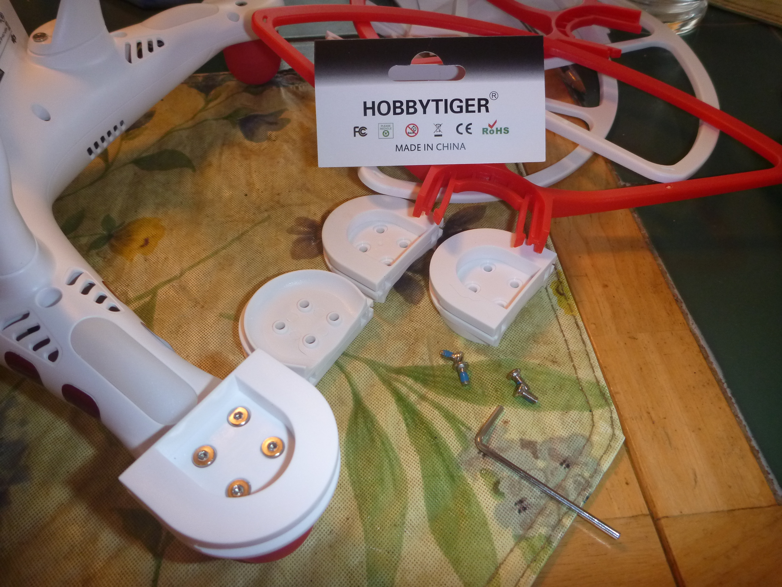

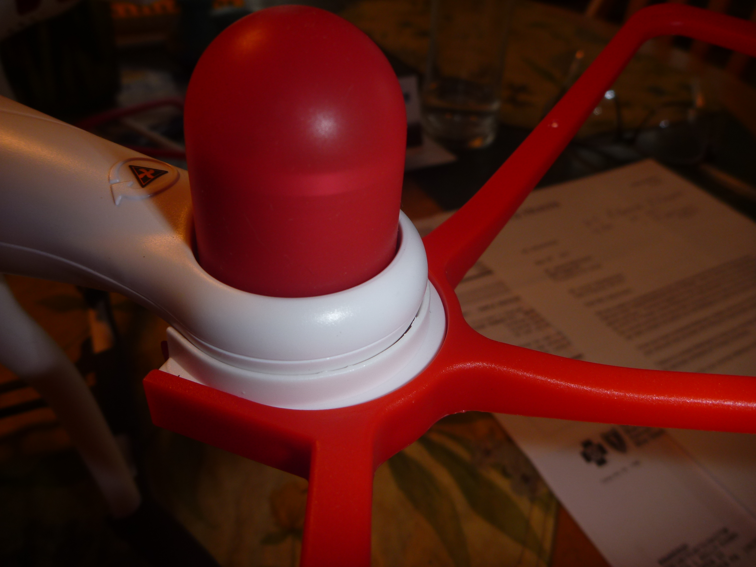

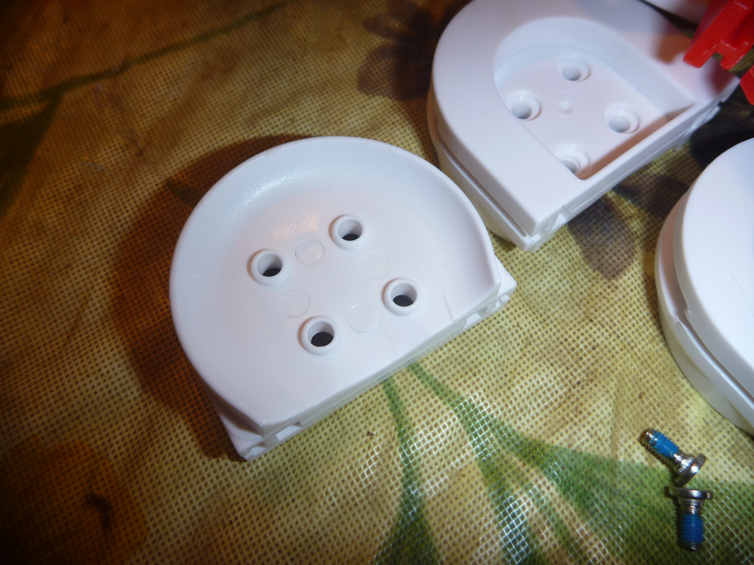

If, as has been suggested, the issue is either too much torque on the screws, or weakness of the plastic, I am hoping that the installation of these thick prop guard mounts combined with hand tightening the screws will prevent shell cracks. My P3S is new with just a little over an hour of flying time and seven flights, and it does not have any of the dreaded stress cracks. The prop guard mounts are contoured to fit the curved shell and hopefully should serve to strengthen the motor mount area and spread the stress load out a bit.

Those will add stress and probably cause the cracking to be worse.
