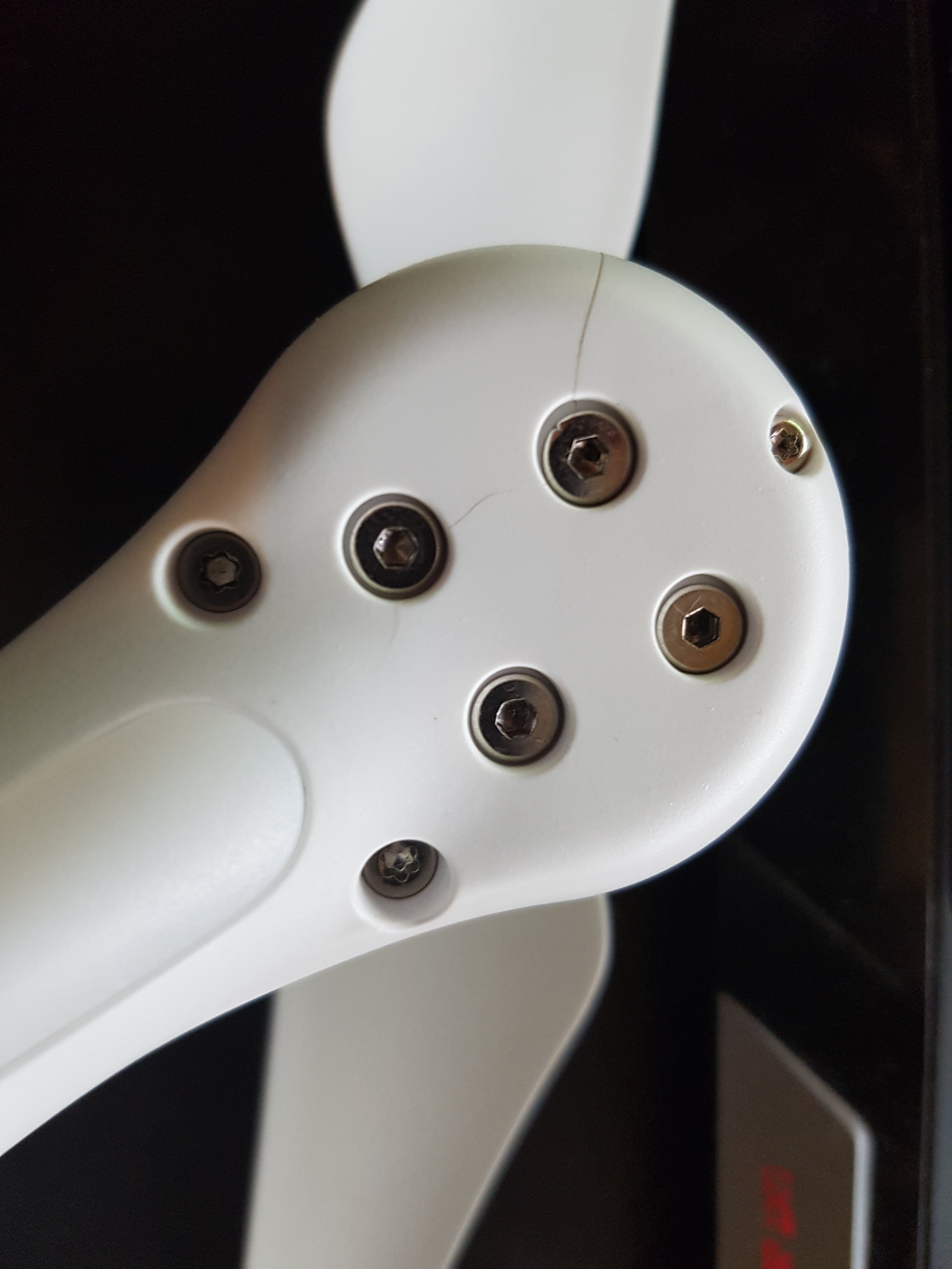

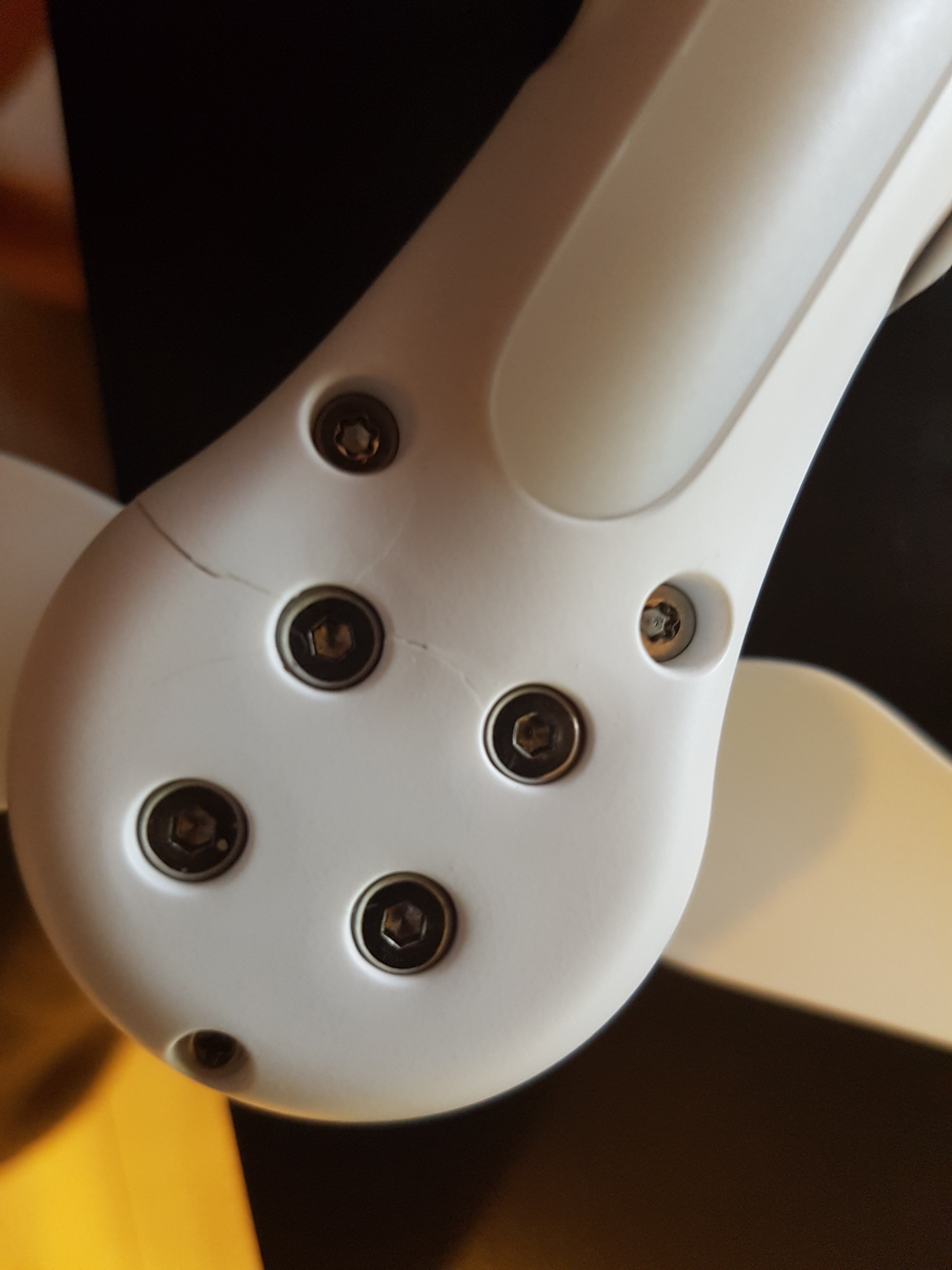

Hello everyone, I am completely new to the phantom world (just got my P3A, used). I was looking to fix the cracks and install the reinforcement plates. From the ongoing threadlocker discussion and the unavailability of Loctite 425 (at least in Europe), I was looking for an alternative. I found Vibra Tite (Vibra-Tite VC-3: The Adjustable & Reusable Threadlocker.). It says it works with plastics, but I am not 100% if it would work with the plastic the phantom shell is made of. Any of you guys maybe know enough about this to give me an idea of whether or not this would work?

Before you even think about installing the so-called "reinforcement" plates, can we see pics of the cracks?
**these are the only cracks, they are on only 2 of the arms. My plan was to open up the shell and reinforce all arms with epoxy first, and then add the reinforcement plates.

Hmmmmm.... as the cracks are across the motor mount from one bolt to another and I presume you don't want to re-shell, this would be a good example where the plates may help to spread the stress loading.

Well, a re-shell is my last resort, as these cracks seem to appear in new shells too. My thinking is to try and fix it now and stop it from spreading, and if that does not work do the re-shell (with reinforcements).

I'm certain its the bolts being over torqued that causes the stress leading to the failure of the plastic. I removed the bolts before I flew the AC for the first time, to install prop guards and I noticed the inconsistency of the tightness of the bolts; some were very difficult to undo. I used Loctite 425 on the longer motor bolts, and tightened them to a much lower level than the originals. I removed the prop guards after one flight outdoors and reinstalled the original bolts, again retightening them to a lower level. I have no sign of cracks anywhere.
