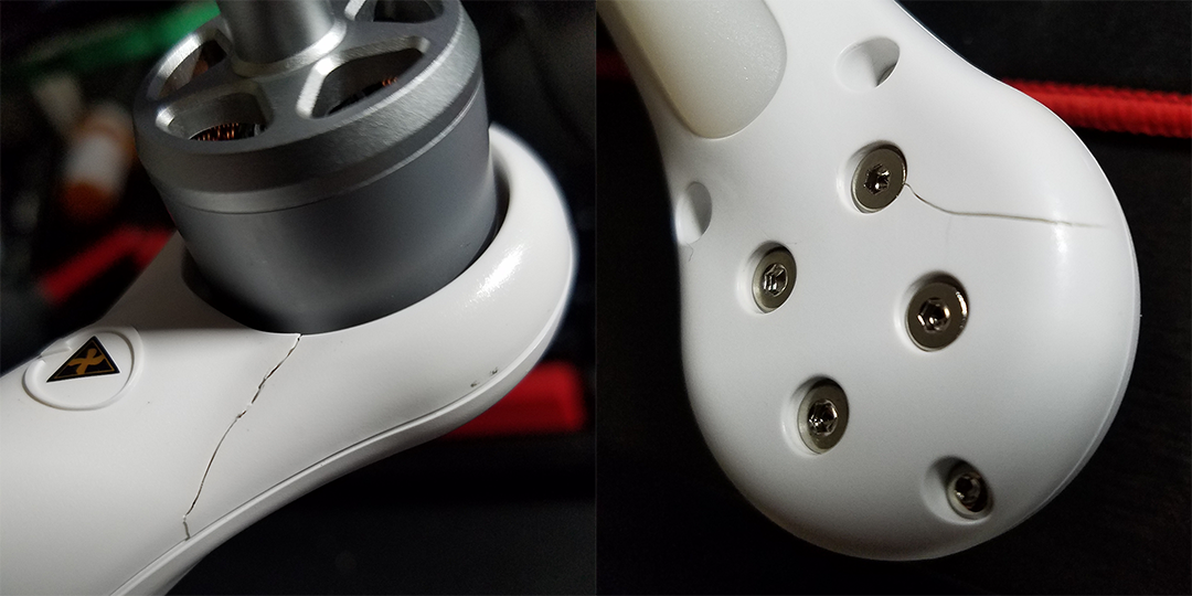

I have less than 10 actual flights on this thing and I was going to fly yesterday so I gave her a looksee and to my surprise here's what I found.
Note: I've never had any crashes or impacts of any kind with this Phantom.
These are the worst of the cracks but there were cracks on each arm. DJI really did us dirty with the P3.
The last flight was my furthest at just over a mile and heading back to the take off position, I hit 30 mph with a tail wind. Before that flight, there were no visable cracks or anything. I flew for about 45 min that day.
The crack in the left photo looks pretty risky but I had cracks like the right photo under similar number of flights. At the time, sending it back to DJI involved months of waiting. I used clear JB Weld (epoxy) and coated the bottoms of each arm underneath the motors making sure I didn't get any in the screw holes or separation line between the upper and lower half. I put two coats on (dry time between them) to give it extra strength. That's was 2 years and probably 60+ flights ago. Haven't had a problem since. No new cracks. Old cracks didn't get bigger. It's kind of old school but if you've flown RCs for a while, it's how we used to keep them flying :). That's said, personally I'd replace the body because of the crack in left photo. Having been thru this, I wish I had strengthened the arms as soon as I bought it (before the cracks). It was a common problem back then but you never think will happen to you. LOL. Good Luck. Happy flying...
Update: Added photos of epoxy fix. The "clear" epoxy has yellowed over the 2 years since the fix :-) but it's done the job. You can see it's a fairly thick coat to strengthen the design flaw area.
