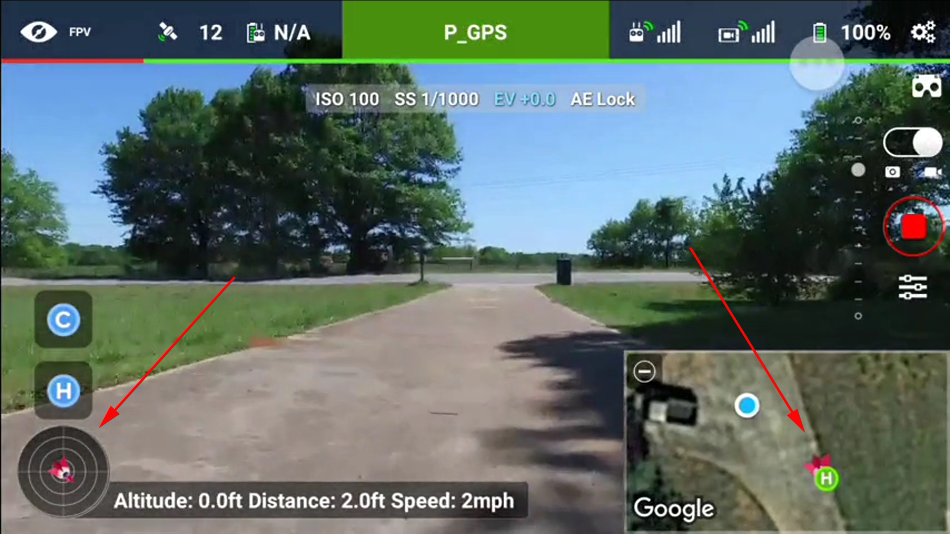

Just a comparison in the discussion. Granted this is a Litchi screen shot but both the map and the radar icons point to the southeast, which in this particular quick flight from quite a while back is spot on as to the direction that the Phantom was facing before takeoff. Just for what it's worth, I always check both before flight.
I'm not familiar with Litchi. Can you expect that both icons will point the same - regardless of tablet orientation? If so, that's different from the Go App.
Tablet orientation I cannot confirm, although while facing the Phantom ( As you should for Antenna Orientation), Yes they should match. This screen shot is a mission return from the WNW to SSE.
