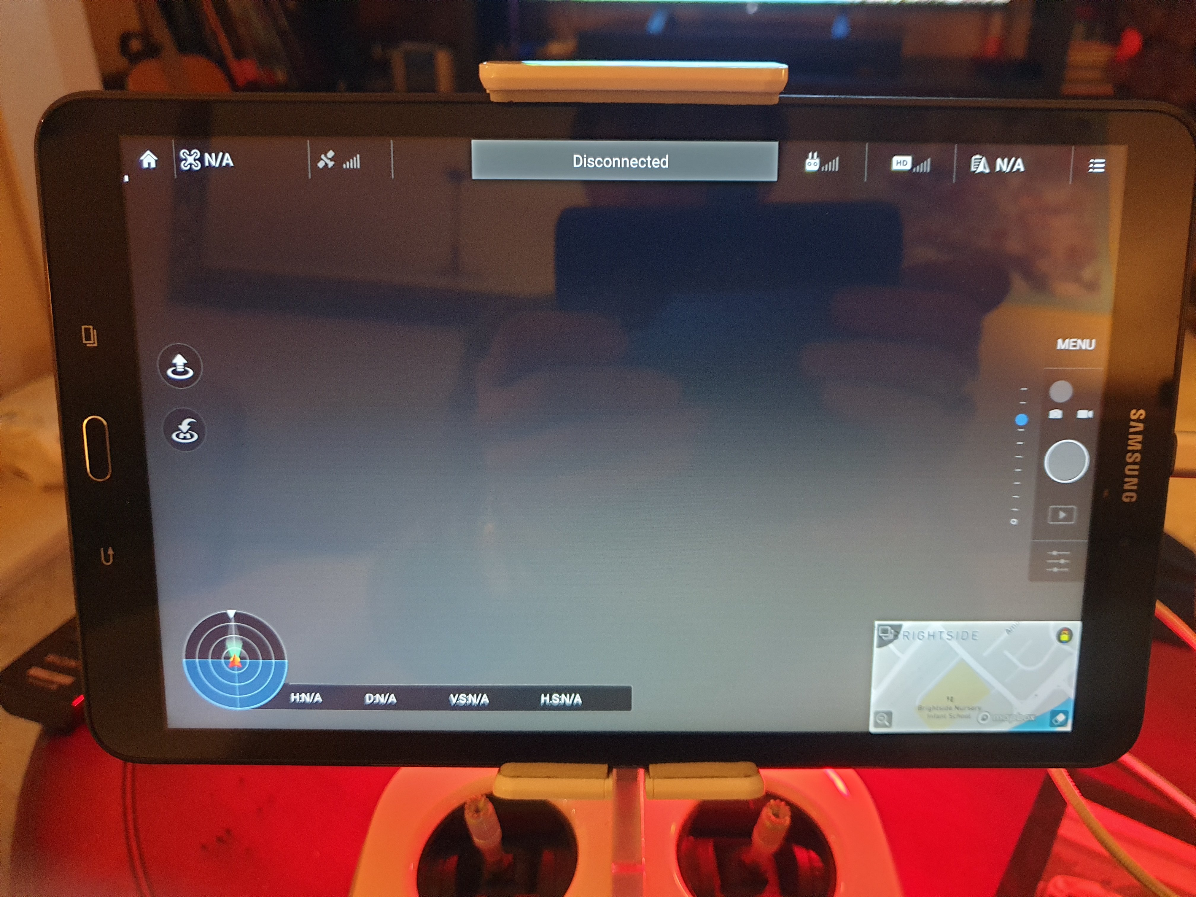

The Batteries charge up ok and seem to hold charge, when I turn the controller and drone on they power up ok and I get a Green light on the controller to indicate it's connected to the drone. I click on the Dji App and a screen comes on, I click on the camera but the screen say's Disconnected, but the motors run when I turn them on. The camera doe's not connect. Also moving the flight switch mode lever doesn't seem to do any thing. This is a pic to show "disconnected" but the motors run.

The screen shot of the app screen leads me to believe that the app itself is not connected to the drone/RC. There are no aircraft battery levels, etc.......so,
Have you checked the USB cable from the R/C to the device you are using? .....or maybe swap the cable out to a new or known working USB cable?
Hi, the camera moves up and down with the control, The cable is a new data cable witch transfers data as well as charge the battery on the tablet. It worked just fine a couple of days ago but it won't work now. The lights on the drone are, Front, steady Red. Rear, Flashing Yellow for a minute then turn to flashing Green. Is this the right pattern ?
I have just had a look on Y/T. and saw this suggestion, so I tried it, and it worked, I now have camera connection. and all seems fine. Hope this helps others.
