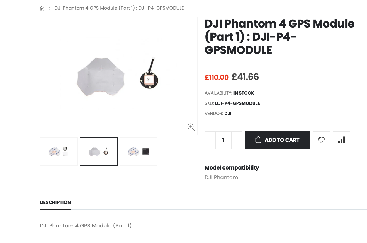

Any idea as to whether this module (for a Phantom 4) would work with the 4 Pro V2? I have a friend coming out from the UK next week so that would could work....

Compare SKU Most pro parts are pro parts. My P4 parts don't fit P4P. I think the bolt pattern is different.(screw pattern)
You're right, I got some more pictures this morning and there are four mounting holes on the P4 module vs. 3 on the P4P. Thanks.
Just make sure what you acquire is not the p4 model. You need one that reads p4pro and or p4pro v2
Thanks, I'll probably order one from the link you sent to me yesterday. I have a friend arriving from the UK on Tuesday so that would have been quicker that's all.
