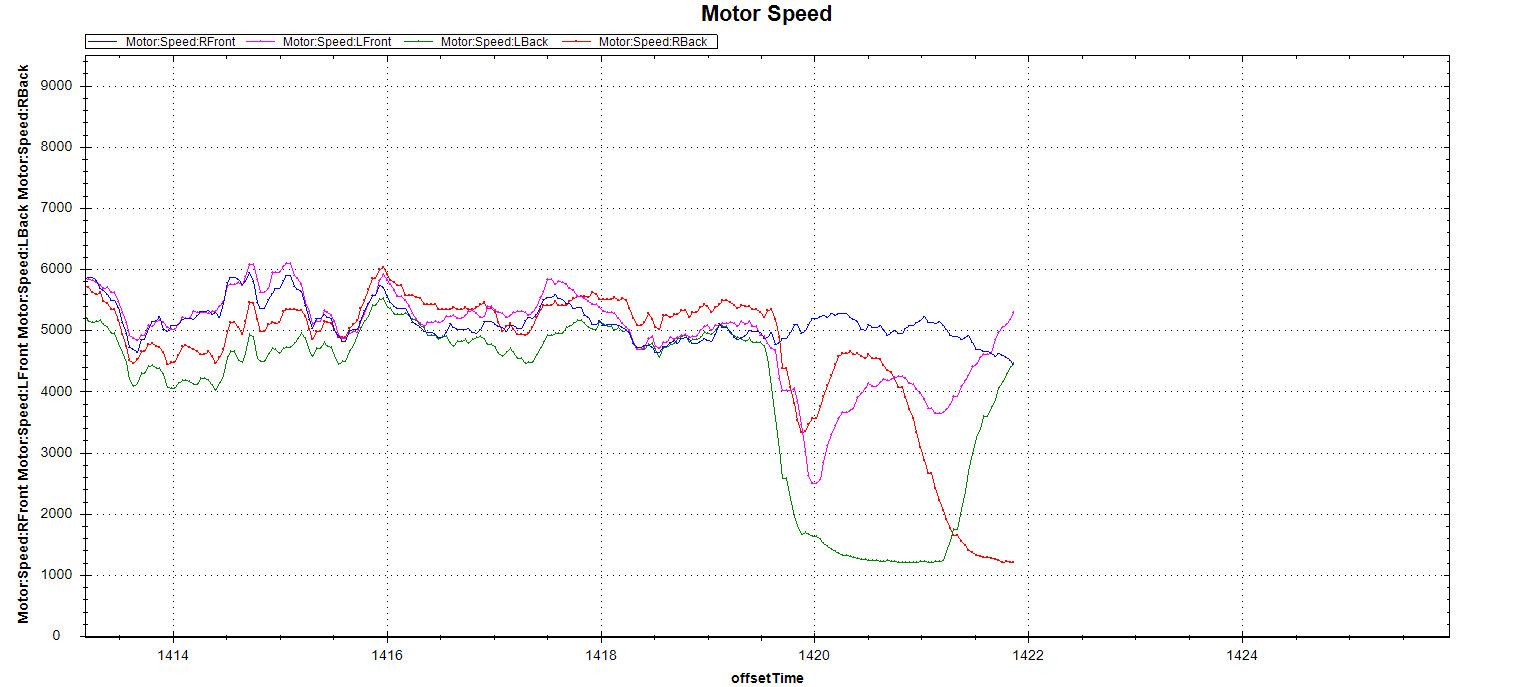

Don't have a lot of time to go in to detail this eve, but others will surely look. This does not look like the typical instantaneous shutdowns that I have seen. Maybe @sar104 may have a few minutes this eve. I may be back in a bit. But here is an initial look at the motors at the end of the data.
