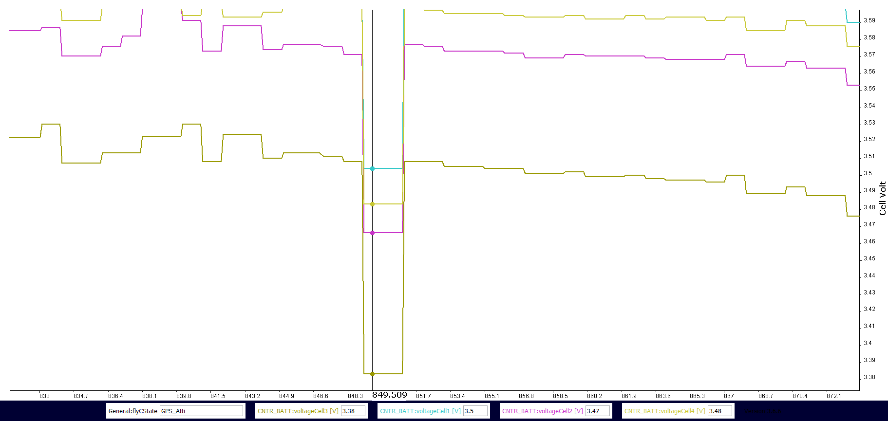

My layman's guess is that battery cell #3 died, and rapidly. It was looking 'iffy' for a lot of the previous flight and yet you say you received no warnings at all, which is strange. Taking off again was just enough to finish it off.

There in lies the problem. Taking off with the battery level that low is a big no no. As was mentioned above, it appears that cell #3 was out of balance and very near the cut off level as shown below for a short period in this flight. Presumably by the time you reached altitude in the incident, that cell dropped below 3 volts which will shut the battery down. The battery needs to be recharged to re-balance the cells in order to reduce that possibility. Bringing the aircraft down at 17% is not an issue IF you began the flight with a fully charged and balanced battery.
