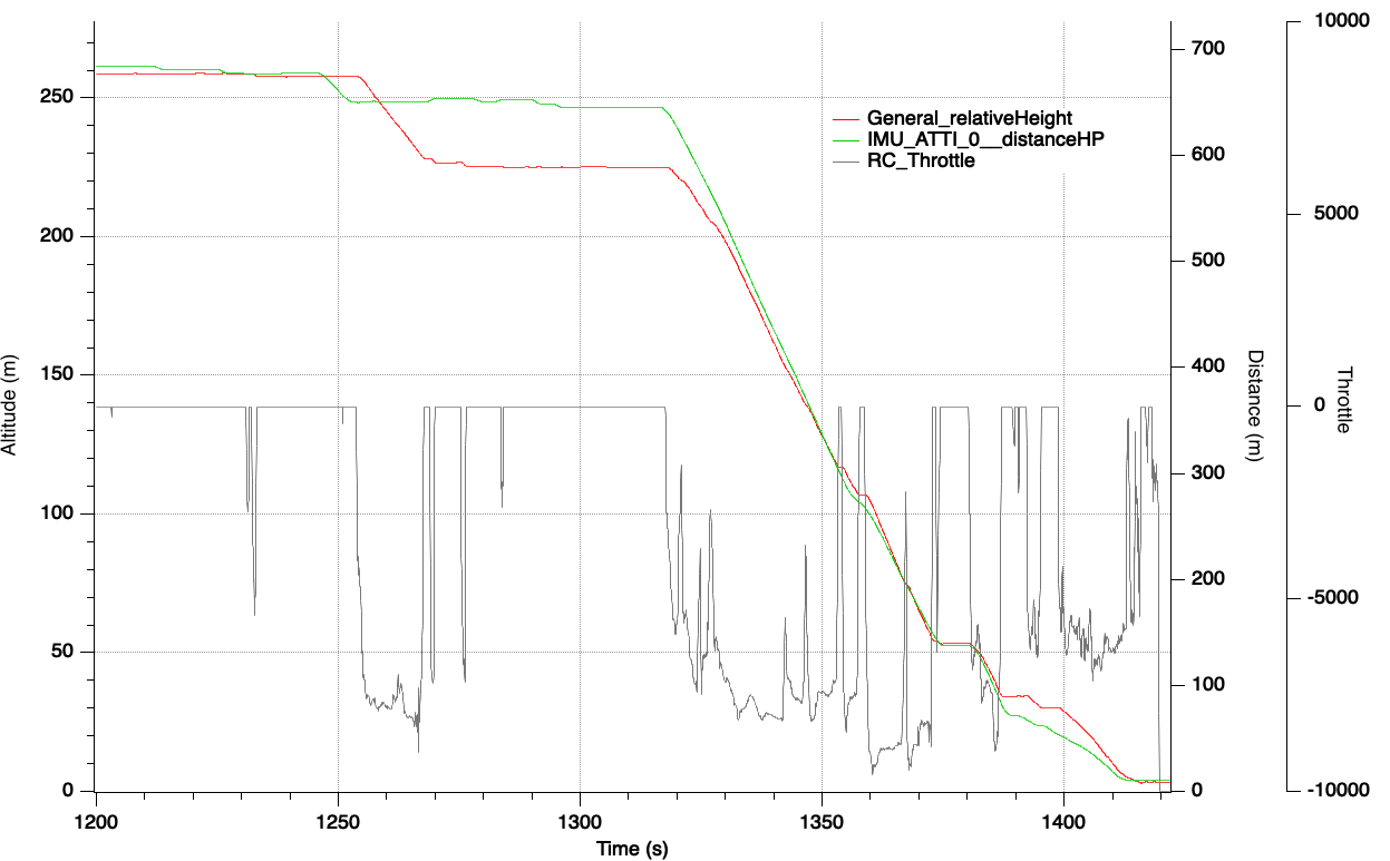

Are you sure that's the correct flight log? This one ends with the aircraft 3.2 m above and 10 m away from the home point, after a controlled, commanded descent from 260 m:

@RogerVer The above is correct. This is not the correct flight from your description.
You are right! This is the wrong log file, but its the last one on the card. I read somewhere that the last file could sometimes be mislabeled if the controller isnt on when the aircraft is powered on.
Where could i find the right DAT file? there isnt one from the day of the flight, and the one above is the last one.

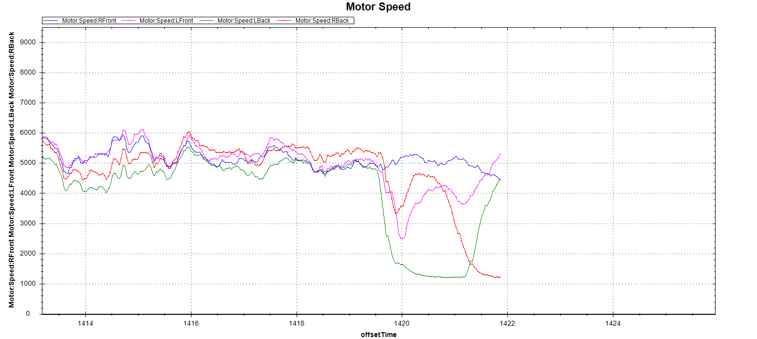

It is very possible, "since it just happened to me", if you had a wind gust that allowed the drone to descend , once it starts descending fast enough, the drone starts falling through it's own column of air and the blades stall because the air stops going over the blades to create lift. The more power you give, the faster it drops. This happens with copters (which I should have remembered). Anyway, the only way to stop this is give forward stick and "get out" on the column of air.
Hope this helps,
