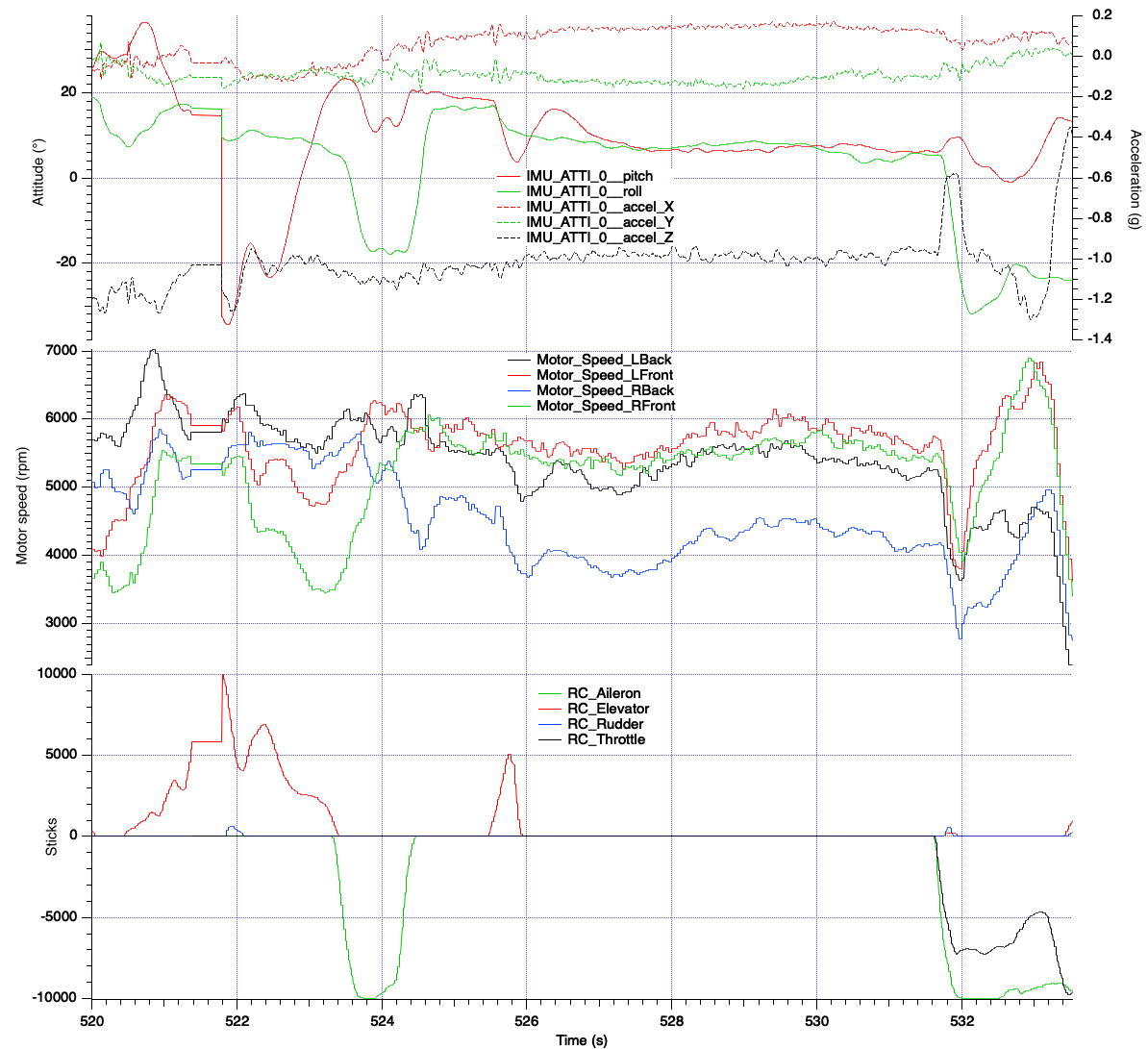

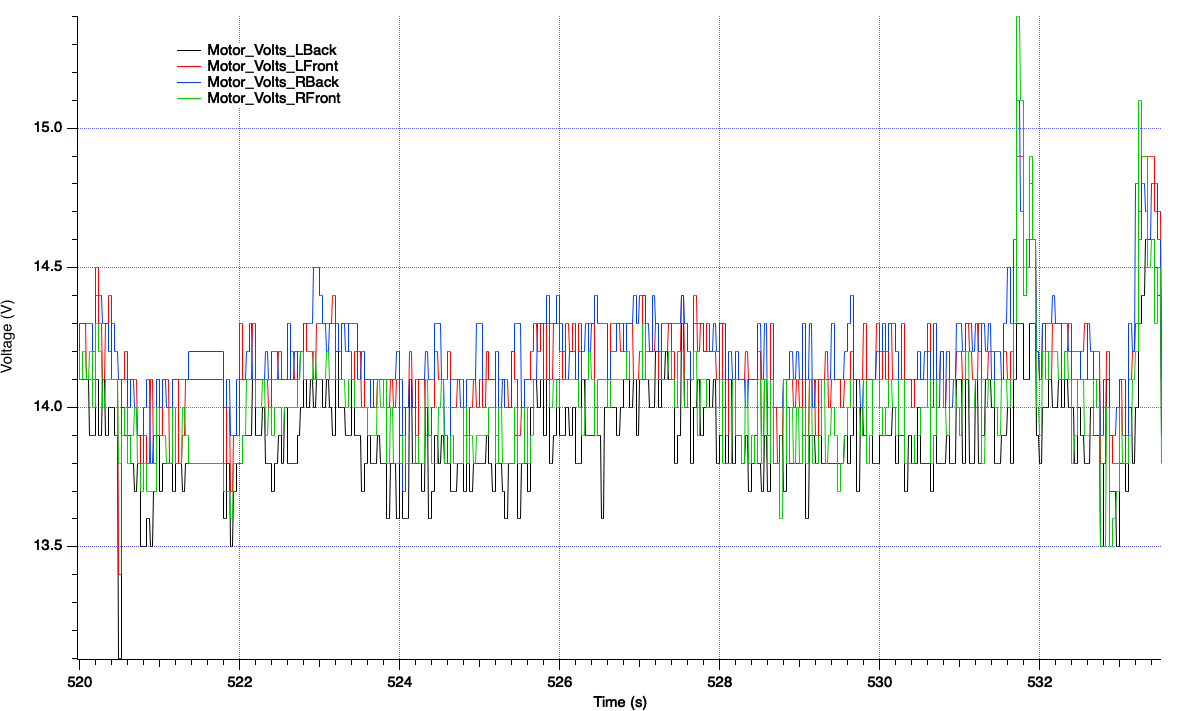

At the end of that flight the aircraft was dropping fast (~ 0.5 g) in response to minimum throttle, and pitched backwards. If the throttle were centered suddenly in that orientation it would have put a significant disconnection force on the battery.
Unfortunately the motor voltage record doesn't show the usual voltage collapse that we generally see with battery disconnects, so it's not a particularly convincing explanation. I don't see anything in the event stream that looks suggestive of a problem either.

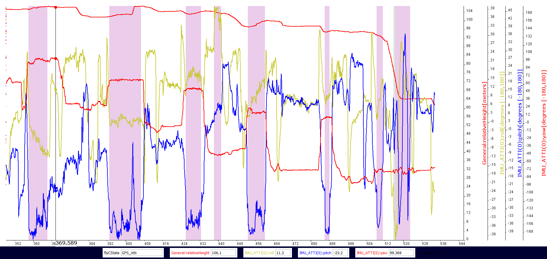

Here's what the flight data looks like:
It shows Yaw Errors from early on and right through the flight.
That's probably due to launching from a magnetically compromised area.
Launching from reinforced concrete is one of the most common causes.
Or the launch spot was very close to some steel object.
As a result the drone would have been difficult to control.

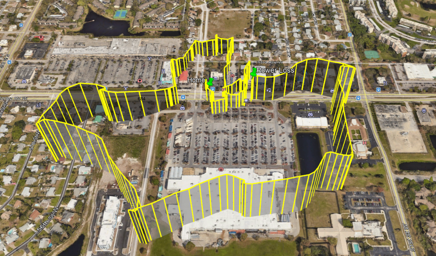

It commenced autolanding soon after 4:46.8 when it was 1200 feet away and 250 feet up in the air.
Being in atti mode, it continued drifting on the breeze as it autolanded.
Last recorded location before losing signal put the Phantom 1742 ft from home and still 111 feet up while it drifted further NE at 0-3 mph.
A rough calculation would put the drone approx 50 feet further to the NE from the last recorded position.
It may have landed on the road or parking area, in which case it's gone or perhaps it's stuck in trees approx 50 feet NE of here:

The .DAT and .txt you submitted were only 308 secs. If the flight really lasted 21 minutes then there should be subsequent log files. Is there a FLY383.DAT? And, another .txt after DJIFlightRecord_2019-09-22_[11-33-28].txt?

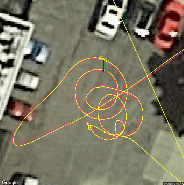

This appears to be not your usual launch from a concrete spot with embedded rebar. There certainly was some toilet bowling at launch.
But, it didn't start until the P4 reached about 4 meters (red trace). The Yaw/magYaw separation (blue trace) would then oscillate with peaks corresponding to the northern most parts of the toilet bowling.
I'm going to guess that it was the parking structure to the west of the launch point that caused the Yaw/magYaw separation.
Which direction was the P4 facing at launch. The data shows it facing south.
