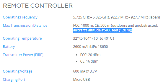

whether we take notice that DJI put 120m alt on their site?
This p3-4k is my first drone and I'm a little bit afraid to take it too high. Max altitude i have flew was 120 meters but the distance was only like 50 meters(panorama shooting). I'm afraid if I fly too high and wind is getting too fast(flyaway).
I have set the RTH altitude to 50 meters, but if I fly in 120 meters and RTH kicks in will it descent to 50 meters and return to home or return to home in 120 meters???

i think the 120m are the presets. on a new Phantom always are 120m altitude set as max. but you can always change that, dont think that there is a new limitation at 120m altitude.

Maybe You right, I was thinking the altitude of 120m is the best to get the farthest distance, probably people who knows about the propagation of signals could provide an explanation.

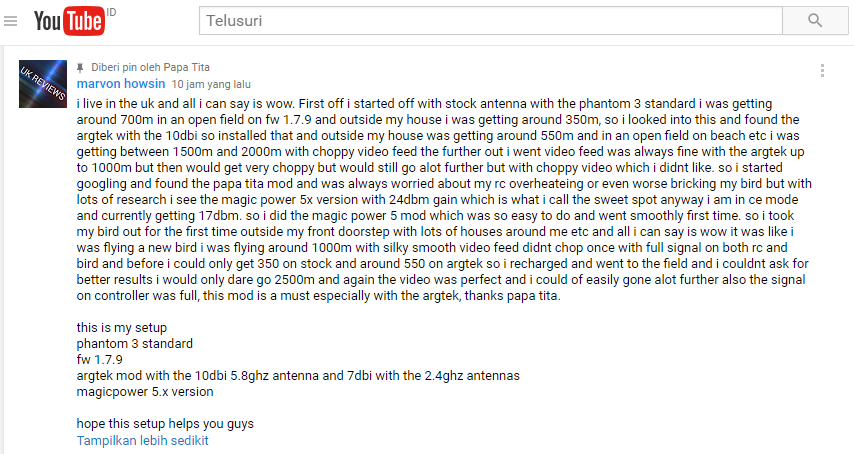

There is a review for argtek users:
That notation on their site is simply telling you that those ranges were conducted at that altitude.
