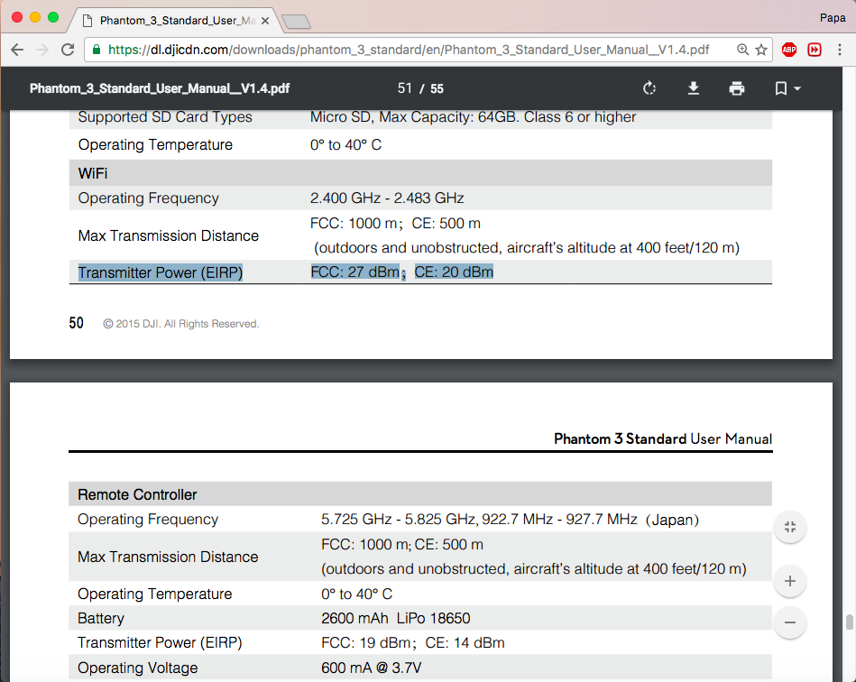

This is manual too (which one is correct?):
I agree PapaTita. Confusing.
I took the screen shot from their webpage.
Your (PapaTitas) screenshot seems to indicate different transmit power from the drone and the RC.
Drone FCC: 27 dBm
Drone CE: 20 dBm
RC FCC: 19 dBm
RC CE: 14 dBm
Very confusing compared to the Specs page DJI website.
Indeed dji-go after homepoint drop to 17 dbm but the script do the loop every 10s to raise to 27 dbm.
Can you try again to check with iwinfo every 10s?
