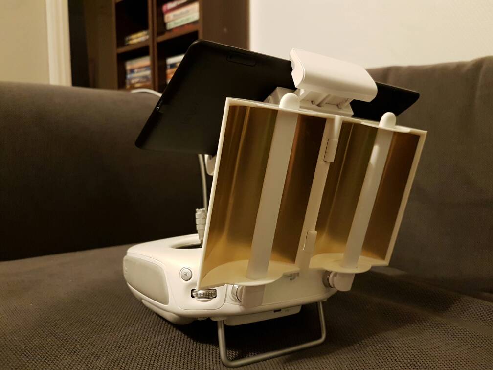

Make windsurfer, you can download pattern from papas google drive , if need more add 2w booster

Yes I have a windsurfer. But this has not helped much.

Something like this one 2W 5.8GHz WLAN 2-Way Power Amplifier / Wi-Fi Router AP - Silver+Black. First you can start increase range with high gain antannas - argtek and install panel or helical antenna instead center omnidirectional

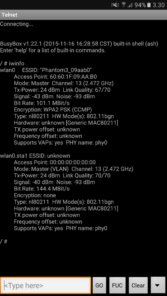

I checked the stock tx-powers with telnet and just 14dbm?
I installed latest mod(5.3?) with "auto" settings(24dbm) and BO region. Then changed wifi channel to 13 with telnet. I bought windsurfers also.
I'm getting around 400 meters now before the video starts lag and connection disconnects.
I'm living in "semi urban" area and tought I could get more than 400 meters with mod and windsurfers?
How can I make it go futher without these dbs/argtek antennas?? Should I run the mod again with FCC(usa) region and set wifi channel to 11 and tx- power to 27dbm?? I have only windsurfers so no need to limit rc power to 20dbm?

I would try setting the power to 27dbm and fly again. Look what changed. If not satisfied change channels and try again. You need to test a little and see what works best for you.
