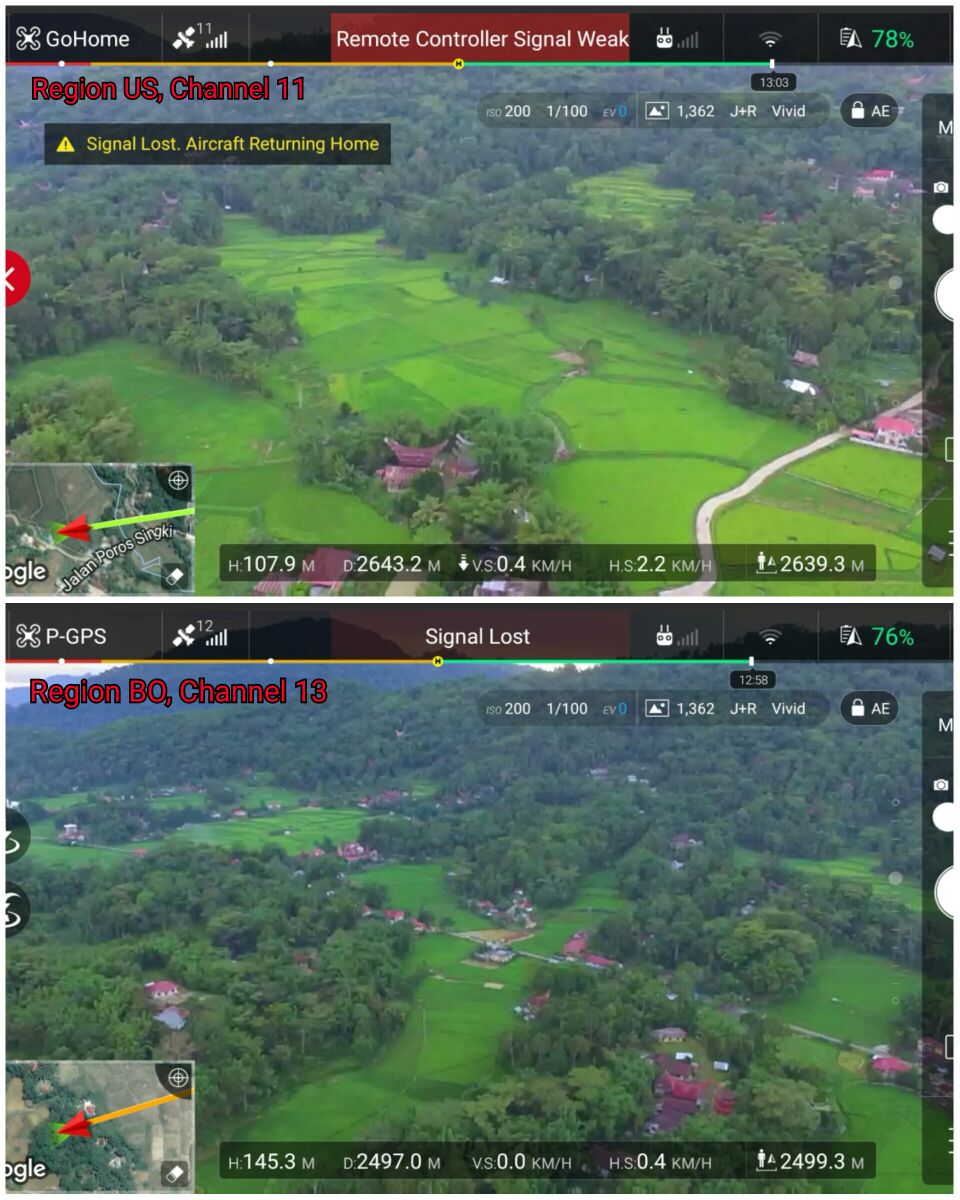

The regional comparison of US and BO, not much difference in distance, but in US region is more good in quality transmission of images.
P3S FW 1.7.9 with stock antenna + Windsurfer + Magic v5.3. Same day, same location. (Beauty of Toraja)
As just 200 distance difference, I don't feel that there is improvement in the flying distance between BO and US.
