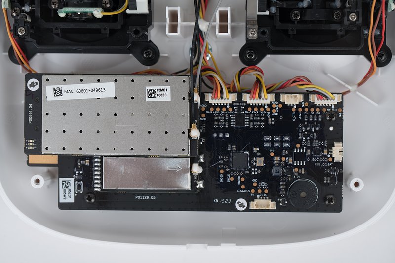

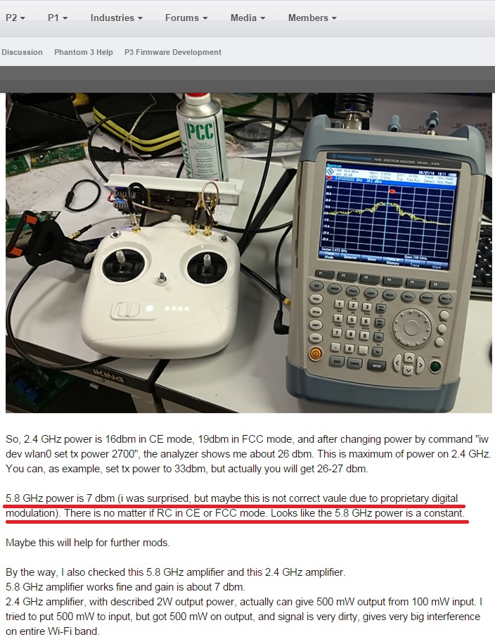

I still have range problems , less than 300-400m, even I have applied Papa Tita and antenna change..The Telnet , says that all OK, 24 dBm.
With a small RF detector , to investigate and solve my range problem. , I can see.
1) that in one of the 2.4Ghz the RF detector detects more than 21 dBm.(due to Magic Power ) that is fine.(that is the 2.4Ghz cable much closer to the top antenna.-grey coaxial). The 21 dBm's just can be measured when the RC and the AC are paired, showing a greed LED in the RC.
2-) To the other 2.4 Ghz , the RF detector just detect 1.4 dBm, (moving from 1 to 3) , that is the second RF coaxial connector , black coaxial)
3-) The 5.8Ghz detects between 12 and 13 dBms .
Is it normal ,the point (2) , that one of the two 2.4Ghz delivers very low power ? Maybe that link is the link to the mobile device that it is very close, and that is normal ? Or do I have a real problem in my RC , that needs to be repaired ?

... As your test with RF detector, one of 2.4g is sending signal and the other 2.4g is receiving. !??. I don't sure that at P3S. But, P3A, P3P and the others controller have two 2.4Ghz antenna(one is sending, the other is receiving)
The 5.8Ghz is more attenuated as long distance than 2.4Ghz. It is more good choice to add 5.8ghz power up module than change the antenna mod.
Hi Sunkyu, I did not know about it . Thanks for that information .
That makes sense. Because , In fact in that 2.4Ghz, (as you said , supposed to be just receiving antenna), that measured something between 1 to 3 dBm's , when I was touching the external coaxial pigtail ground of the measurement it dropped to almost 0 dBm. And depending on the free dressing , jumped to 3, very unstable. ... So it seems that in fact it should be just coupled RF noise that comes from the other 21 dBm 2.4Ghz transmitting antenna.
I woundered if it was a bidirectional just low bit rate telemetry link with very small transmitting time, but it should be , just 2.4Ghz reception antenna.
Now is clear ! thanks .
