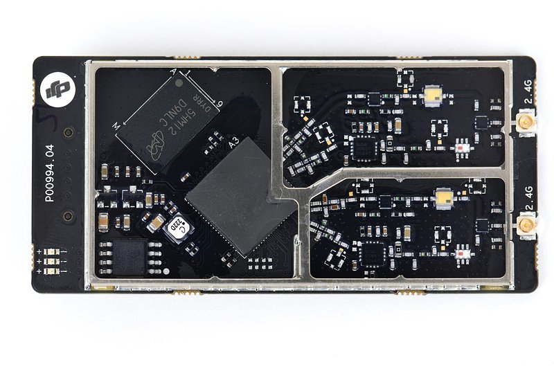

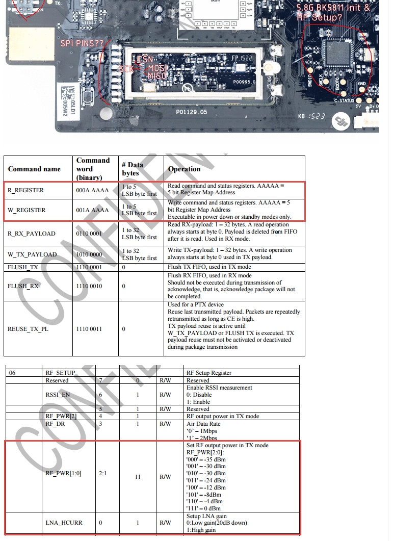

As you know it, "iw reg set US or BO" is wireless region configuration. It is sure that it affect WIFI (2.4g and 5.8g) configurations. But, 5.8g RC signal is not WIFI. Just it use 5.8g band frequency with the other protocol and other module. So, I don't sure that "iw reg set US" affect the RC 5.8 signal also.

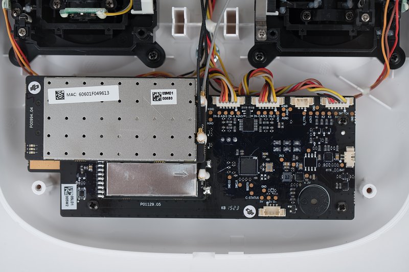

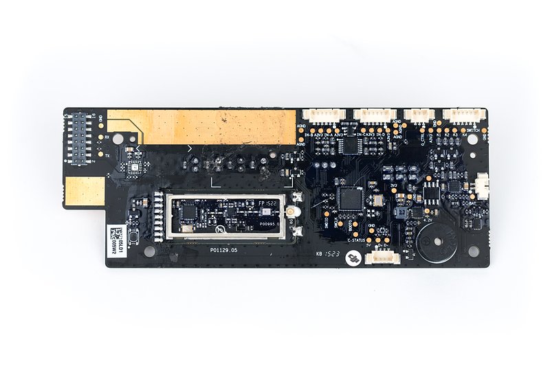

And here the Wi-Fi 2,4 GHz module and 5.4 Ghz? This is quite different modules, which are independent from each other. Wi-fi 2.4 Ghz module panel is responsible for receiving video from a drone on the panel. A 5.4 Ghz is management. You posted the circuit board, so it does not RC Phantom 3 Standart. It's from something else control. You understand that in different countries, its frequency open, where you can pass anything? In Europe alone, more in America, Japan third. I will write logs to the drone, which it knows the frequency and on what works, when you change the region, and you persistently repeat again that it is not affected. Even the points ranges painted with channel width.If you're in not sure, it's your right. But the logs from the RC completely different, which I have already laid out. If you believe only your feelings do not want to accept the facts, it is your right that no one can take, but do not mislead people
It is RC inside of P3 Standard. Good luck!!!

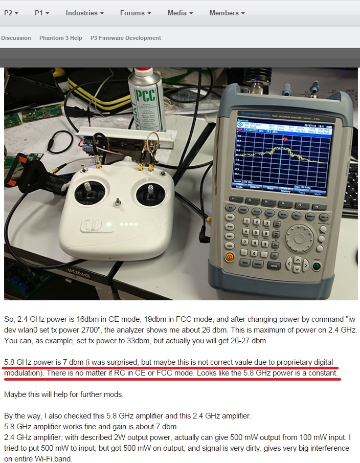

You generally are understood what I mean? No? I tell you that in different regions have different frequency band to 5.8, we for some reason I write about power? With that power here? Yes, the picture one who did it right, power 5.8 is not changed by changing the region! But the bandwidth and when the channel is wider to transmit the signal is good. Do you understand or not? You kind of education? Why are you in a transmitter power vault, and on what frequencies and bandwidth for you as I understand it does not matter ? I'm talking about a wall. At the bottom of the picture that the frequency analyzer, it only measures the signal strength, but not a word about the width of the channel frequency. He writes a 5.8 GHZ, super. And more? He did not measure the channel at the US became wider. Power at 5.8 Ghz, does not change. The transmitter will not allow it, it needs to be changed. What I did late
If you think so, do change reg set US. That's all. I also use my own scripts on RC and AC. I also fly my P3S 3~4km long.
