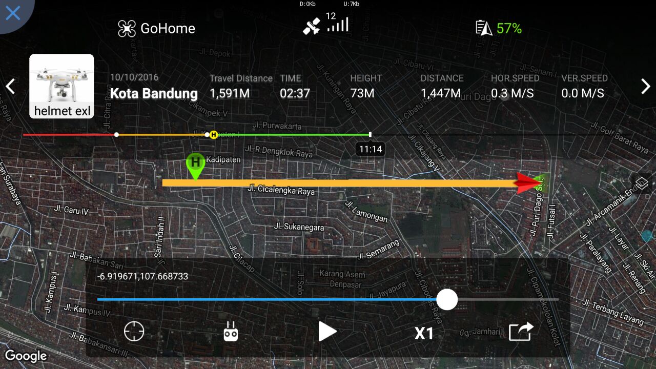

just tested 24dBm to RC only, yesterday downloaded that and now installet to RC, I GOT 3X FLIGHTDISTANCE vs CE default. YEAH.
P3 4k with latest firmware.
